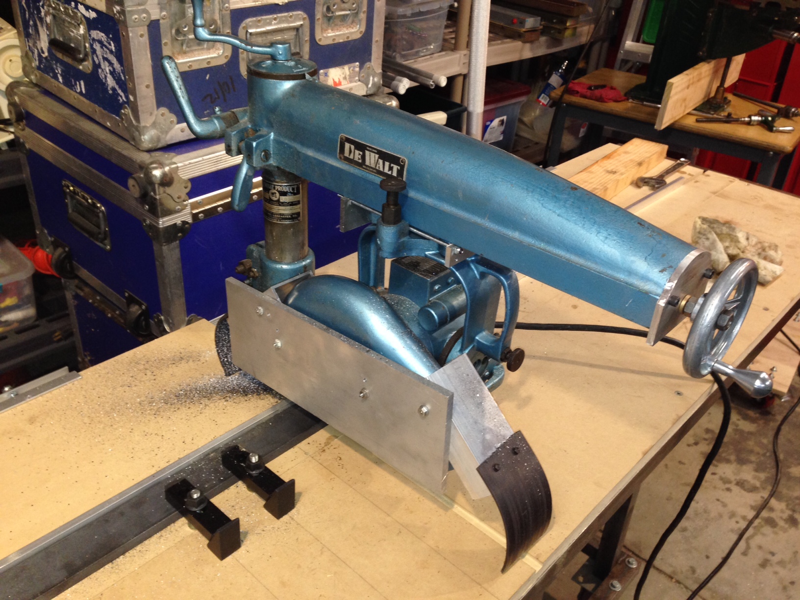

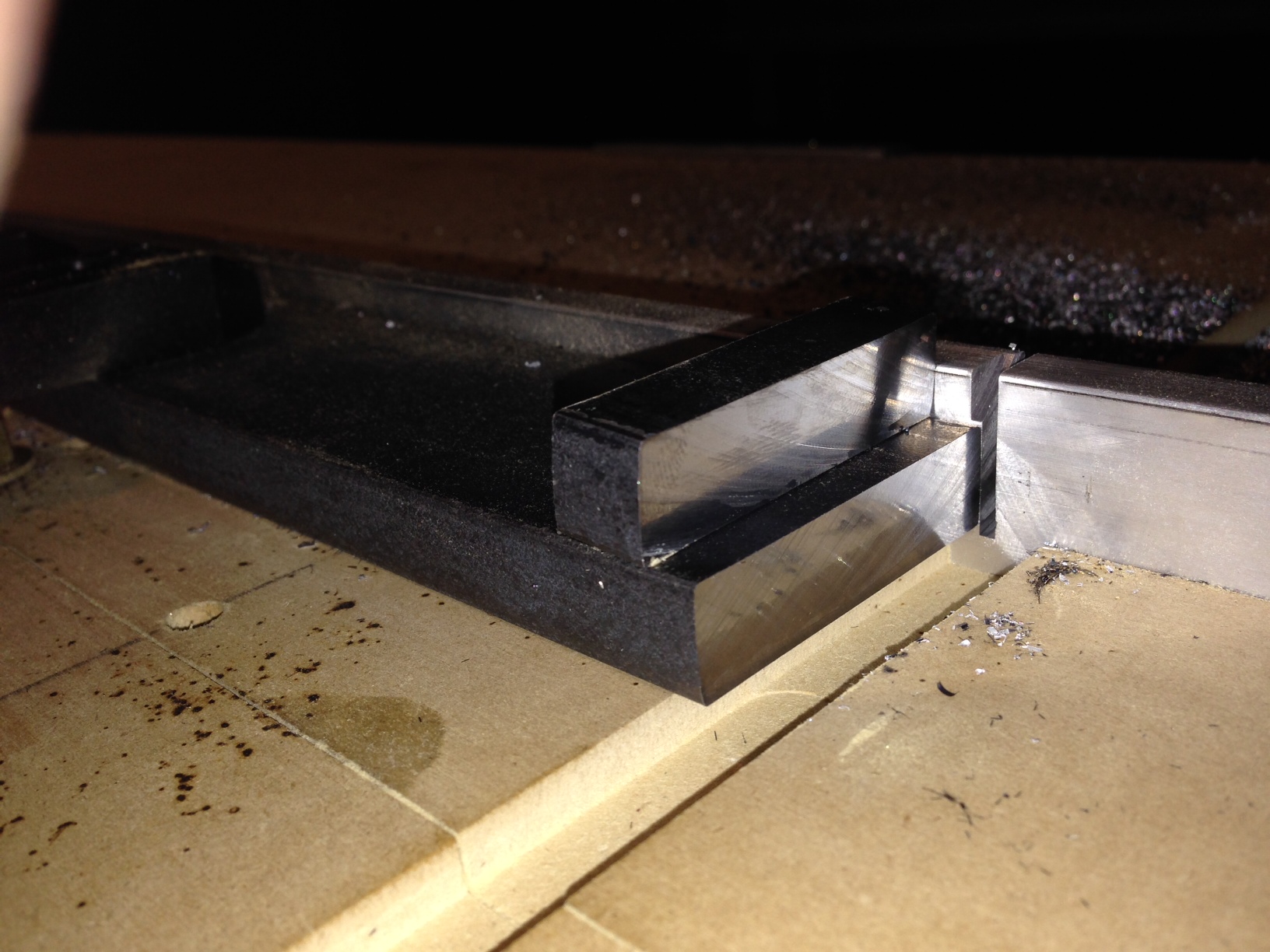

Last update on saw - I think it is done now. I've taken up all ideas and suggestions. I was thinking of rubber flaps, and JJ suggested a magnet. Combined the two ideas in a flexible rubber magnet material sold by McMaster Carr. See picture. It works great to capture and also control chips. Also routed a slot for the blade to travel in. Interestingly it results in virtually all chips being ejected forward, the picture shows the chip pattern. Upgraded to an 8 inch Milwaukee metal cutting blade, it is quieter and smoother than the Makita 5 3/8 inch blade. Also upgraded the hold downs to use 3/8 inch studs. And contoured the ^%$# thrust plate so I don't cut myself every time I reach for the hand wheel. Thanks to all for suggestions, it is a much better tool now. The cut is good. In the camera flash you can see a pattern but it is completely smooth to the touch, similar to a milling machine pattern.
And I have a lifetime supply of magnetic rubber, it is sold in 5 ft rolls, if anyone wants some just say the word!
