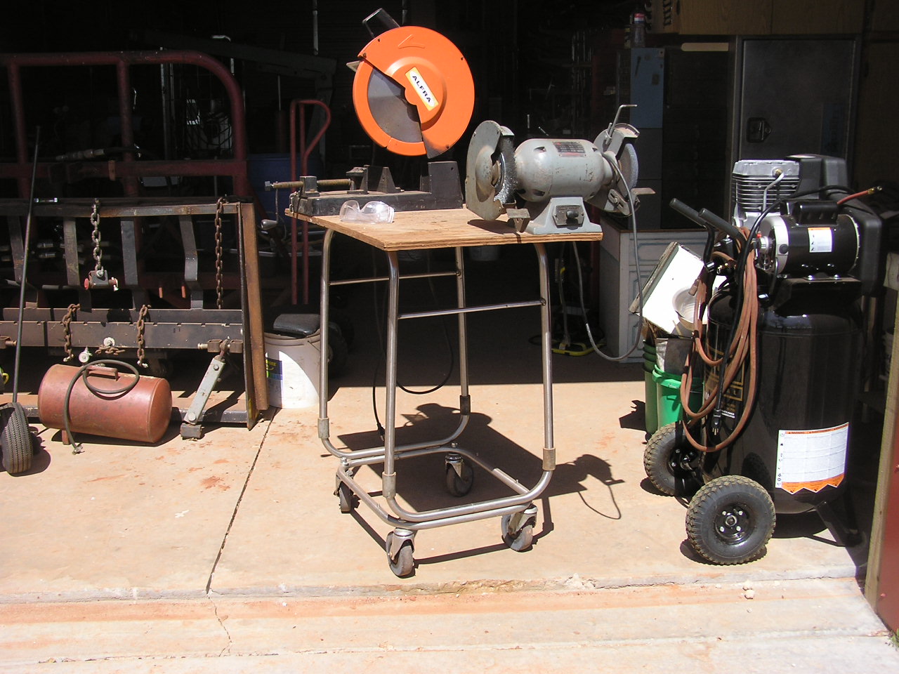

That is the way my metal cutting saw is made. It has a chip drawer under the slot. You pull it out from the back to dump the metal chips.
