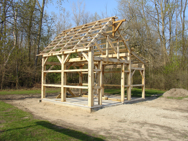

shvl73 said:
Interestingly enough, I found this:http://www.idealroofing.com/PDF/AMC_UL_ENGLISH.pdf
Which clearly shows fastening through the flat for a UL rating. All of their old literature showed fastening through the rib. Maybe they are joining the other manufacturers in the proper method. :)
shvl73:
After you pointed it out now I do see what you mean as far as being able to hold the panels to the roof. I chose to do 2x4 purlins 16" OC so I won't have to worry about being able to support the roof. With a twelve pitch roof I don't think I will have to worry about leaks through the screws if this should be a concern over time with fastening on the flats of the panels.
Thanks,
Kevin

khd said:
shvl73:
Thanks,
Kevin
That looks like a very sturdy, well constructed building!:)
   / Metal roof installation advice #53
khd,
Your tractor barn will be far nicer than my house! Looks great!
   / Metal roof installation advice #54
We used metal from Paramont Metal for our 40 x 48 horse barn. The manufacture had installation drawings for fastening the panels. I followed them. It was screws thru the flats & nails thru the ribs. We used screws w/rubber gaskets & put them thru the flats. The caution not to overtighten the fasteners was noted by the manufacturer. We tried not to but I'm sure some are "flatter" than they should be... I looked @ many barns in our area before building ours. All that used screws were thru the flats & nails thru the ribs. To do otherwise might be a regional or manufacturer difference. It'd probably be best to see what the installaion instructions are for your materials.
