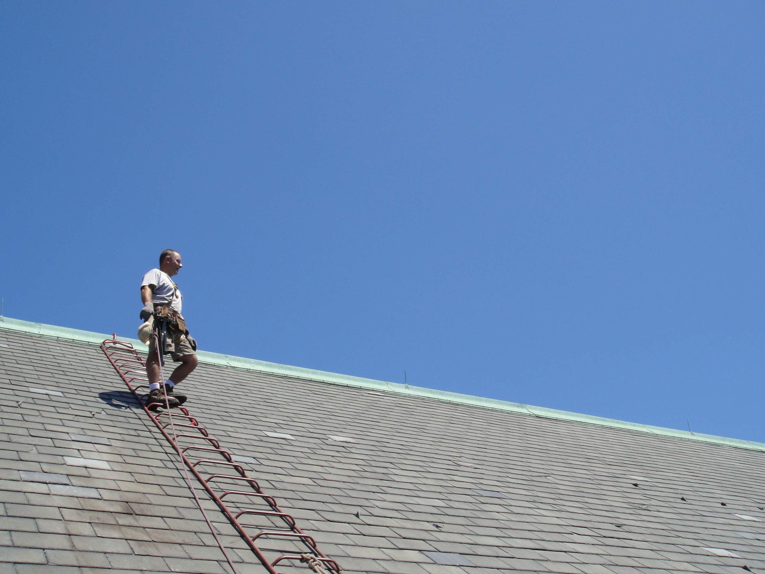

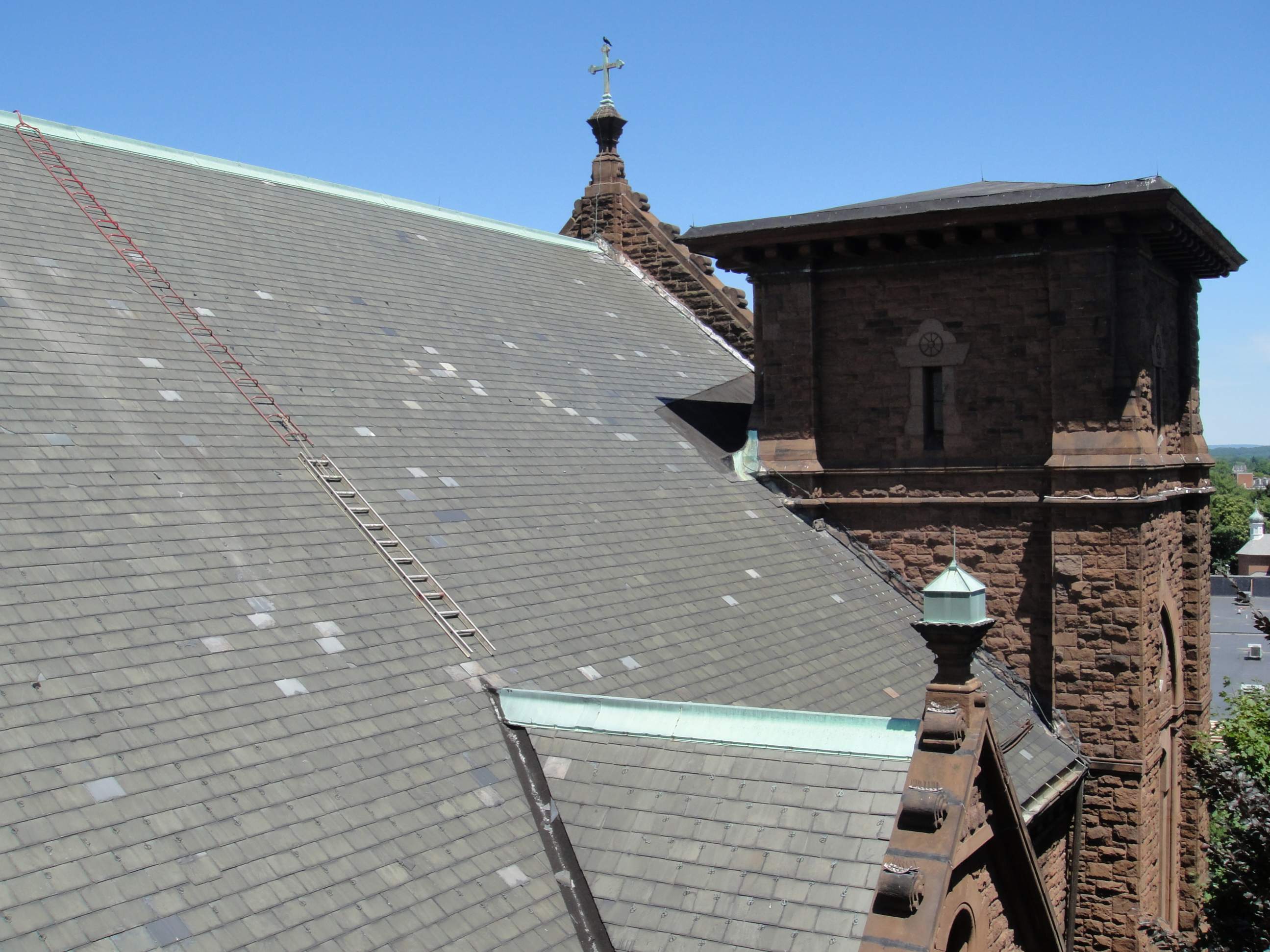

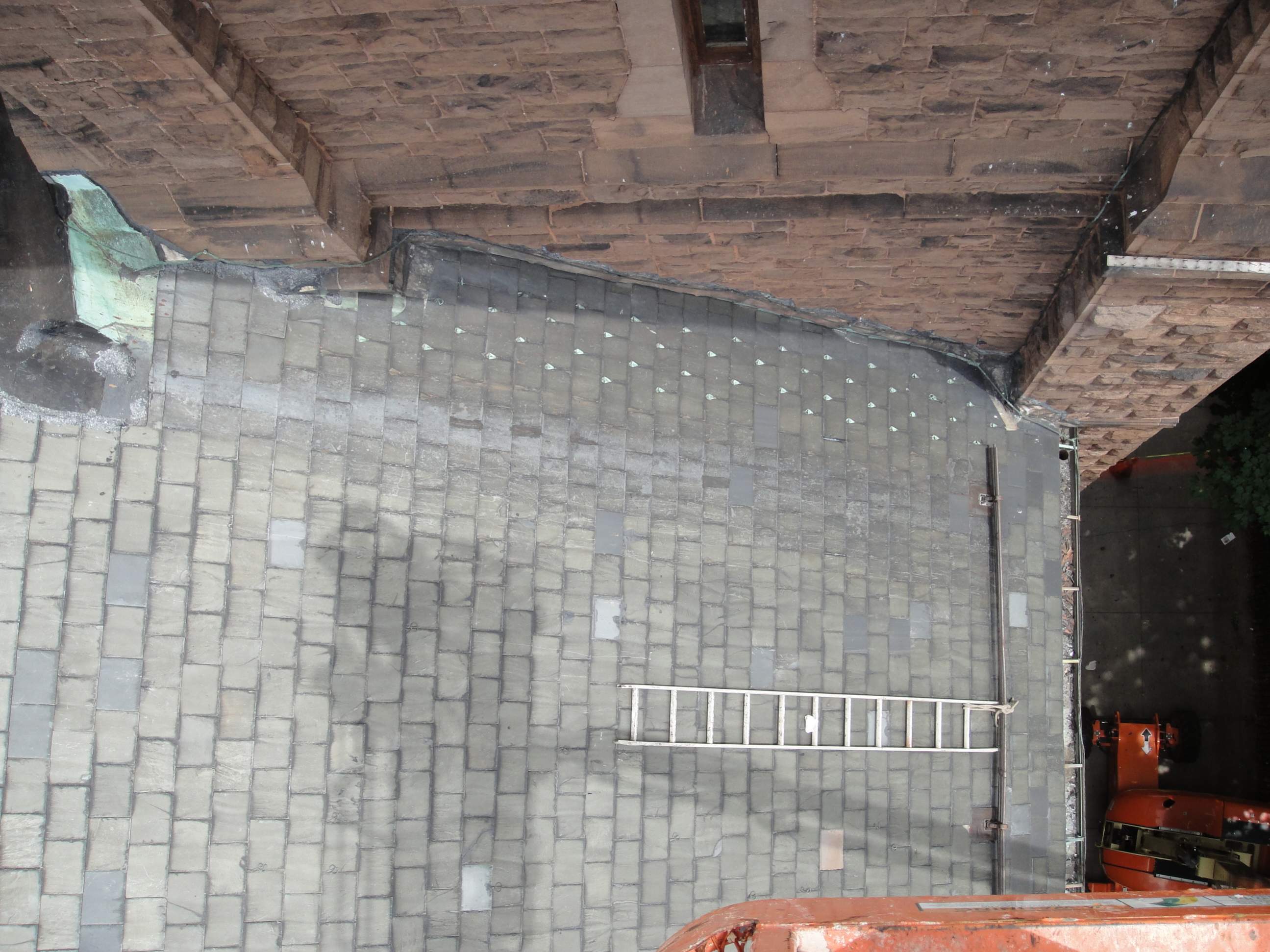

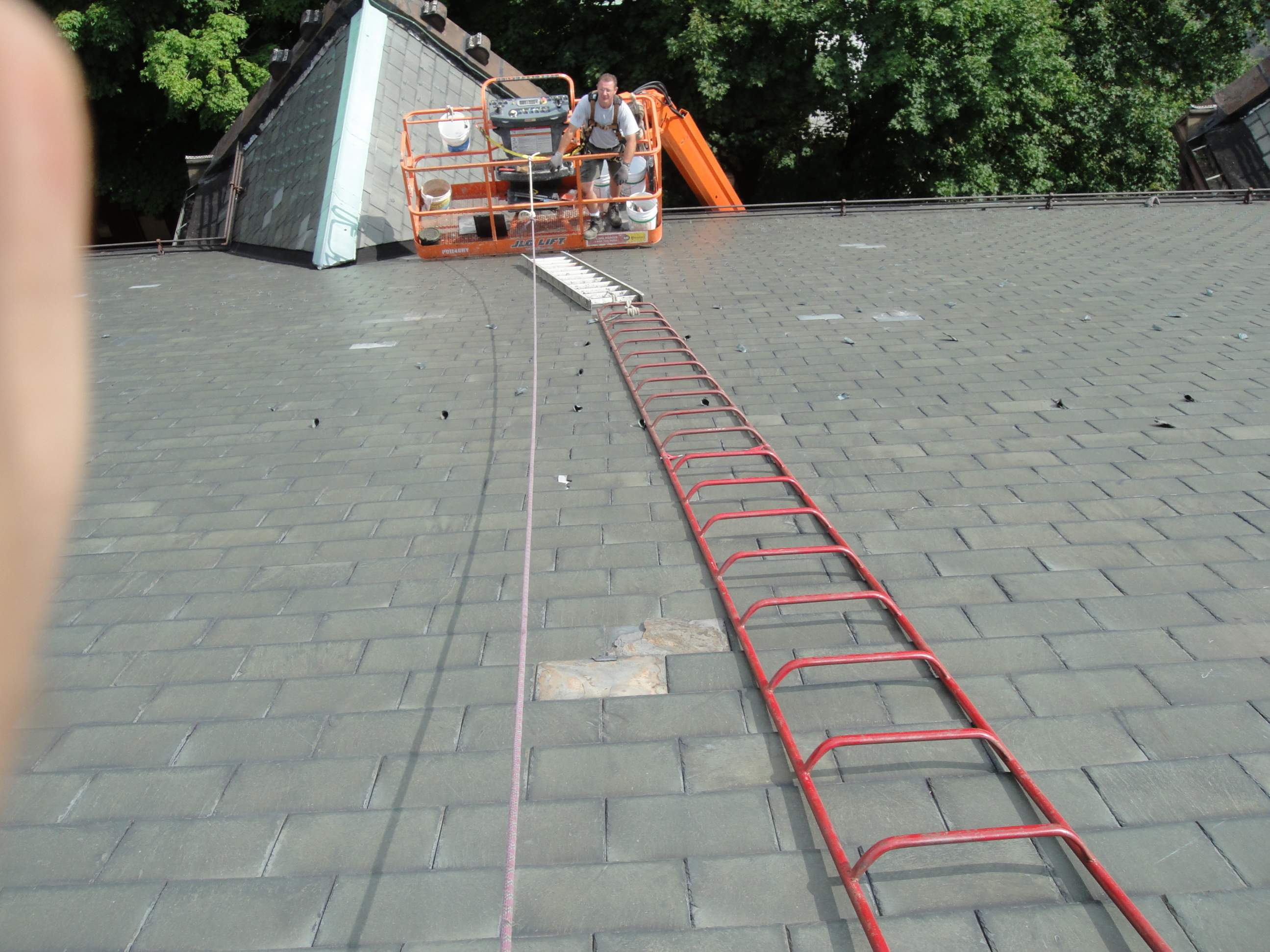

IMO you couldn't work comfortably enough using a rope to position yourself, you would need a hook ladder.
12/12 roof slope:
Now on that roof you could just lay the ladder on the roof, and you could still do that if the edge were higher, but if it is 2 stories the base of the ladder would be too far away.
JB
This is how we access difficult roofs. A steel hook ladder that you can attach sections to as needed. Called a chicken ladder, but I'm not sure why.
