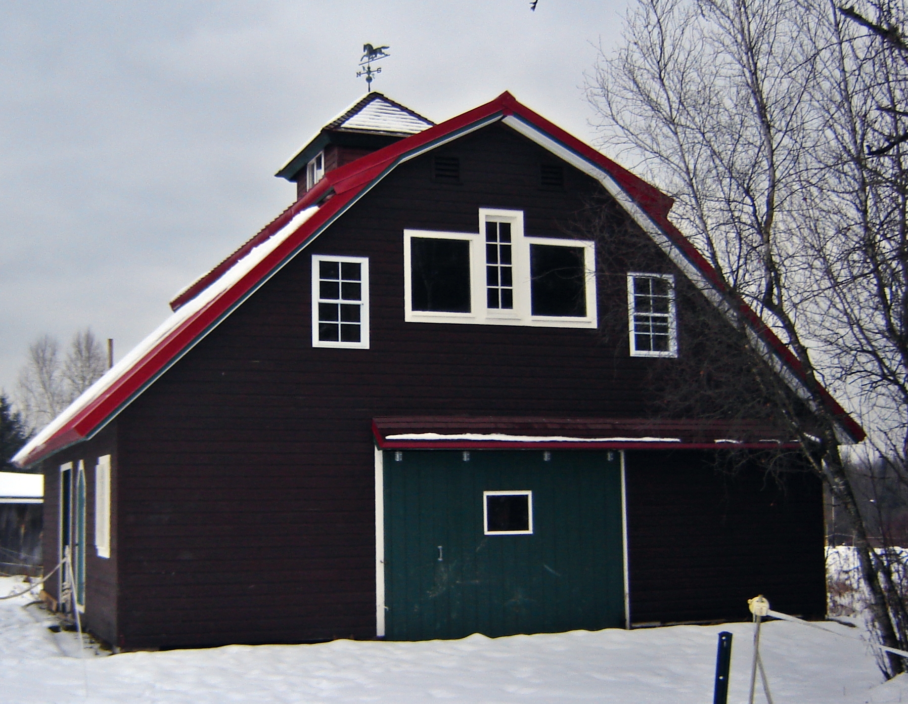

My shed 100 miles north of you is metal on strapping nailed to wooden rafters; everything in it got ruined the first spring I used it due to condensation.
30 x 30 on gravel, two horses - soffits under eaves 1st and 2nd floor, gable vents both ends, cupola eave vents Metal is on 2x4's on rafters.
The windows are always closed, horse door is always open.
Nothing fancy. We store hay on the 2nd floor. Hay bales stored in the spare stall will mold if left over the winter from being close to the ground moisture. There is never any condensation anywhere in the building. I think it is the ventilation and air flow that prevents condensation.
