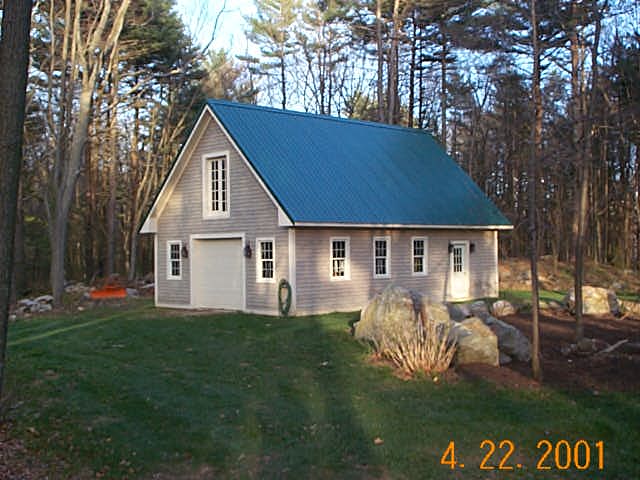

Brett,
We did a metal roof on the workshop/barn - 14 square (1400SqFt) using cut to length 3' x19'4" green ridged sheets cut to length from the supplier once we determined the overhang etc.. See the photo.
The cost of the materials, screws, rake and ridge treatment totaled roughly $1100.
Asphalt roofing runs about $40-45/square, then the ice & water barrier, nails and 1/2 or 5/8 plywood & misc
materials for ridge vents cost is about $12-1300. for the same roof.
Most contractors are getting about $130-150 per square installed complete with all materials, here in our area of New England.
As far as a cedar look alike, there may be options out there as mentioned above, however they are likely to be $$$.
