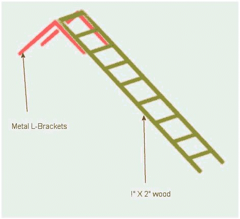

You need a "chicken ladder" for footing on that roof. My dad built one for working up on our roof when I was a kid.
He took two L-brackets about 12" and attached them to a couple of 1" X 2" boards that were long enough to reach from ridge to eave. then he attached 18" pieces of 1X2 to those two pieces to form the ladder.
The L-brackets hooked over the ridge and the ladder layed on the roof providing him with an easy foot hold to walk up the roof to the top.

<font color=blue>You need a "chicken ladder" for footing on that roof</font color=blue>. Firefighters call them "roof ladders". Very handy.
