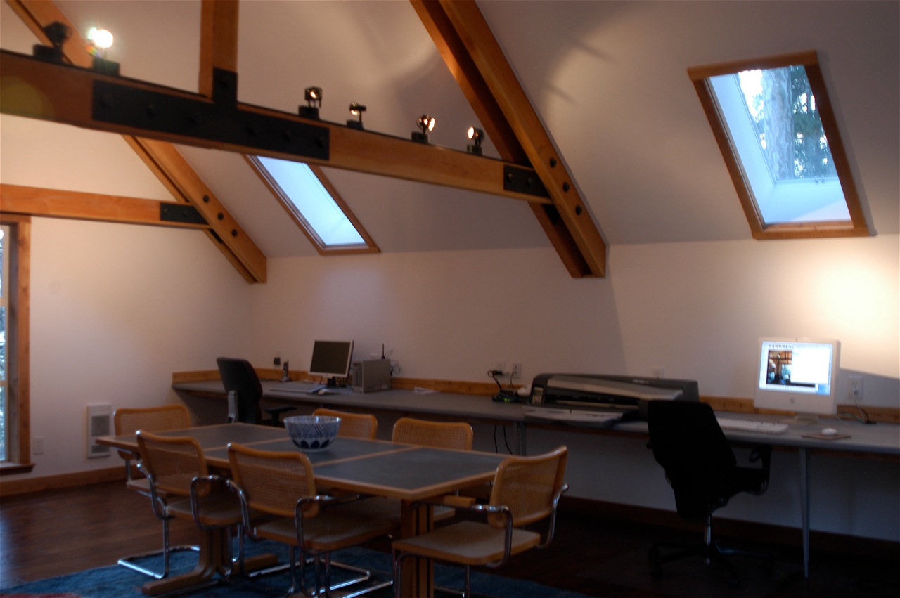

Cost of skylights will depend on which metal system, which skylight and size. I used standing seam galvalume roofing by Westform. They, like most manufacturers, make flashing kits for standard 2 x 4' skylights. Kit cost was about $80 per skylight and the roofer took about 2 hours to flash each one in. Skylights cost around $200 each for top hung openers and fixed lights would be cheaper. I did the kerb work on the rafters at 2' centres and the drywall and trim so the cost per skylight was around $400.
Couple shots are attached showing what they look like inside and out.

Nice conference room you've got there. How is that HP Designjet printer treating you? I had a first generation one of that style and it was a disappointment.
