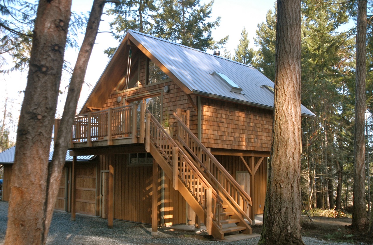

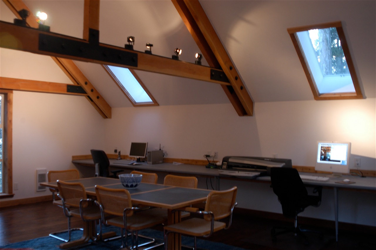

Cost of skylights will depend on which metal system, which skylight and size. I used standing seam galvalume roofing by Westform. They, like most manufacturers, make flashing kits for standard 2 x 4' skylights. Kit cost was about $80 per skylight and the roofer took about 2 hours to flash each one in. Skylights cost around $200 each for top hung openers and fixed lights would be cheaper. I did the kerb work on the rafters at 2' centres and the drywall and trim so the cost per skylight was around $400.
Couple shots are attached showing what they look like inside and out.
/ metal roof #15
Shots attached.

Nice conference room you've got there. How is that HP Designjet printer treating you? I had a first generation one of that style and it was a disappointment.
/ metal roof #17
Hi, mjncad
The old designjet 350c I had was something of a monster, slow output and pretty high consumable costs, but the 130nr has performed well. It's fast and ink cartridges last. Only glitch is getting the pc on the network to recognize it so it's USB connected and direct driven by the pc. It would help if it had a wireless card but was easy enough to connect to the macs wirelessly via an airport extreme.
