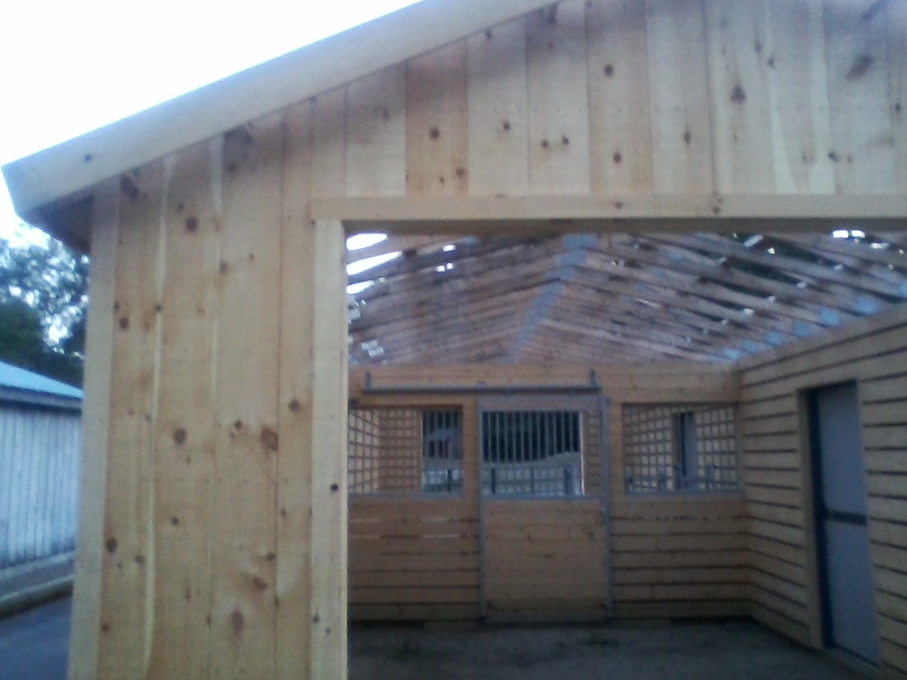

Farmer down the road about 30 miles built a pole barn for more of his hay. His trusses looked like Peter 315's except they were made of galvy steel. Don't know if they were commercial manufactured or it the guy built them himself. This was five or six years ago and the structure still stands.

thats called a ladder truss around here.....mostly used for floors but I've seen it used for roofs......the only thing I would want to check out is that it has been engineered for the specifics of the building.......generally you want like materials to be with like materials.....so steel trusses with steel posts.....wood trusses with wood posts...reason is movement of differing materials as well as the connections between the two.......not saying it can't or shouldn't be done just saying make sure an engineer has analyzed it and signed off on it for the specifics of your building.........Jack

Has anyone used this style of truss ? Sure gives you complete openness to the roof where as wood trusses take that space up. Still looking at all my options for structures. I have a Red Iron quote from Renegade Steel for a 30x50x16 for $20,000 installation not included.

We used some of those one time. Customer purchased them. Every time I tried to pick one up it wanted to fold in half. Had to clamp a 2x6 to it. The 2x6 purlin sat in a U that wasn't very tight with just a nail holding it in place. And if you can drive a nail horizontally through that U and 2x6 then through the U again you're a better man than me.
Maybe I was missing something.

The purlin holders come pre-drilled with 2 holes on each side then use screws or nails to secure.
