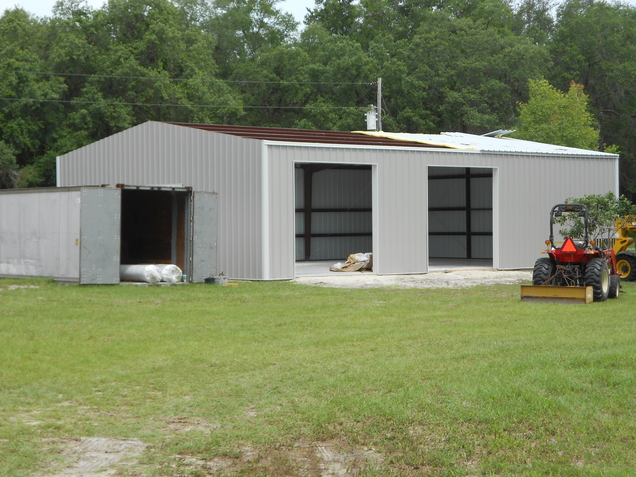

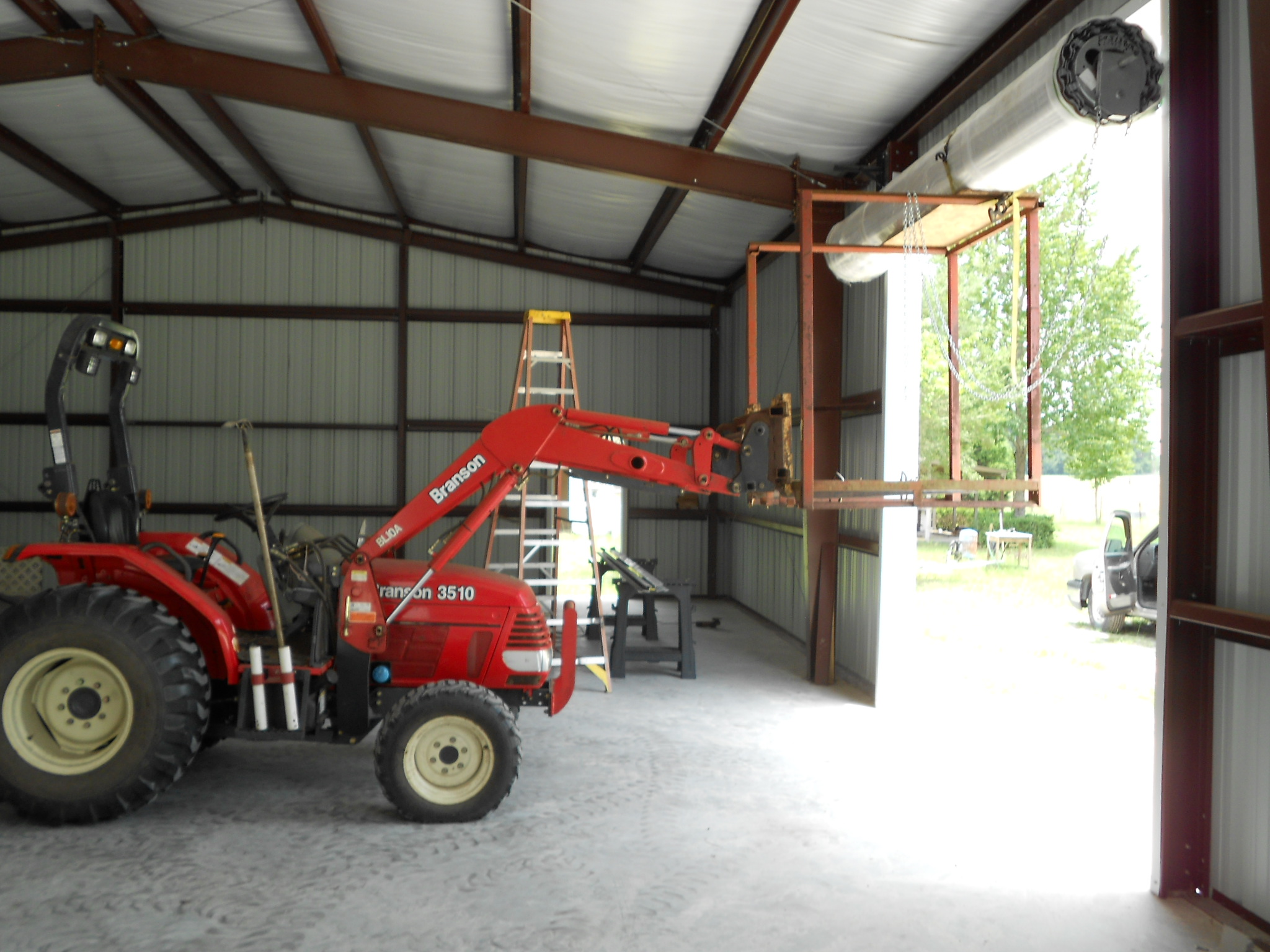

Here was the insulation going on with the roof panels in my 40' X 60' building.
Second pic you can see it from the underside.
I forget the extra cost but it was worth it!
My building is comfortable on the hottest days with just a fan on.
