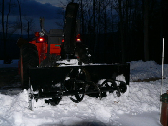

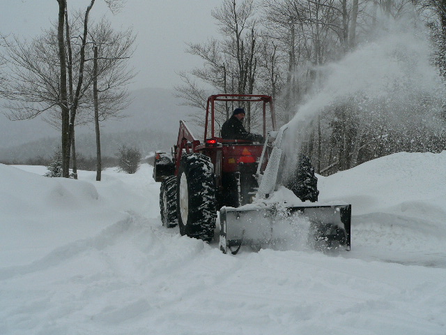

I have a 72" Meteor single auger, I run off the back of a Hesston 100 90. I can also run it off of a Kubota 3710 HST. Great piece of equipment, handles very deep snow, no problem. I make sure the chain and sprocket bearings are oiled and greased and taut and that is about it. I have snapped some shear pins in heavy ice, but that is to be expected. The drive is 1/2+ mile long up a steep mountain side. I find I can adjust how low the unit cuts snow to the pavement by rocking the cutting blade with the top link adjustment.
It was a reasonably priced piece of equipment and I have gotten a good 8 or 10 years out of this unit and it has not let me down. I note the point about the open sprocket chain drive......... under normal conditions it should not be a problem, but I can see how a rock could get up there and it would do damage for sure!.

Has anyone made a chain guard for there blower. It looks simple enough to make one. I have no idea why they didn't make one.
