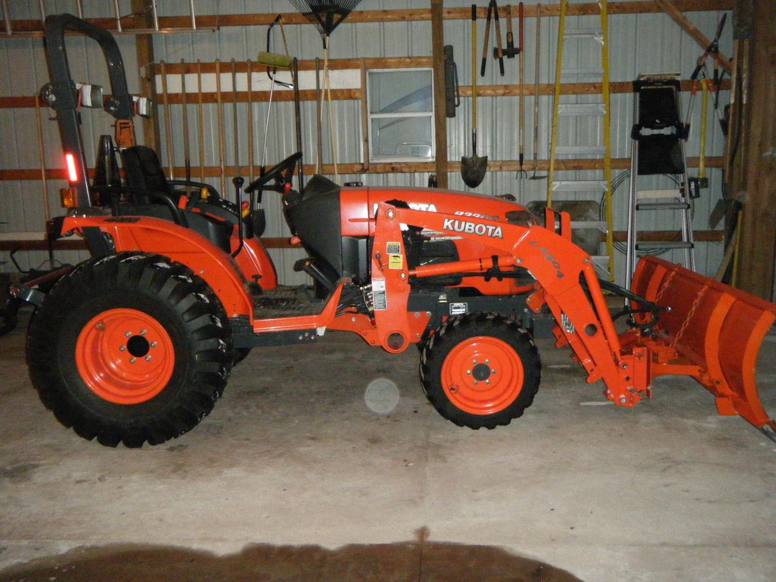

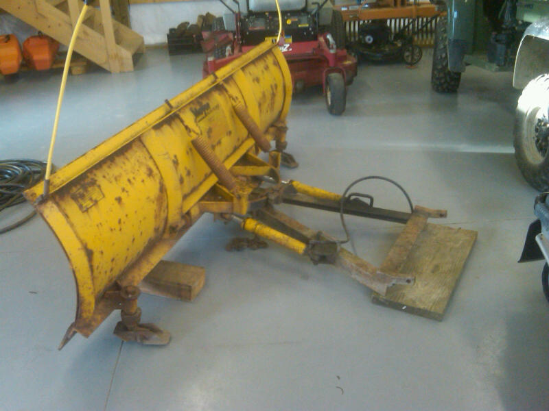

Photo of plow... In good shape. No work needed other than new hoses...
Where are you at Weedbo? Maybe someone close can help out...

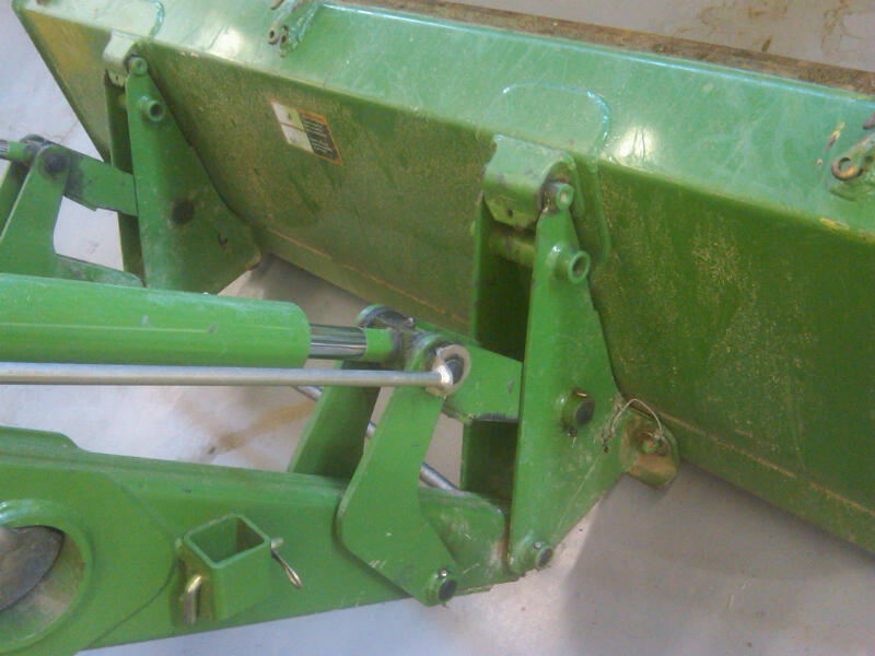

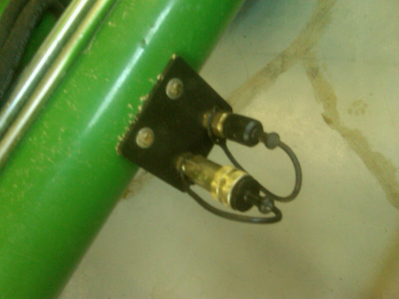

Photo of loader and valves to operate angle on plow.

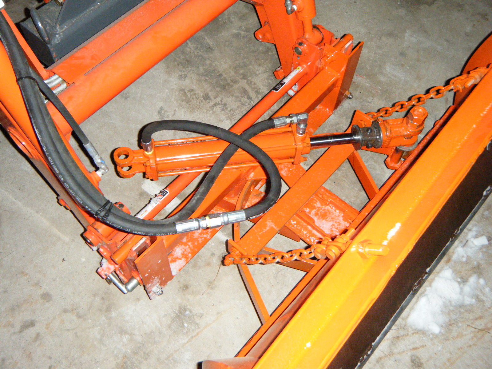

My setup is similar, Meyer 6' for $75 (roadside bargain)
about another $75 for new face & misc. steel & bits
A reworked Free-bee double acting cylinder to turn it with some rigging.
Mine had a pretty good cutting edge, but a old timer showed me his setup with a heavy Tube (2") welded on the bottom to keep from scarfing the concrete, float above the gravel/stones, & keep from pealing the turf out. Bonus is you can lose gauge shoes & trip springs to shed some pounds.
seems to work very good & the tube is on it's third year w/out much wear.
