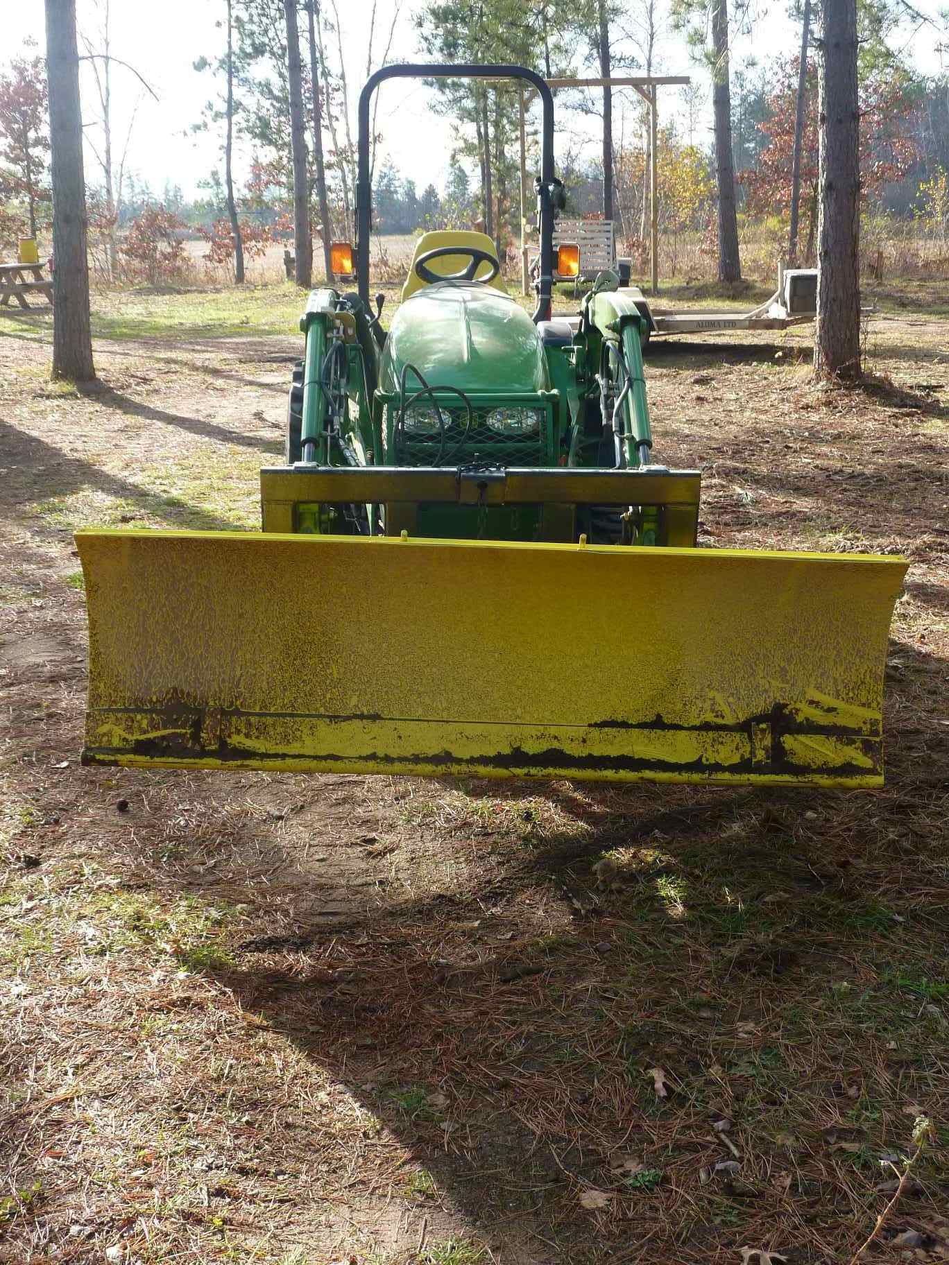

OK so here's another thought, set the height and the proper level of the A-frame along with the right amount of chain slack, with the curl all the way back. That way you take that curl position out of the equation and just have to get the height of the loader right with some kind of indicator.

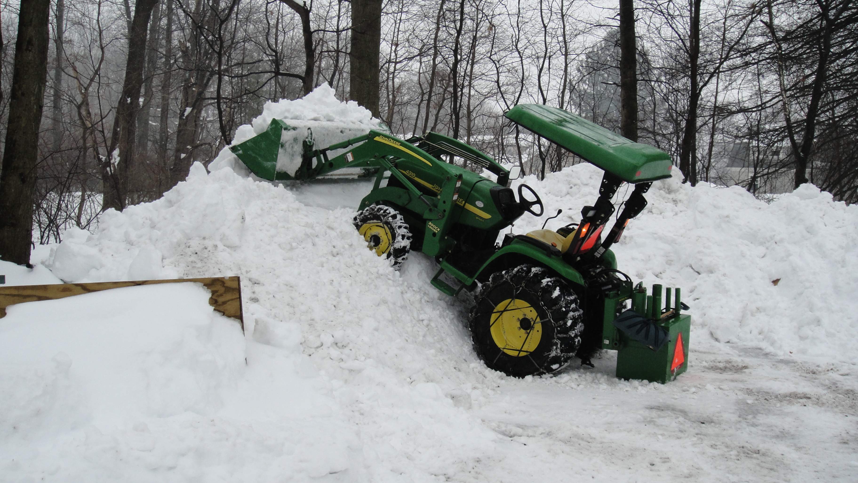

I ran out of time to try different set-ups with the loader, chain, and plow.....but I think what you suggest above may be about the easiest way to set my plow up.

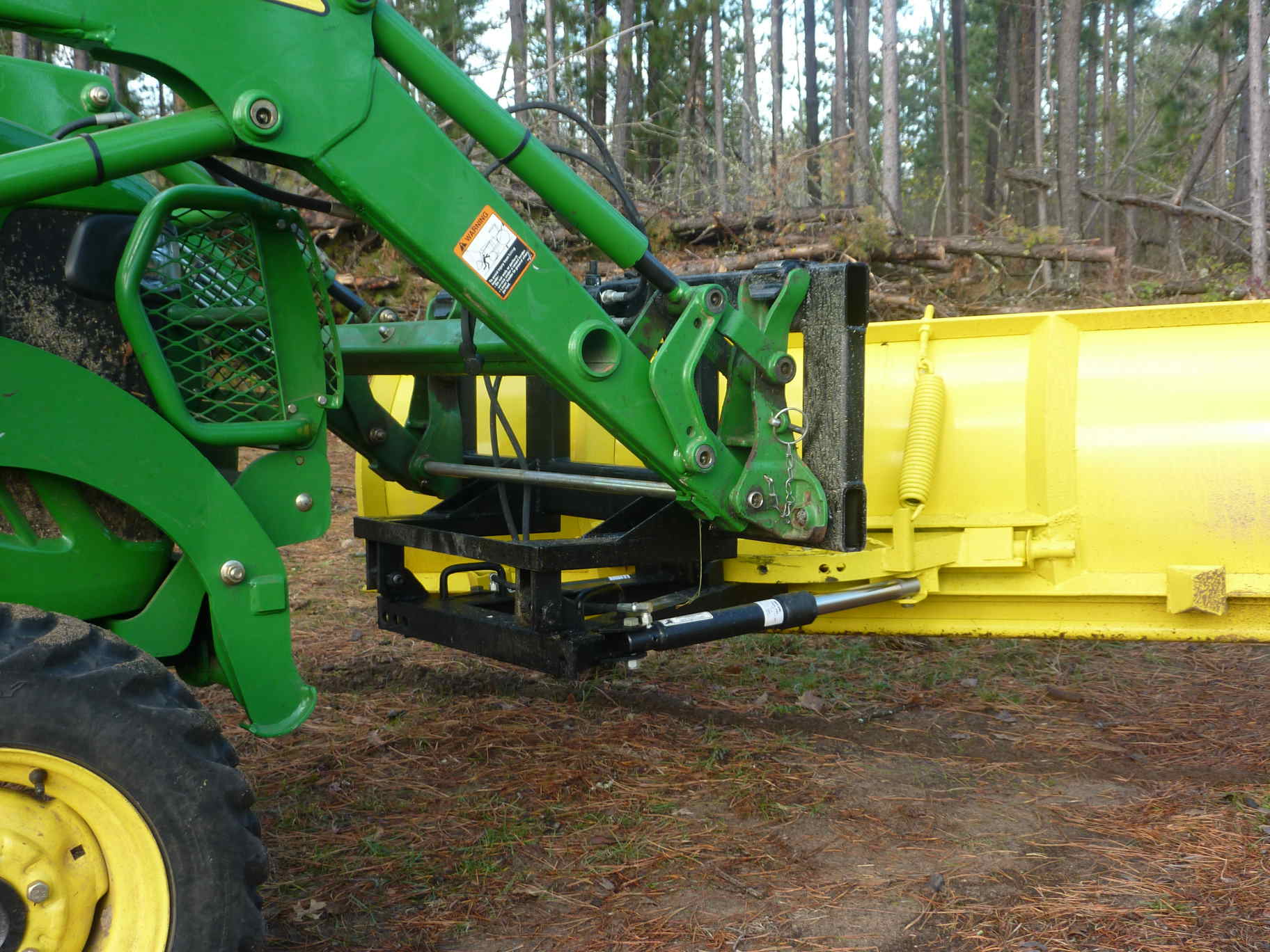

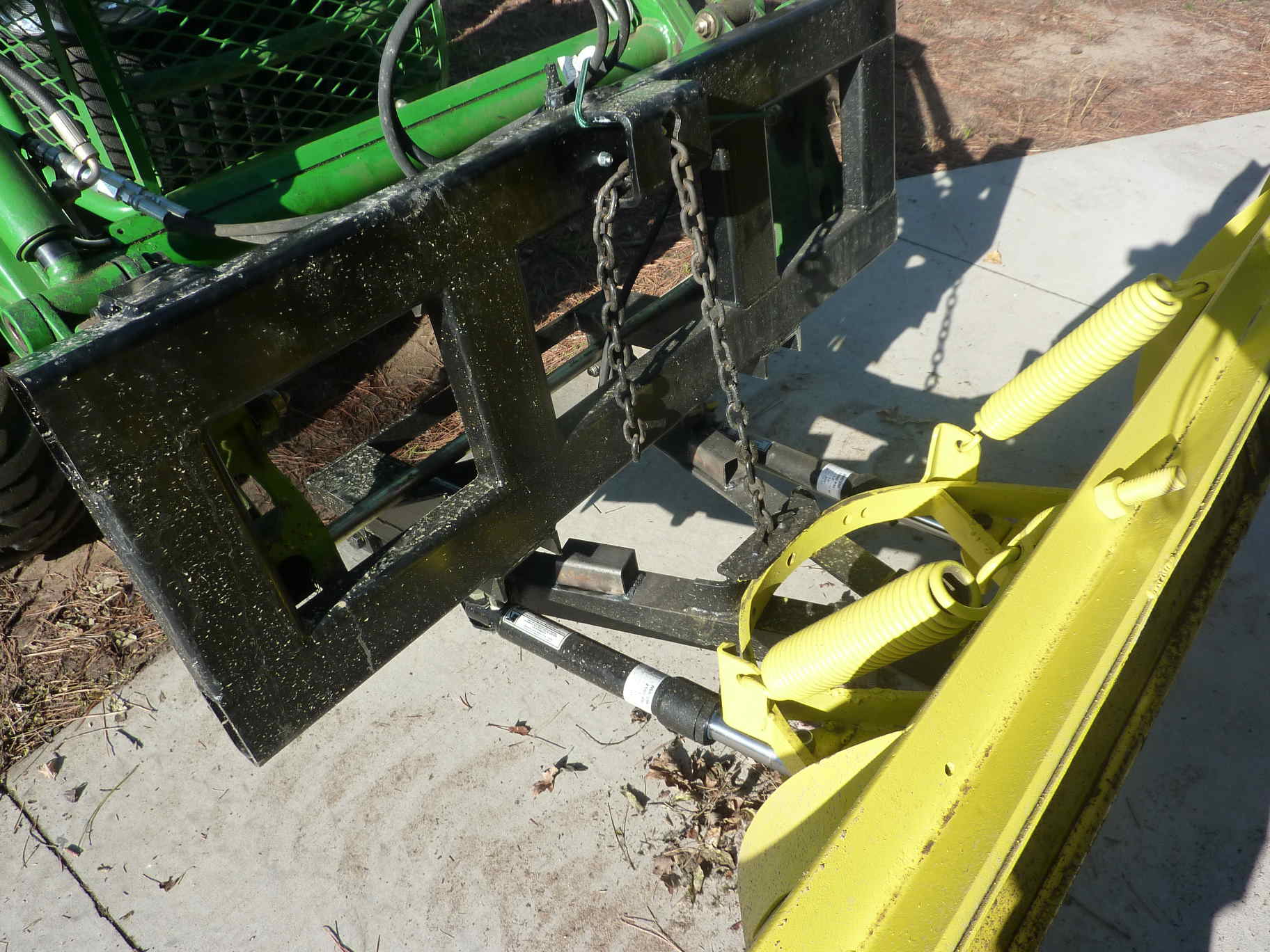

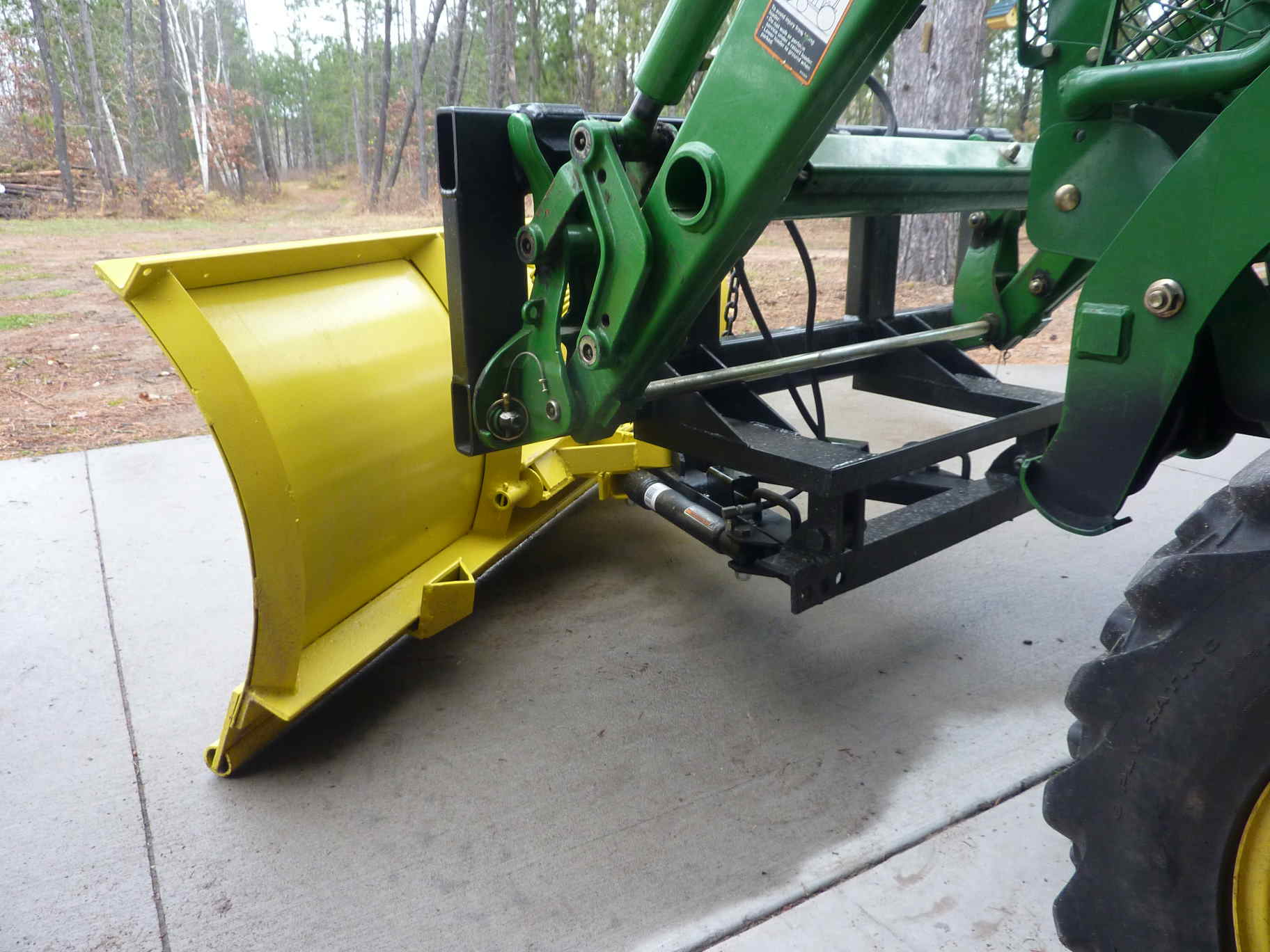

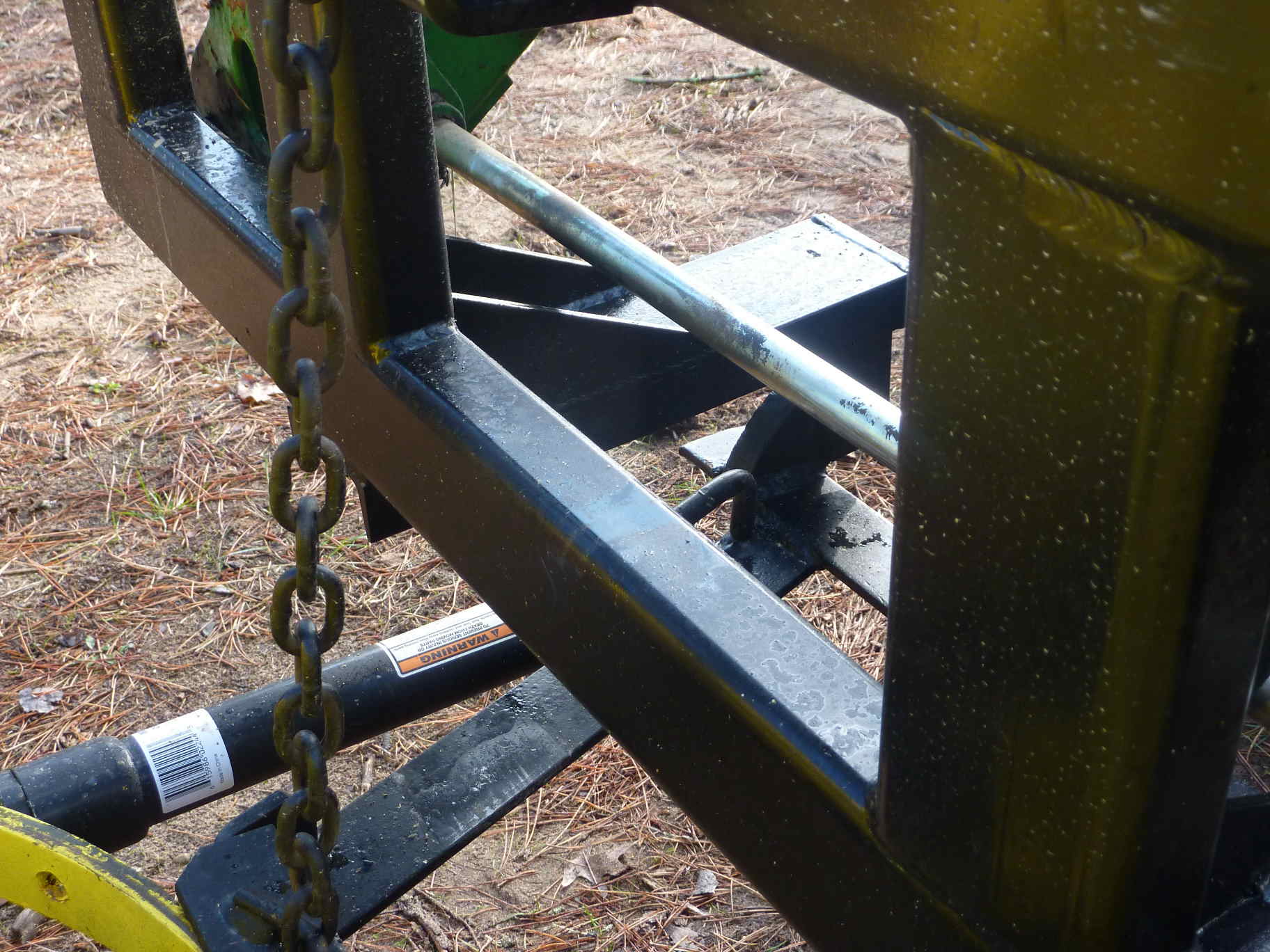

I did snap a few more pics.....so I am going to post them below. A few other guys have a similar build underway....and I know how helpful the pics can be. Pic #4 shows the gusset relationship to the JD 300CX loader timing bar....pretty close. IMO these gussets are fundamental in providing the strength needed in my build.
There are lots of ways to do a FEL plow build.....but I think this is a good way for my purposes. A major benefit to my build is that I can remove my plow and have my bucket or grapple back on in a few minutes....with no tools. :thumbsup:
I paid $150 for the old ST80 plow (with no hydraulics). $450 for steel and the welding shop and blade tube. $70. for JD QA Mounts. $140 for sandblast and paint. About $350 for cylinders, hose, X-over valve and JD Couplers. $1060 total.

Great post, Foggy!!
It sounds like you did the design and parts/material procurement and sourced out the assembly work..so now you're a Project Manager!!! Make sure that goes on your resume!
Even with that timing bar in close proximity to the gussets...well, that structure is all fixed, is it not? Meaning the gussets can never actually touch the bar...am I correct in that?
All told, one really nice job!!! I commend you!

Roy...you are correct about the timing bar and fixed relationship. No problems.
Yep....I was designer, project manager and procurement specialist and part-time grunt.....but I got lots of that stuff on my resume....and I ain't planning to go back to work! :laughing: With all my outsourceing....I should name this plow the "Dreamliner"....just like Boeing!
Actually.....I have done this sort of thing all my working life, so I have been down this path a few times. ;) I really had not planned to put hydraulics on the plow in order to keep my costs down.....but what fun is a manual plow?
What makes it difficult is getting put on the back burner for weeks at a time....and not having my tractor in the same location as the plow build for reference and dimensions. The welding shop had some problems visualizing my build at times. They kept wanting to make changes. :mur:
