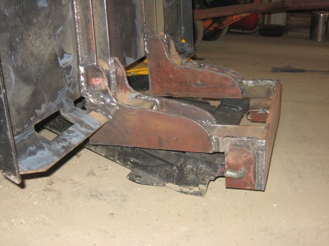

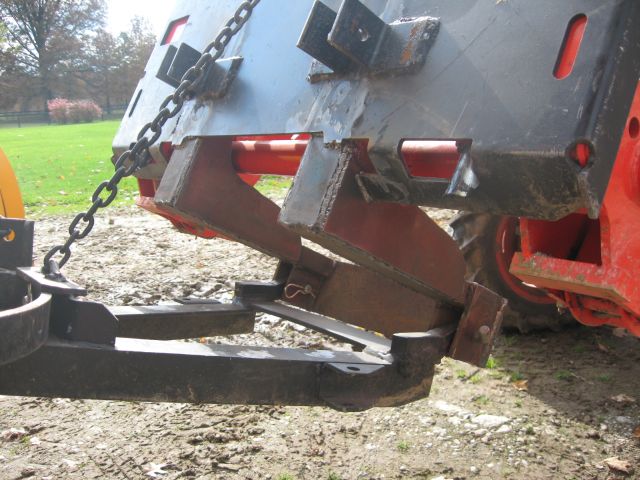

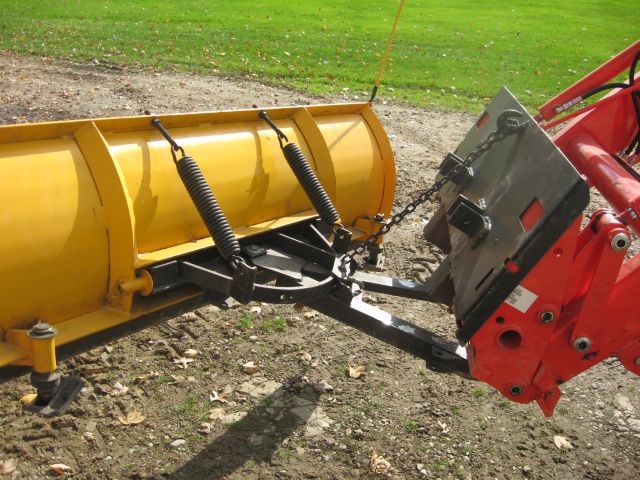

When I designed my plow setup I used the chain and like Foggy moved the mounts back behind the QA plate. When I want to float it I curl the loader and if I want downpressure I can dump the loader untill the frame of the QA bracket pushes down on the plow frame. Best of both worlds. Thats the theory anyway since I just finished the plow and am painting it now. :D:D I'll see how it works in snow and if I need to I can add skids to the back. My driveway is about 220' of concrete with a 30' x 45' turnaround and about 200' of gravel driveway to my outbuilding.
Jeff
