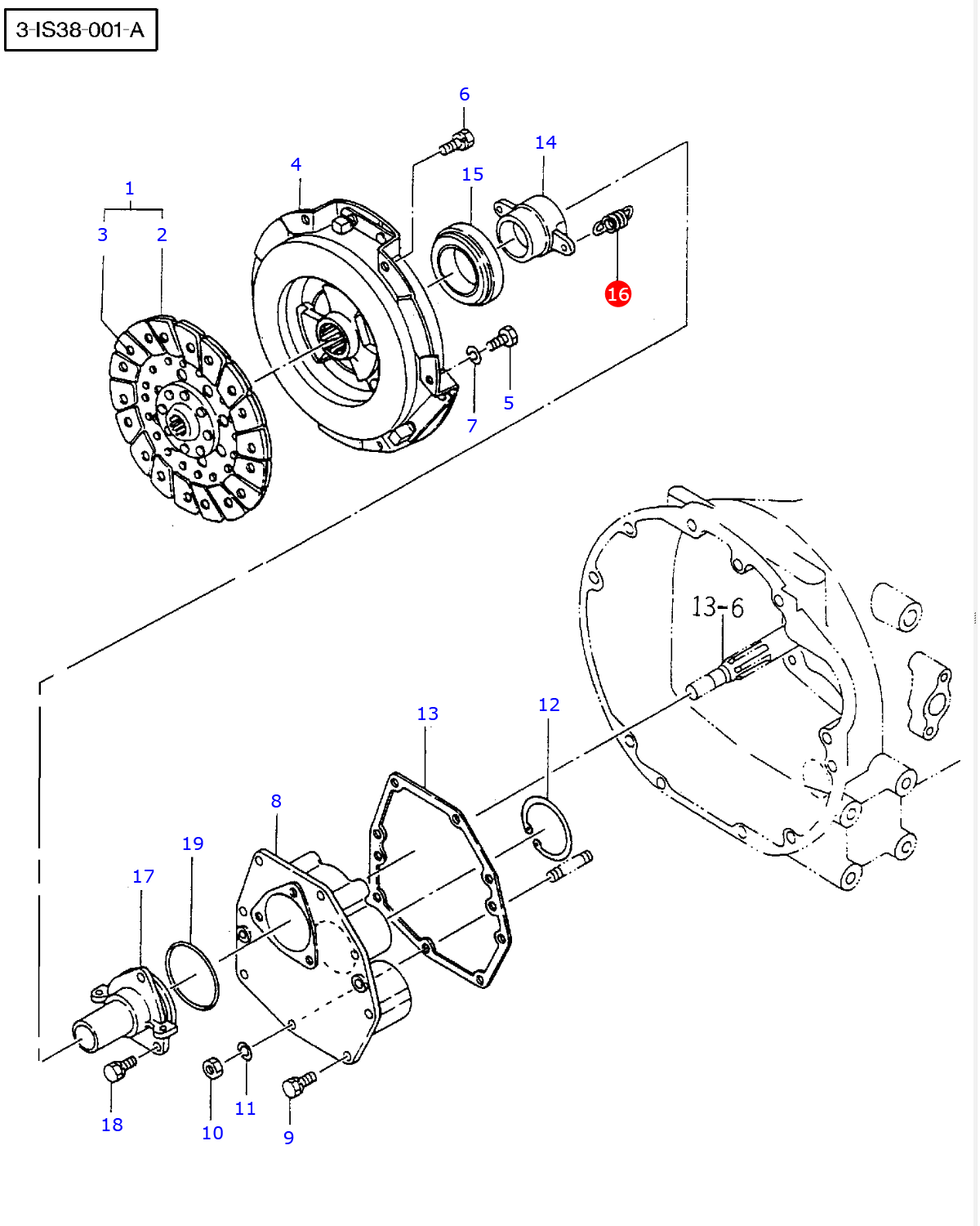

Ok I'm trying to figure out what all parts I will need to buy. I've got a friend that is going to help me replace the clutch. I've never worked on the tractor other than fluid changes etc.. but I have been inside several motorcycle engines. I went to agcopartsbook and found the part number for the clutch disc - 3703735M92 Item number 1. clutch.png
I looked up this part number and found cross referenced kits with part number M3703705NU that comes with a new pressure plate, disc, and hub for around $350. Is that all that I need to buy? Any other bushings / gaskets / seals etc I should replace while I have it split? Also I found a new clutch disc for under $100. Would it be foolish to just replace the disc?

The pressure plate if servicable will need resurfacing. You need to pressure wash the tractor to find your leak which will give clues as to it's origin. Your leak is either engine oil (rear main seal) or hydraulic oil that could leak from several points on the tranny. If it's a few drops, I wouldn't bother with it. Your going to have to dump your hydro oil reguardless if your doing it yourself.
If your going to attempt this yourself, it's best to have a factory service manual to properly install and adjust it. You will need a clutch alignment tool as well. If you've never split a tractor before to replace a clutch, my suggestion is to think twice before doing it yourself. It's a big job.

Luckily I don't have to do it by myself and my buddy has done a few in the past. I can't seem to find the correct alignment tool sold anywhere though. I already ordered the service manual. Anyone know where to find the tool? The kits I've found do not mention including it.

Very foolish to just replace the disc. Get a new release bearing & pilot bearing. Should do the rear main while you're in there. Check the adapter plate bolts behind the flywheel to be sure they're good & tight.
Alignment tools are usually sold thru an AGCO dealer they are usually made of plastic and will keep you from damaging your new parts.. The service manual is a must. MFRED's advise is solid

Thanks that is what I needed to hear. The service manual should arrive next week. I will go ahead and order the parts. Will call my local dealer and see if they can get me the tool.

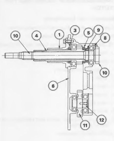

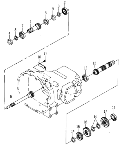

We finally got around to splitting the tractor. The clutch pads were all worn down. The housing was full of hydraulic fluid. Looks like a seal on the input shaft has leaked. I bought the rear main seal as suggested but didn't think about the transmission side. From the parts diagram it looks like there are 3 different seals and an o-ring. I guess I should order all of them and replace them all since I'm in it this deep already.
Attached is the parts diagram of the input shaft. #4, #5, and #9 are all listed as seals. In the earlier post the clutch diagram #19 is the o-ring. Anything else I should take care of while I'm in it.
Also the input shaft at the pilot bearing is worn down making the replacement bearing loose. The original "pilot bearing" was actually just a bushing. My buddy said just leave it as is but figured I'd ask you guys your opinion. A replacement input shaft is almost $300.
Edit to add side cut away diagram. In this diagram #3 is the #4 seal in the parts diagram.#5 and #9 are the same. I presume I need to replace all 3 of these seals. Hopefully someone can confirm.

Got the tractor back up and running. I ended up replacing all the transmission side seals and the rear main seal. Important to note the replacement rear main seal is slightly wider than the original and does not seat 100% there is about 1/16" remaining. We ended up having to break the tractor in half a 2nd time because the 1st attempt at seating the new rear main failed. I should note that the rear main after the 2nd replacement leaked a few drops for the first half hour of run time. After which it finally got a good seal and havent had any more leaks. We ended up reusing the original pilot bushing as it fit better than the new bearing.
