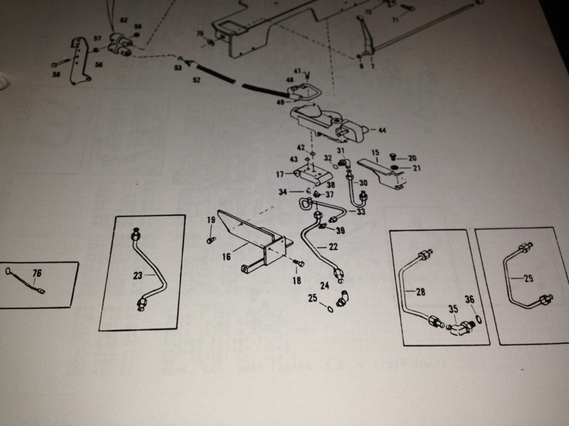

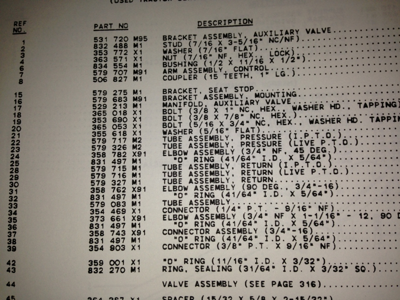

I have a similar question if you don't mind me asking it here.
. I have a 1976 MF 245 with a 1 spool valve. I want to remove that single spool and add a regular (non OEM) 3 spool valve. The tractor is on a remote property so I don't have it to look at right now. From my manual, I see I have a pressure line 23 and a return line 29 (I have live PTO). I am unsure what 30 and 33 tubes are. I assume this would be an open center and flowing back to the return line all the time? It does not look like I need a power beyond, that there is a separate pump for the remote aux?
