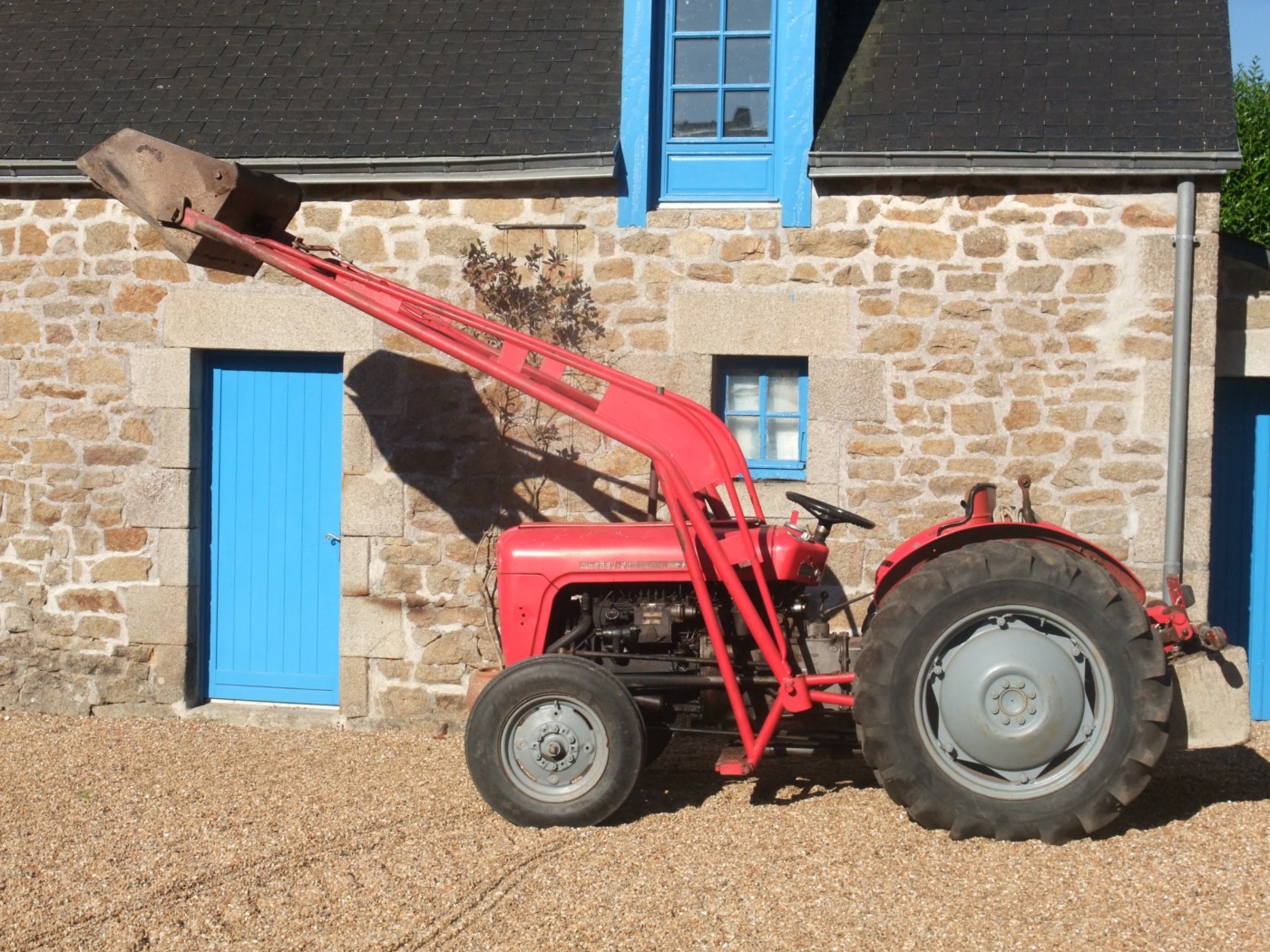

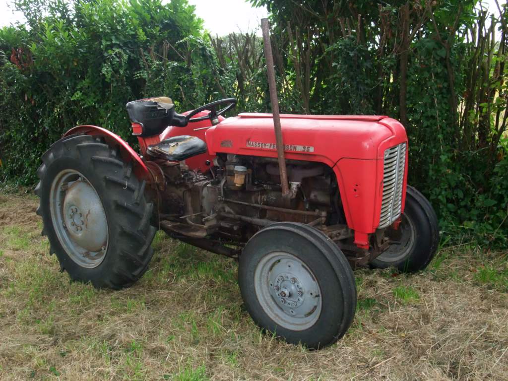

My old Massey 35 had a diverter valve in front of the seat with 3 positions : back outlet (mostly for my trailer), rockshaft, loader (all single action). Of course, only one at a time. This made it difficult for example to lower the loader to avoid a tree without dropping the implement on the 3 points. Still worked great for 13 years.
