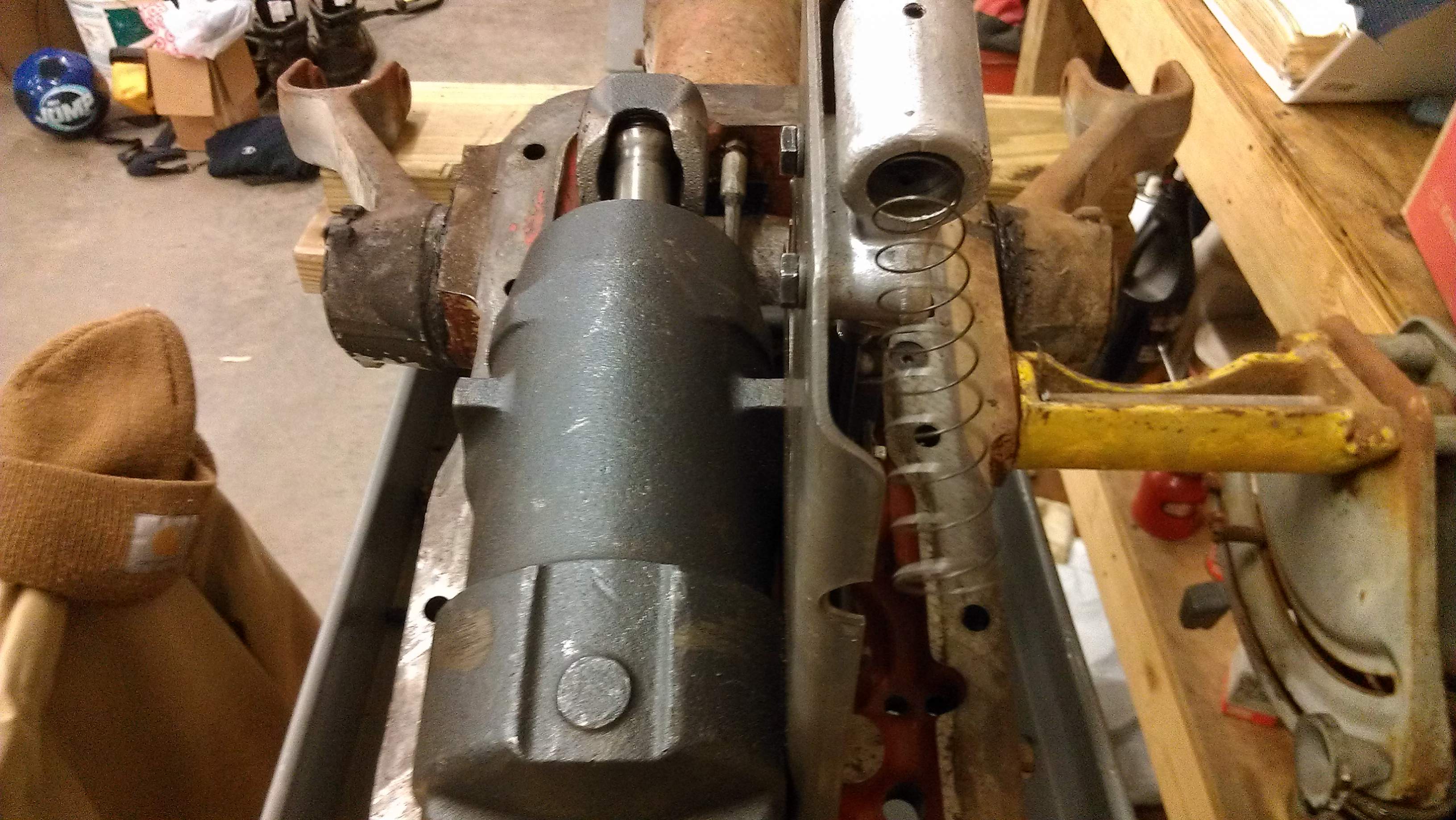

Ok, I haven't been back into the lift cover yet, just re-assessed everything and thought I'd post a few pictures. I have to get the draft control lever about half way between the upper reference mark and the full up position to get any response. Then the knurled nut is nearly bottomed out on to control arm. Got my phone up in the access hole to take pictures of the threads on the draft and position adjustments and there appear to be about 7 or 8 threads showing on the draft adjustment bolt and about 5 or 6 on the position control screw. I had taken pictures before I made any adjustments at all a couple months ago but they have been lost with a phone that decided to die. I'm pretty sure there were not this many threads showing though. When I made my last adjustment, I did not loosen everything before making the adjustments. Could that be a problem? Also, would it help if during the adjustments, I set the draft control lever more toward the down position rather than between the marks? Just trying to offset some wear I'm thinking. As a recap though, I have replaced the rollers on the rods attached to the draft and position control lever shafts. I also replaced the pin that the cams pivot on. Here are a couple pictures for reference.
