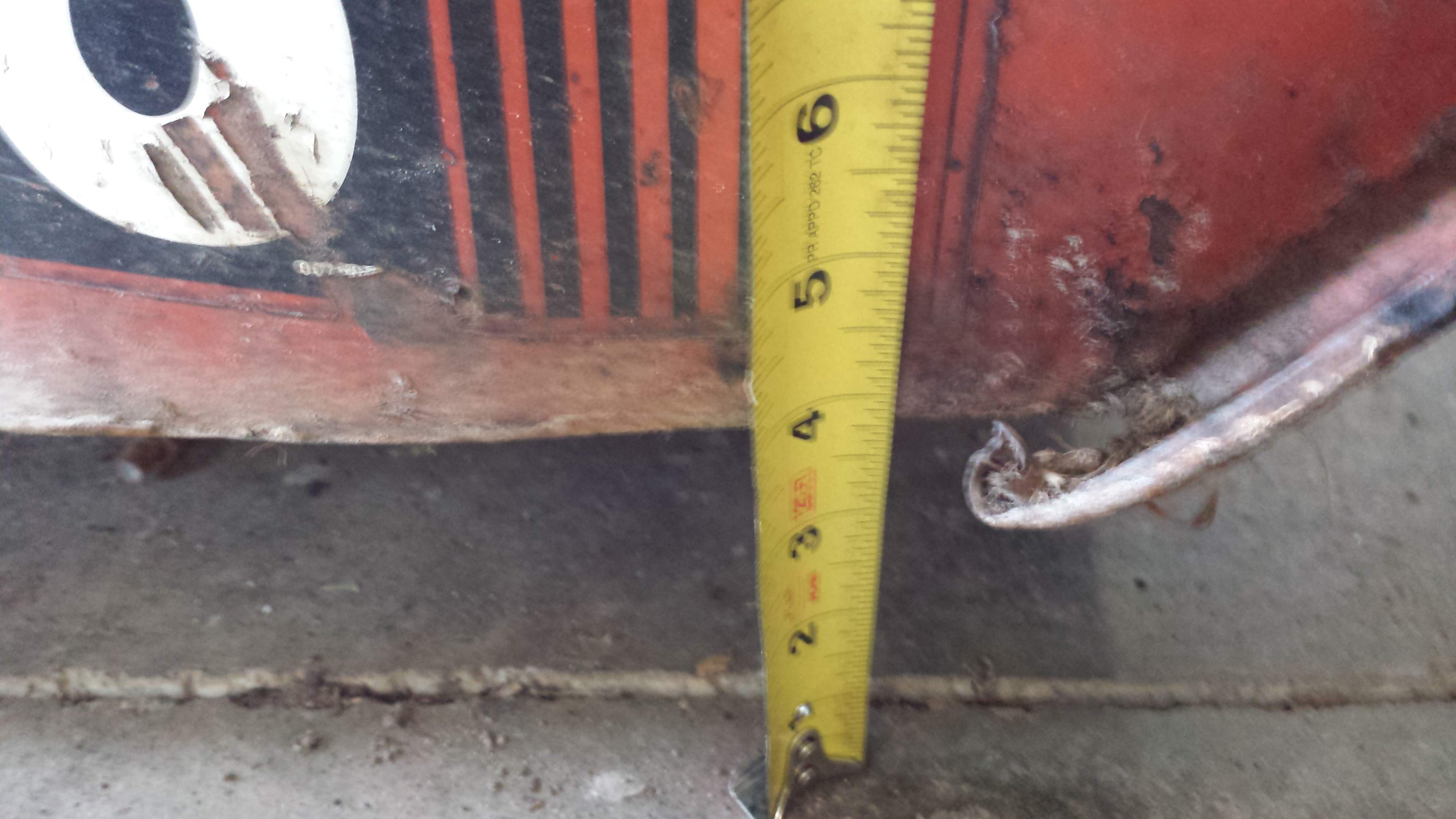

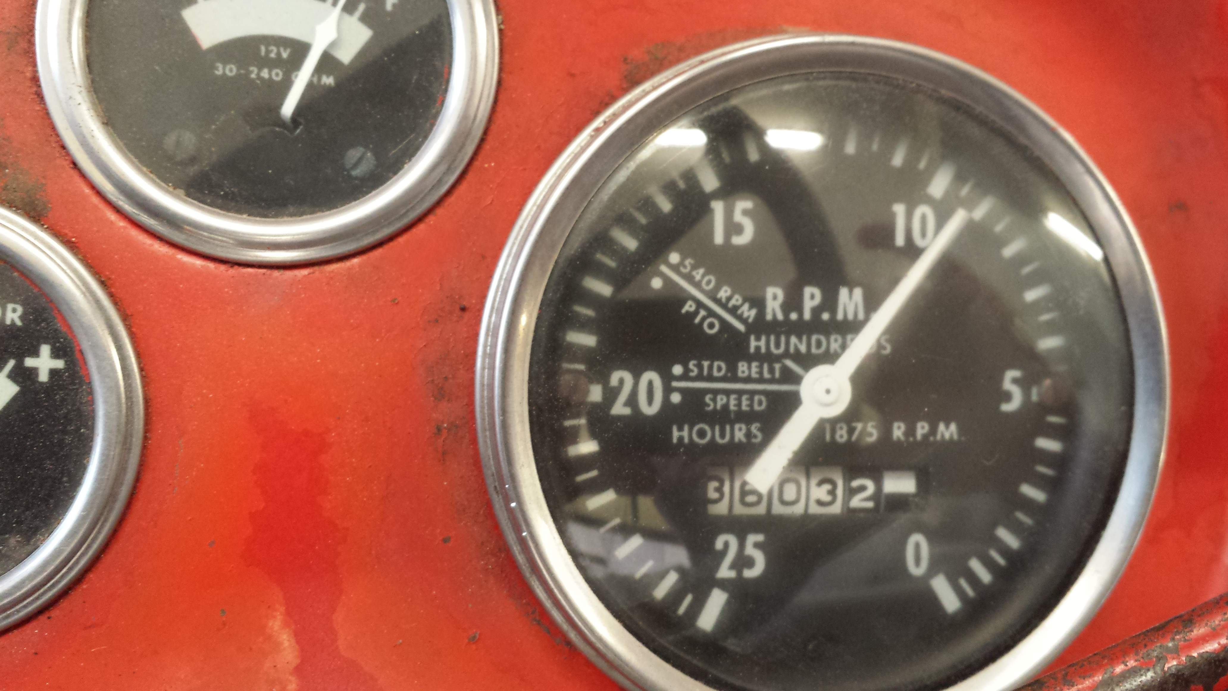

Got some decent weather today and no baseball tournament this weekend so I was able to hook the bush hog up again to test. Hooked it up as I normally would to the top link and removed the side cover. Got the tractor running a little over 900 RPMs. With the draft control lever all the way up, I started to raised the position control lever. When the position control lever gets to about the middle of the word "POSITION" stamped on the quadrant, the control valve retreats to neutral position and the lifting of the bush hog stops.
I was able to move the control valve lever toward the rear of the tractor and got desirable results (it lifted the bush hog all the way up). When I let go of it, it would stay in the fully raised position until I lowered the position control lever. When I lowered the position control lever and re-raised it, the bush hog again stopped raising when the lever got to the middle of the work "POSITION". I played with the knurled nut but was unable to get desirable results without manually controlling the pump. It would only raise the front of the bush hog off the ground about 3 - 3/4".

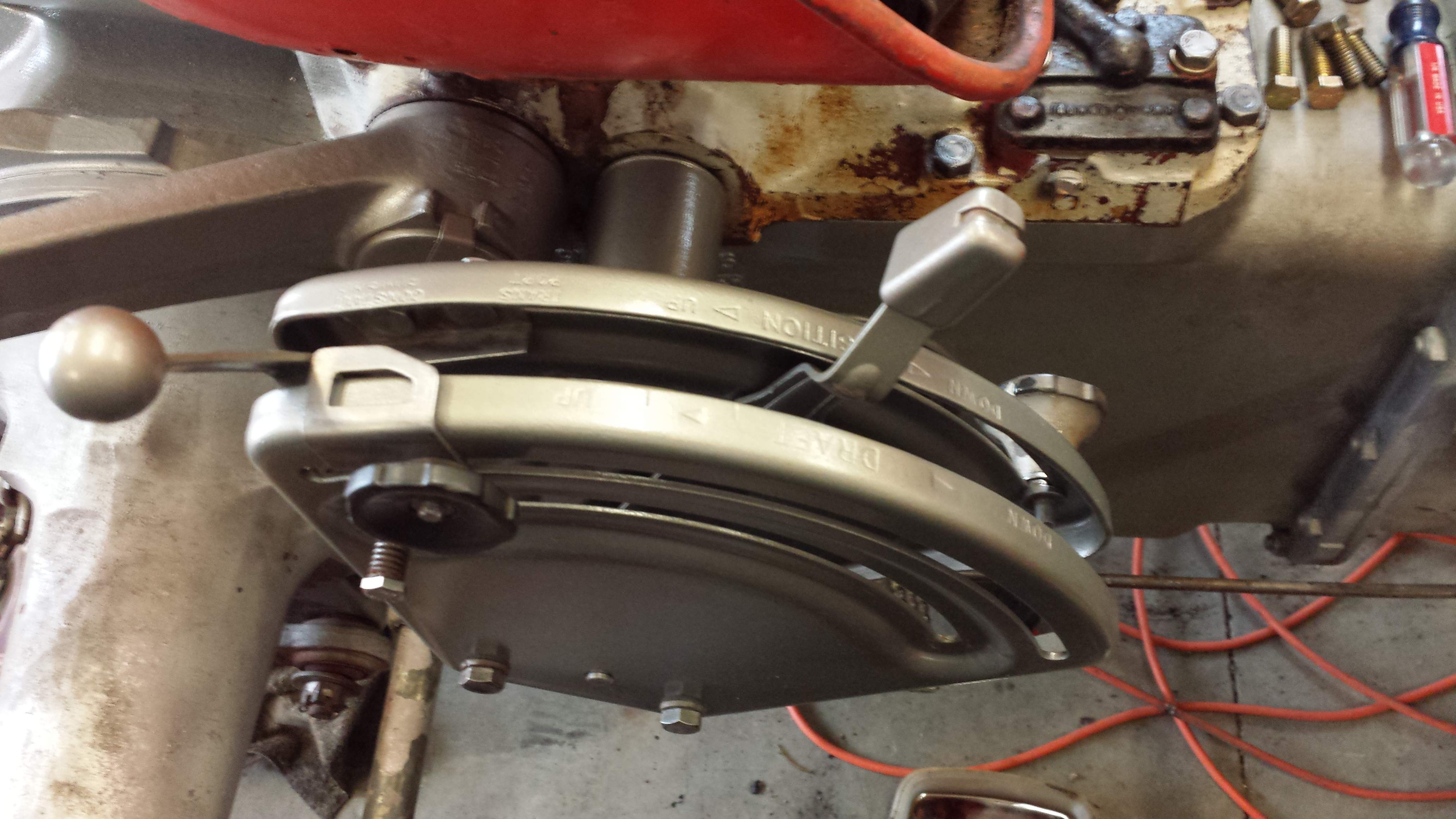

Ok so I took the lift cover off and readjusted the draft and position adjustments. I put the lift cover back on and reinstalled the roller. I feel the control arm is too close to the dashpot because after synchronizing control valve with the lift cover. With the position control lever in the transport position and the draft control lever between the quadrant marks, I cannot get the lift arms to begin to raise by screwing the knurled nut into the control arm. I have it screwed all the way in. I have been using a fish scale to pull 3 pounds on the control arm and setting the gap to 0, just where the control arm touches the dashpot plunger when fully extended. The lift control quadrants were double and triple checked to be in the correct position when making each adjustment. The lift arms were positioned by lining up the chisel marks I had made while the lift arms were in the transport position on the tractor.
Any thoughts? Could I have a slightly bent control arm? Can the adjustments be made using a lighter pull force? That would seem to put less tension toward the dashpot when the lift cover is installed. Again, any help would be greatly appreciated.
Thanks, Michael
