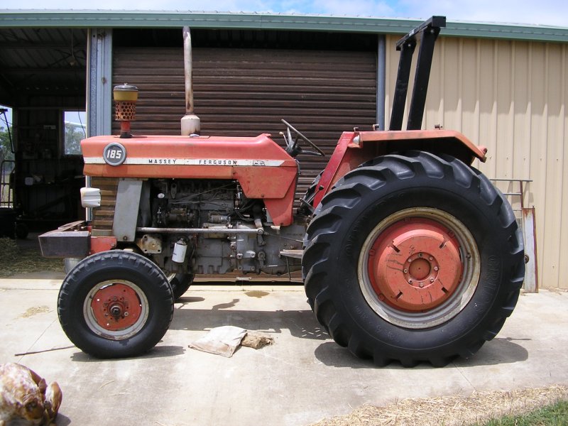

If you can live with the brake between your legs ,Clutch under your *** and throttle in the windscreen ....LOL...Fantastic tractor ...As good as any .

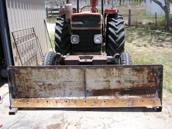

building a front blade at present pics prob 2 weeks away

There great tractors :D :D :D
Just got to get used to driving something a bit less refined:p
Seriously, most of the MF 100 series was pretty stable and problem free.
We have a MF135 and a 165 and they are the some of the most reliable tractors ever.
Not a lot of particular 185 experience from me because I have never seen a 185 but I'm sure FarmWithJunk will know more about them in.
It looks in quite good condition... maybe could do with a repaint.
Does it have multipower? The little lever on the left hand side that lets you change speed without clutching.
Multipower can be tempermental and be very hard, complicated and expesive to fix it if has not been well looked after.
3,500 hours isn't very much for these tractors so it does not sound like it has been worked very hard.
You might have already but it might be worth while to change all the filters and fluids for peace of mind. They might not have been done for a while.
One problem you sometimes get with these tractors is the gear lever getting stuck in reverse when it gets a bit worn. Always seems to happen with new operators when they haven't learnt the layout of the gearbox yet. It it happens it is an easy fix though.
I like the roll bar on it. It will make it a lot safer to use.
Make sure you post pictures of the front blade when you have finished it :)

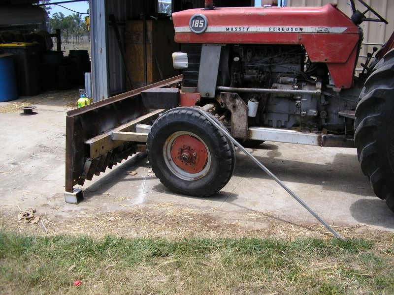

nearly there built mainly from junk..

Looks like a strong setup you are making.
How are you going to lift the blade. Are you going to use the onbaord hydraulics or are you going to put on a new pump tank etc.
What are you going to do with the 'dozer' when you have build it. I wander how it will do without 4WD.
/ mf 185
will be picking up a 3" bore/12" stroke cyl on friday.will be using the remotes to lift lower. there is no angle tilt adjustments.8' wide 28" tall.take the cutting edge off (16g cat grader used from work) and you have a stick rake.may remove the front weight . main use will be clearing small timber.pushing firebreakes.

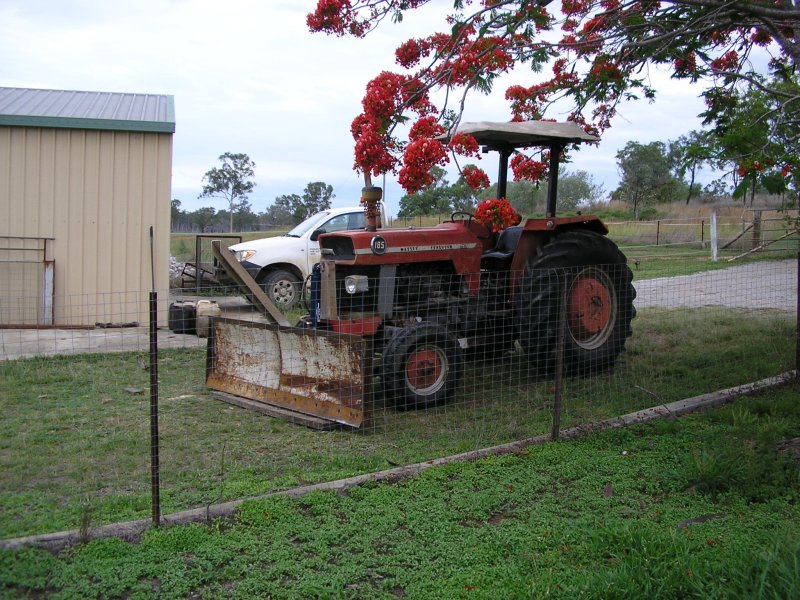

well its done no paint yet.wait and see what i can break/improve..before paint

Ben,
I like it! Totally off of the subject, what kind of tree is that next to the tractor? It's very pretty.

poncianna (grows in qld/tropical islands).in wetter years its much more spectacular and full of lorrakeet's (beautiful red birds /parrots)prob should take a pic of the bluegums down the back also.
/ mf 185 #11
It looks great!

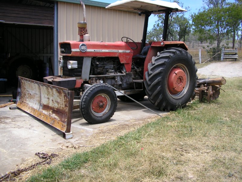

What is the big U beam coming up from the blade for?
Is that an aftermarket canopy for your tractor? It looks to be a much newer shape than the ones I have seen on tractors like that.

the canopy was taken of the tractor for sale and the rops fitted (from june this year all tractors sold must have a rops) anyway i refitted it back on top.the beam is a tree spear,its not quite right yet as the blade hits before the tree goes over (the higher you push a tree the easier it goes over),although i did push some 6-8" regrowth over (box/gum).ironbark is a bit tougher.i'am fairly happy with it but may change the angle of the cutting edge ,slightly sharper..
