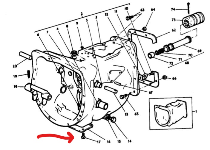

Look at bottom of bellhousing and you wil see that there is a inspectioncover . Open it with a 24mm wrench and you will be able to see the pressureplate.

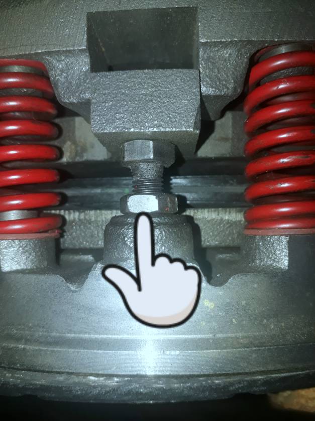

Adj that bolt so that you have a clearance of 1 to 1.5 mm . All 3 must be the same !View attachment 568082
When depressing your clutchpedal to the floor the pto plate must come loose !

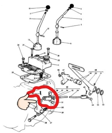

the space between that bracket and the bellhousing must be about 6mm . Thats for the pedalfreetravel 20180824_074037.jpeg

After you did that adjustment you can adjust the lenth of the rod to a nice and easy hight for the operation of the footpedal
With the engine NOT running the next step wil be to remove the bottomplate and adjust that bolt on the inside (all 3 of then)
Let someone help you for the testing of that PTO adjustment by turning the pto shaft at the back wile you depress the pedal down to the floor. If it comes fre your good to go .

Thats the inspectioncover to be removed
