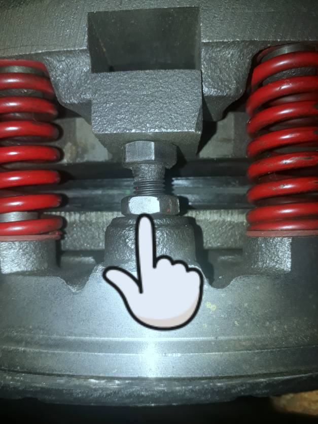

Look in that inspectioncover and if you see that bolt in you pressureplate then that clutch is a dualstageclutch. If not then that tractor has a single stage in .
Sometimes I find a dualstage clutch in a tractor with IPTO in it . Wrong ! 20180823_170333.jpeg

Dear Friend
So today we ve done these steps
Loosen the locking nut with a 1/2" spanner. Insert 13omm feeler gauge between the bolt head & PTO pressure plate, nothing happened
its all the same

we have done the same thing 3 times (i was turning the belt (at the radiator)
Probably i have to go at a workshop and spend some money
anyway i ve learn a lot already
-- There was some liquid when we open the 2 bolds (100ml about)

Dear Friend
Loosen the locking nut with a 1/2" spanner. Insert 13mm feeler gauge between the bolt head & PTO pressure plate, nothing happened
its all the same
Lets start from the beginning.
The first thing to do is to get the freetravel correct.
Loosen clamping bolt and move the outside bracket to get a distance of 6mm between that bracket and the bellhousing casing
   / MF 188 PTO problem #28
Come back to me before we go ahead by posting a photo of that outside arm
