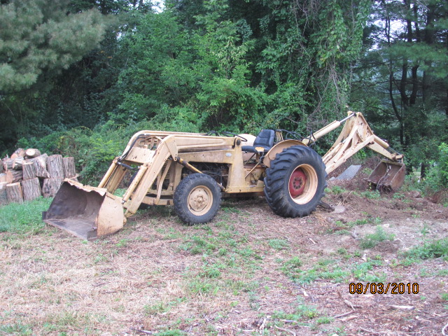

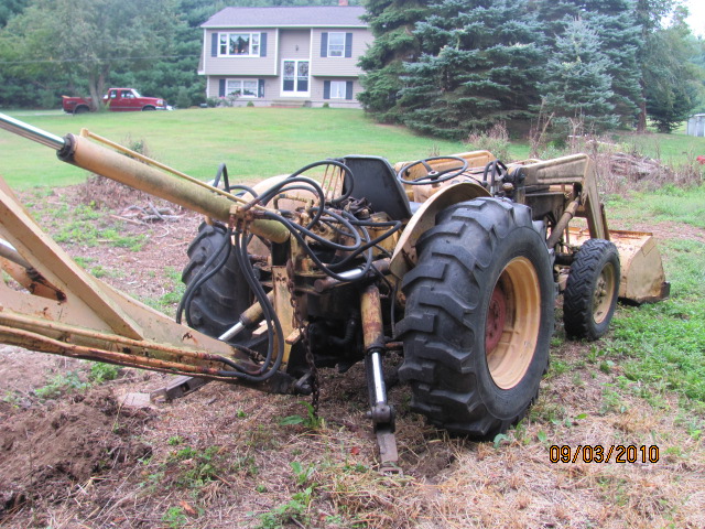

I got the little gem tonight. All rusty and ugly and the guy left the key in the ignition and in the on position for the 2 hour haul so of course the battery was dead. A quick jump and it fired right up. Unfortunately he came late, around dusk and I had to go somewhere with the wife/kids so I haven't even played around with it yet.
The manual he gave me was for Massey Ferguson 202-204. Tomorrow I will look for the model and serial numbers on the tractor - uh, can anyone tell me where I might find that?
I know the loader is a Davis loader, not sure about the backhoe yet. Funny though, I think the front of the tractor says MHF but it was faint and it was almost dark. Could that be Massey-Harris-Ferguson? If so it must be a bit older right?

Took a quick look before work this morning, I think the plate with the serial number is missing. There are four holes in a square next to the steering column, I think that's where it was. The previous owner gave me a complete shop manual with the tractor and from the sheet metal appearance the book says it is a model 202 before a serial number 301 194 which I think would date it to late 1958 or early 1959. There is a number written down in the manual that reads JGF 300188 but that does not look right for a MF serial number. Tractordata.com and other sources say the earliest numbers for the 202 are 1958: 301172 and I don't see any other models with that serial number. Might never get the serial number but at least I think it is a 1958 202.
   / MF 202 loader/backhoe
#20
Here are some pics. I don't really think it's ugly and not that rusty really. Just needs a good wash and fresh paint.
