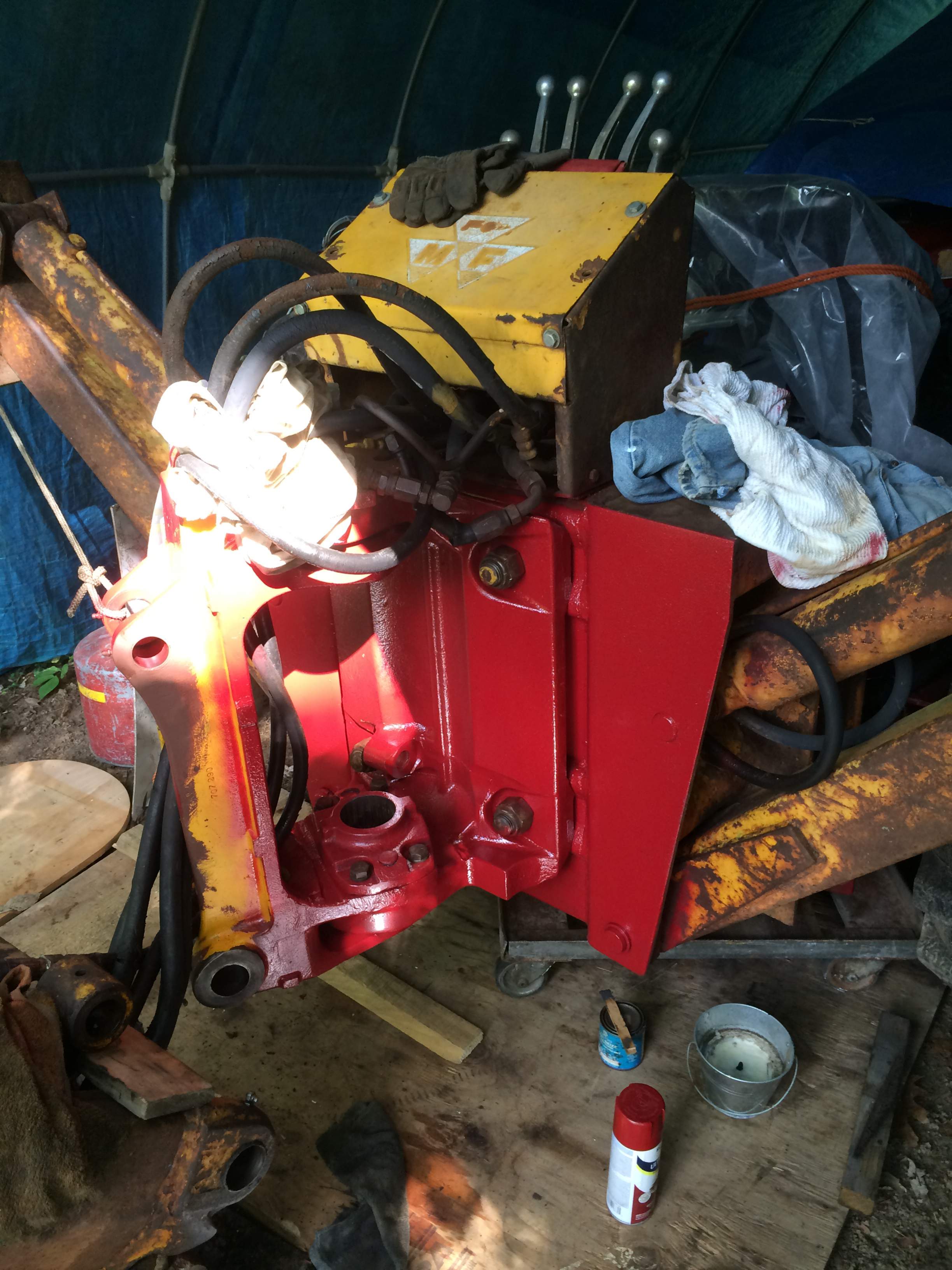

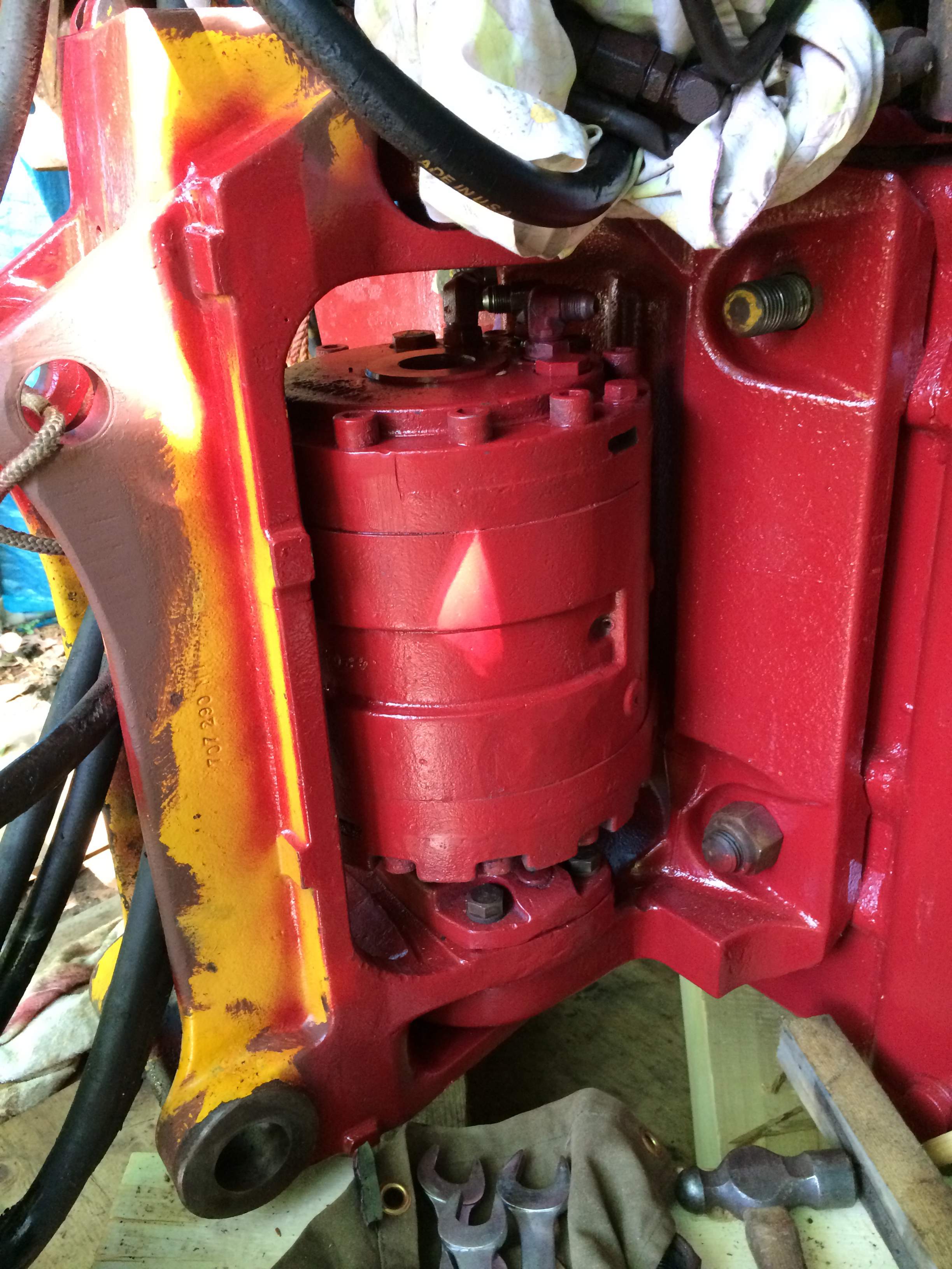

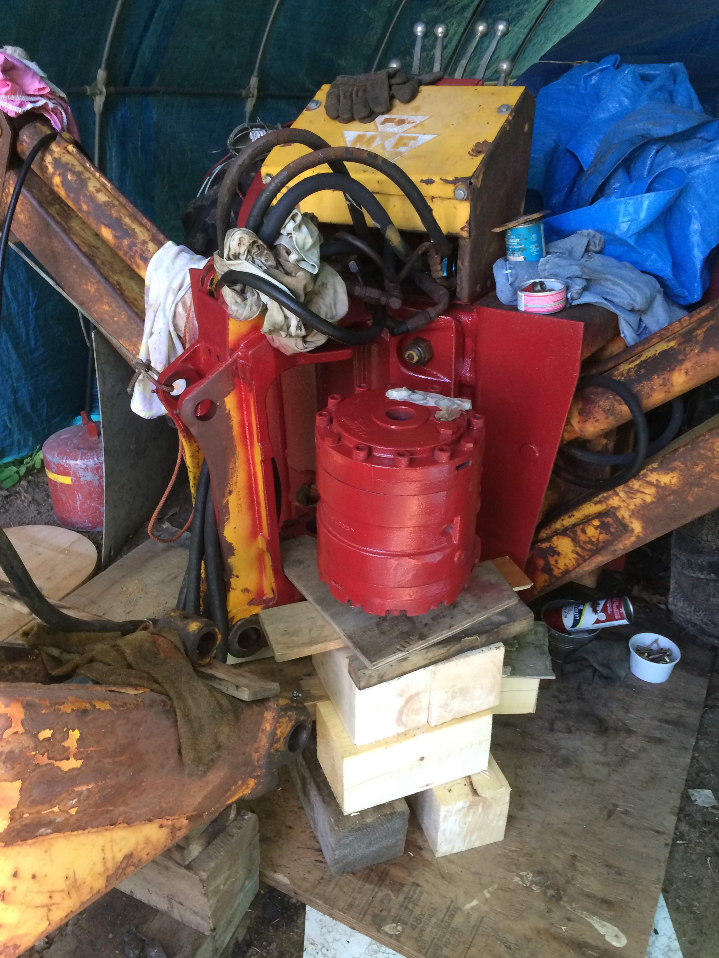

After waiting for a couple of months to figure out how to repair this old backhoe, I now have the parts in hand and will be reassembling it soon. :drink:

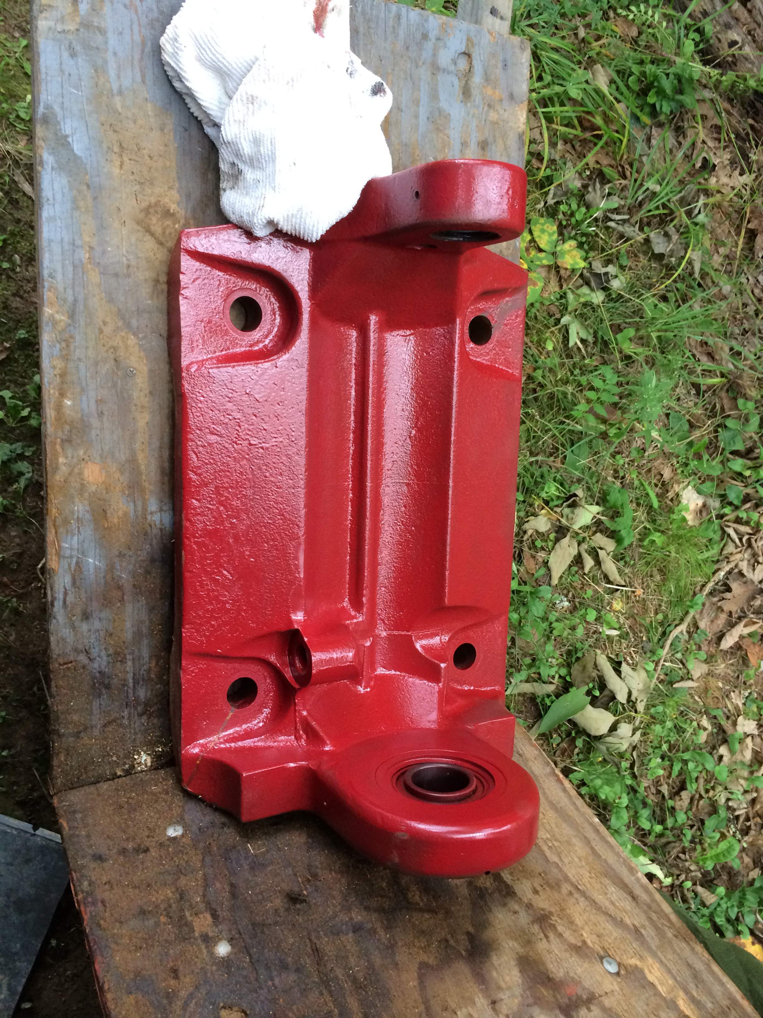

Here's the mast with new bearings. The problem was the upper bearing was toast and the lower was gone, literally. At some point in the tractors life someone had the lower bearing opening machined for a different bearing and that's why the stock one wouldn't fit. The machine shop found a bearing and turned it down to fit the opening. $$$042.jpg
