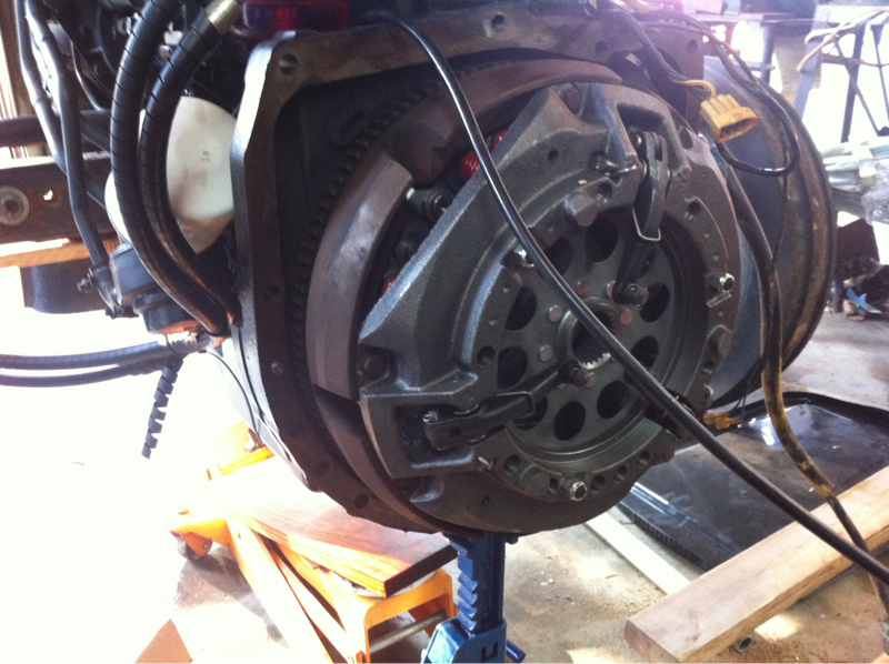

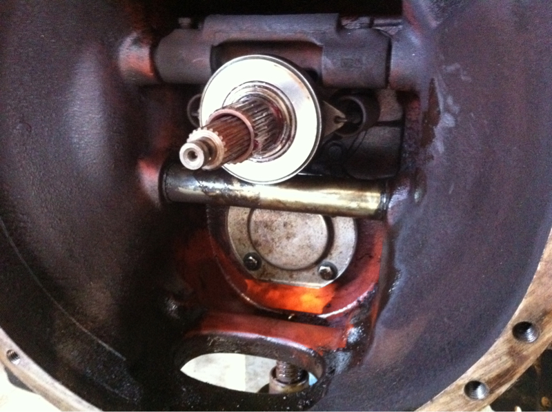

Throw out in and plate underneath re-sealed. Pilot bearing installed, along with clutch, and pressure plate.

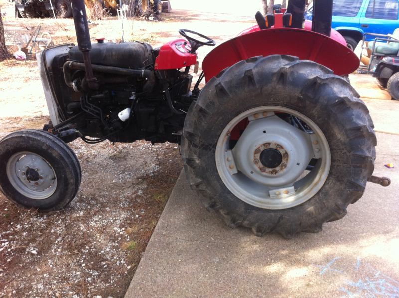

Back together and tested her out yesterday. Just need to get the hood back on.
   / MF 263 #27
Nice, I was contemplating doing the clutch myself on the 240 if it ever needed done.
   / MF 263
#28
It was very easy even by myself using basic hand tools. Only thing I would do differently is make a better stand for the back half instead of a jack stand. Also ratchet straps, gentle persistence, and lots of patience are your friend when lining back up.
