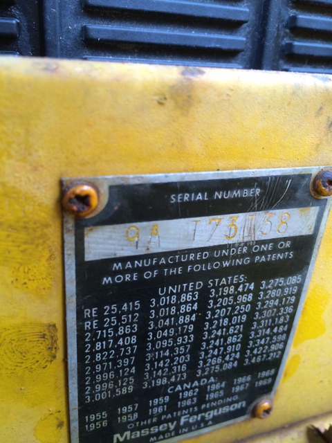

I think I may have posted this in the wrong thread earlier so I am moving it here. Please correct me if I'm not doing it right! I'm new!

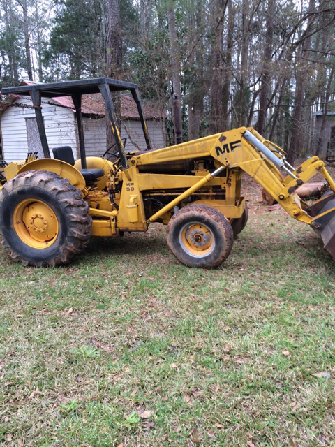

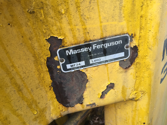

Hello all and thanks in advance. I am looking at purchasing a mf tractor with backhoe and front end loader. It has several issues and I know very little about them. I am trying to determine exactly what model it is, how many hp, engine manufacturer, etc. I know it is a 4 cylinder diesel. It has three foot pedals ( forward, reverse, and throttle) I have found the serial number: 9A T73I38. Does that mean it is a 73? Does this tractor have the Perkins AD4-203 engine? Where is a good place to purchase a rebuild kit for the engine?Again, thanks for all the help!

If it is a Perkins, there should be plate near the top right? of the engine which says Perkins and below that there will be a number stamped on a plate. Then if it is Perkins, call your nearest Perkins dealer and give them the number, they will then tell you what year and model of engine and should be able to supply you with the kits you need.
Or you could get aftermarket engine parts from Bareco but I have found the genuine Perkins parts better quality.
I cant tell for sure what model of tractor you have, it could be a 30 or a 31 or even something else, they seem very similar and there aren't any serial numbers listed there on Tractor data. But I suspect it is a 30 with a 34 loader and a Perkins AD4 engine.
You could call an AGCO dealer and ask them to look up your Massey serial number and they should be able to tell you all about your tractor.

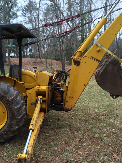

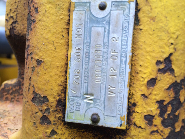

Well I bit the bullet and bought it. Got it home today and played around with it. Runs really pretty good just "smokes" or really sprays oil. Got a couple hydraulic minor hydronic leaks that I will have to fix if I get all the other kinks worked out. Backhoe digs pretty good too as far as I can tell. Where the barrel attaches to the frame of the hoe is cracked which allows for it to bounce around and have lots of slop. The bearings and/or bushings that go in the bottom of the barrel are completely gone. Does anyone have parts breakdown of a mf54 backhoe. So I can see if it looks like mine? Still going to have to figure out what bushings and/or bearings I'm going to need to replace... Thanks again for the help.

You need to go to the AGCO parts books website. If the book for the backhoe is there, then you should find a diagram and part numbers.
AGCO Parts Books
Either try admin as a login or get a free login and password from you Massey dealer.
Perhaps post a photo here of the parts you are talking about, as well.
Good luck with your new machine.
