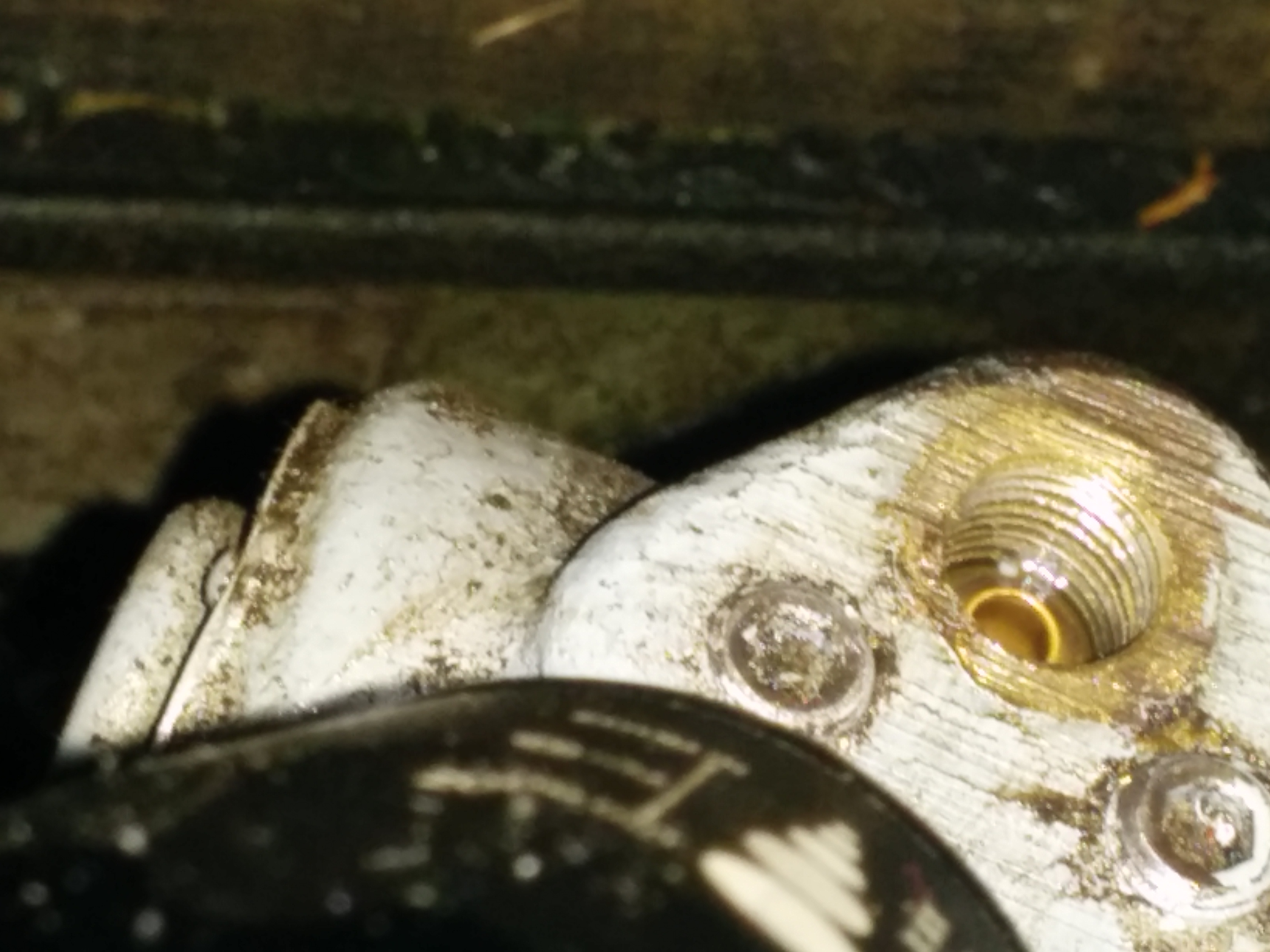

Hi was the 24 tpi an inverted flare with a diameter of 7/16 or 3/8. Just getting around to fixing this line
   / MF 65 with g176 gas engine with cessna power steering pump what are the fittings?
#28
Finally getting around to fixing this line here a pic of port on power steering cylinder assume this would be a 1/4 inverted flare with 7/16 24 tpi thread?
tia
#29
Ok folks just for future reference I ordered 1/4 hose with 1/4 inch 90 swivel male inverted flare 7/16 24 tpi on one side on the other I put 3/8 female jic with 9/16 18 tpi threads. Got some adapters and elbow going from 1/4 npt at pump to 3/8 jic.
