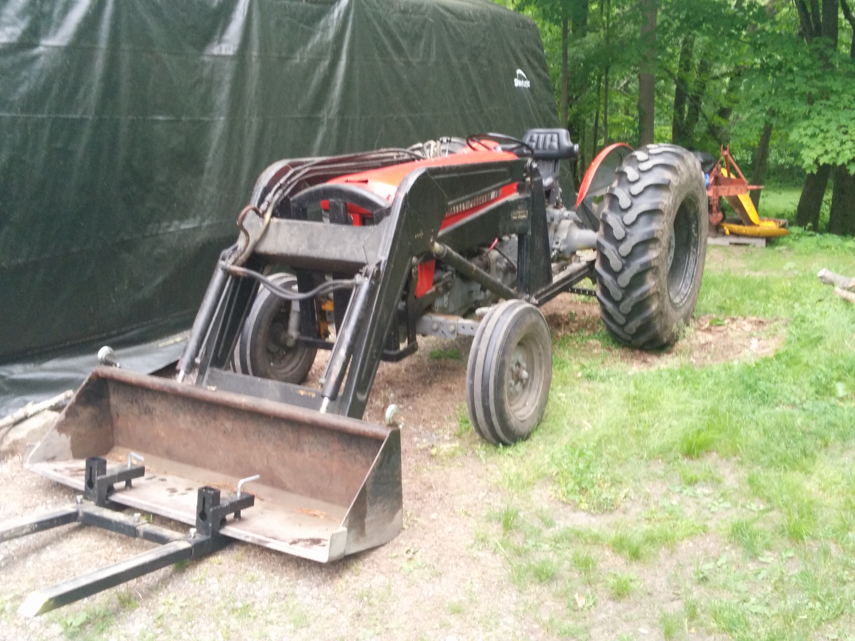

   / MF 65 with g176 gas engine with cessna power steering pump what are the fittings? #16
Here's a pic its old but does what i need it tooView attachment 658408
That's a good workhorse. Some of these old tractors like yours can be going for another 50 years. They are built to be durable and basic machines that are user friendly to work on. Sometimes troubleshooting the hydraulics can be a pain but once you have been through the mill with that section its pretty easy to understand. Keep her running.
My friend up the road has a new Kobota that's cool as ****. Forget the model but its 38 hp. Strong and functional. I would love to have one of those and my 203.
I would trade the new one when it is about 2 years out of warranty because ill admit its more complicated for me to deal with. I've been twisting bolts for 45 years and have fair el4ctrical experience but wouldn't want to get to deep into a new one.
I'm building my 203 to keep until I expire. Its 59 years old and I'm 64. Its a lot more durable than I am. I rolled a toy 203 around in the dirt pile when I was about 6. It says a lot that these machines are still working. Heavy cast iron is my drug.

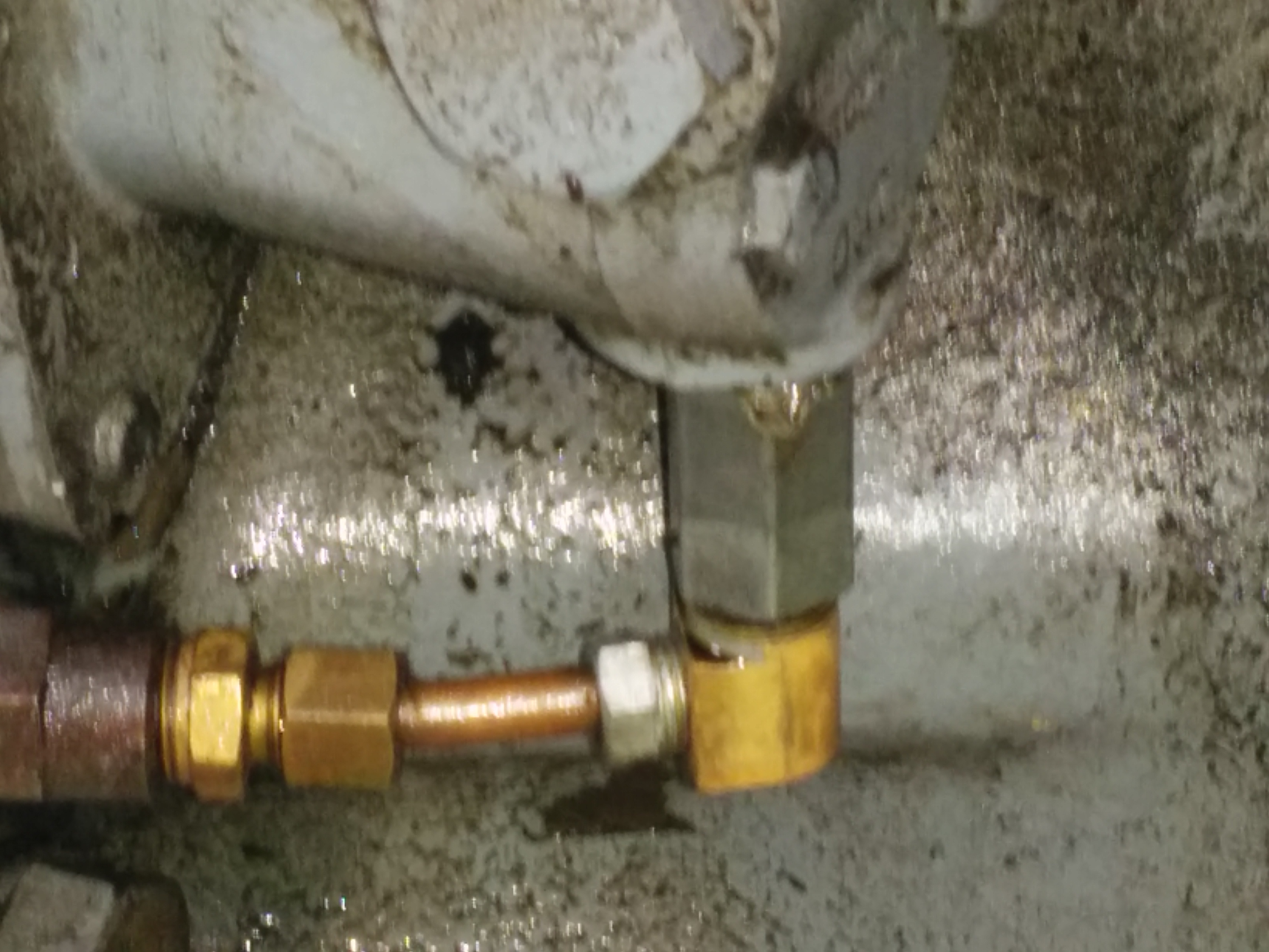

here's my problem
   / MF 65 with g176 gas engine with cessna power steering pump what are the fittings? #18
here's my problem
Your hose looks like its a n.t.p female end. The brass fitting going into the stainless fitting is n.t.p. male going into n.t.p female stainless fitting.
So it looks like you could replace all that copper and brass with All N.T.P..
Is the stainless fitting going into the cylinder brazed in and not leaking? If it is leave it alone.
Does your hose have any slack? If not a short nipple going to the hose and a street L 90 degree going into the stainless fitting should be all you need.
Two pieces. A street L 90 degree fitting and a 3 or 4 inch nipple. I would get stainless fittings.
Any other members please verify my assessment.
   / MF 65 with g176 gas engine with cessna power steering pump what are the fittings? #19
Getting the hose closer to the elbow would be better. I now see that's not the cylinder, its better that its not.
You may have clearance issues with screwing in an elbow
You will also need a bushing in the hose to reduce to match the smaller elbow

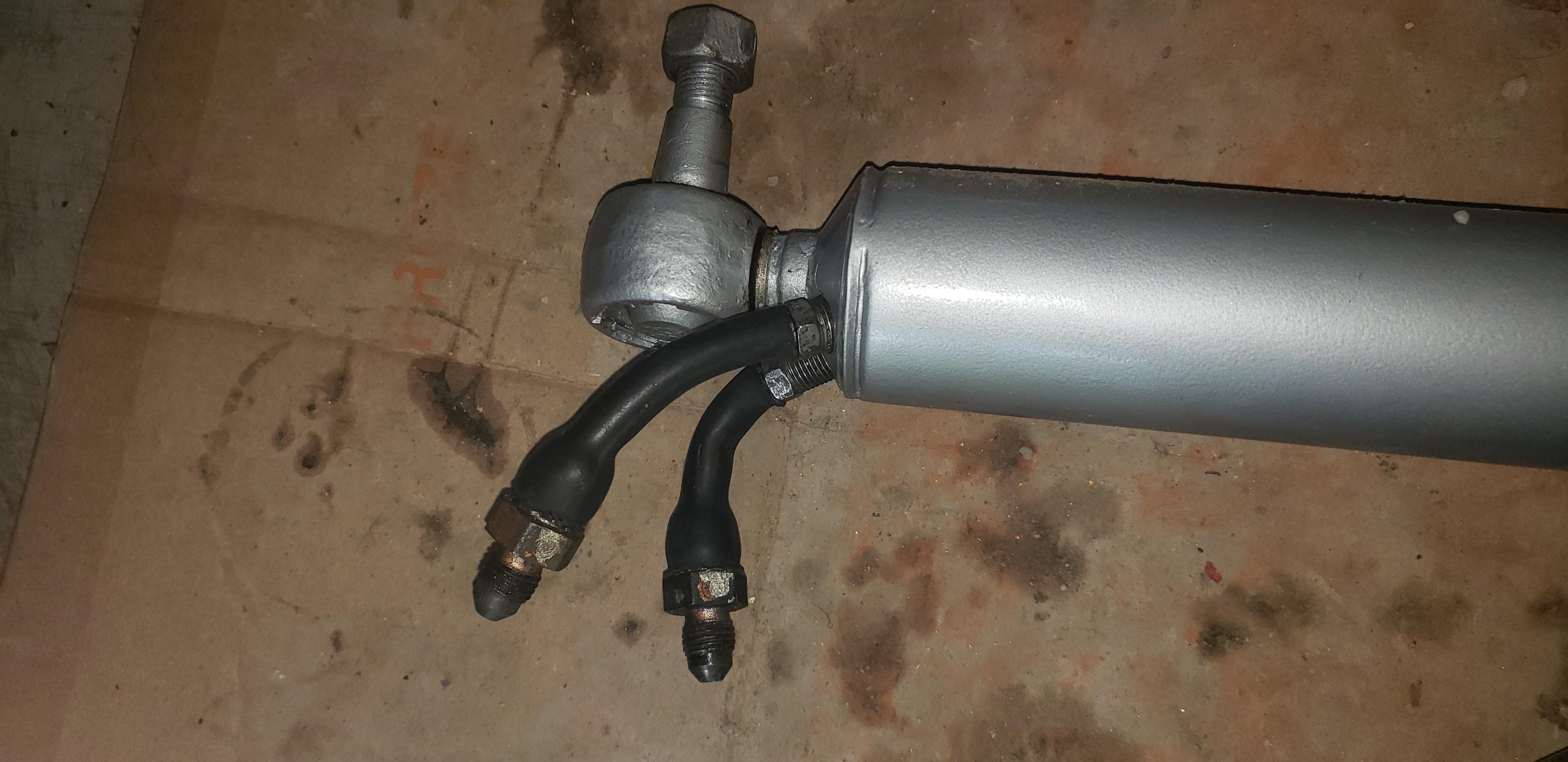

Here's the other end in the cylinder I believe its the low pressure hose on the power steering I was thinking of just getting couple of adapters straight threads to male jics and a 48 inch hose with females jicsIMG_20200602_171518.jpg
