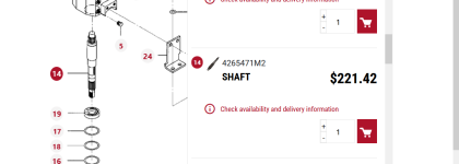

earlier I had posted (since deleted) I was bored and looked at parts list yet could NOT find part number for the center shaft which is different from other shafts.
well thats because that shaft is listed under the bevel case section.
only 3$ difference in price from other 2 shafts. 220 something $ each.
