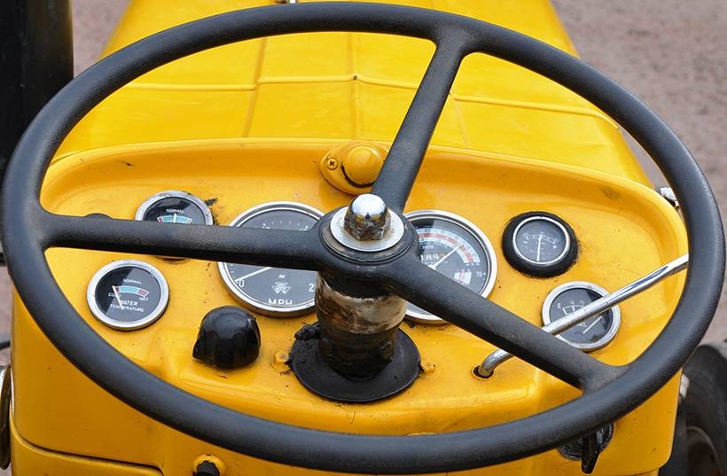

Have the 1968 MF135 stripped for some other work and am slightly puzzled with my Dashboard layout - Maybe the tractor started life as an Industrial version? (traces of yellow paint under the red)
Firstly I seem to have an extra gauge on the dash (the LH big one in the photo below) this is connected via a drive cable to the transmission, but I cant see any photos of a dash layout like this anywhere:

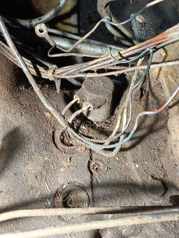

Secondly, can anyone identify what this is with two wires going into it? this is under the battery carrier on top of the transmission:

I do believe it's the safety switch that prevents starting when the hi lo is not in neutral, the gauge is probably a speedometer.

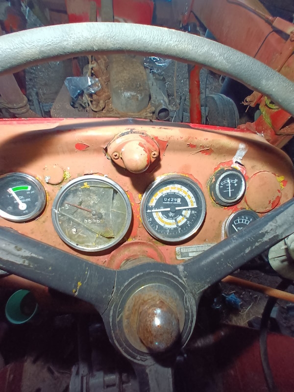

Is there no symbol on the instrument?
/ MF135 - Can Anyone Identify Please #4
You probably have a MF2135, the industrial twin of the 135.

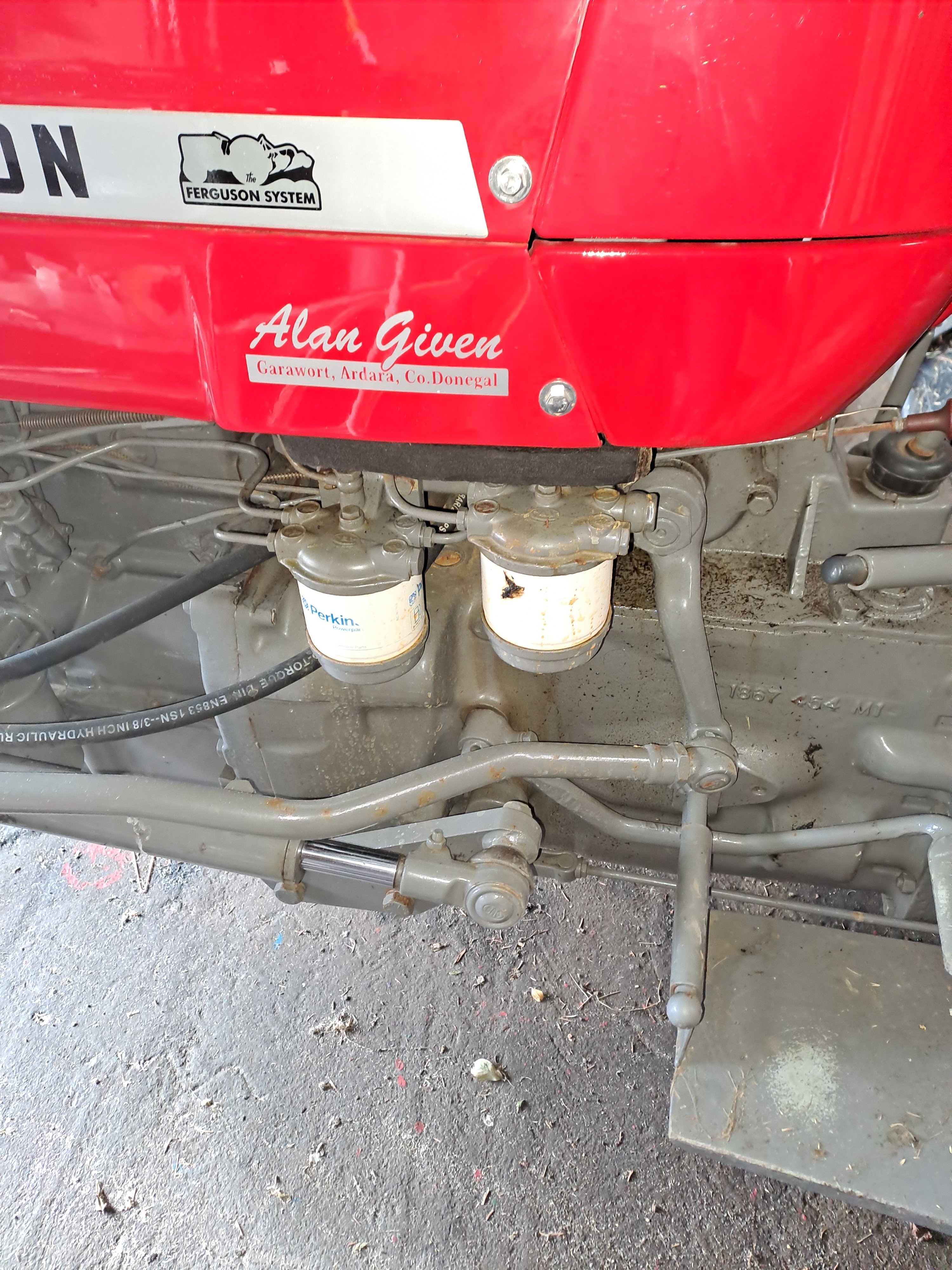

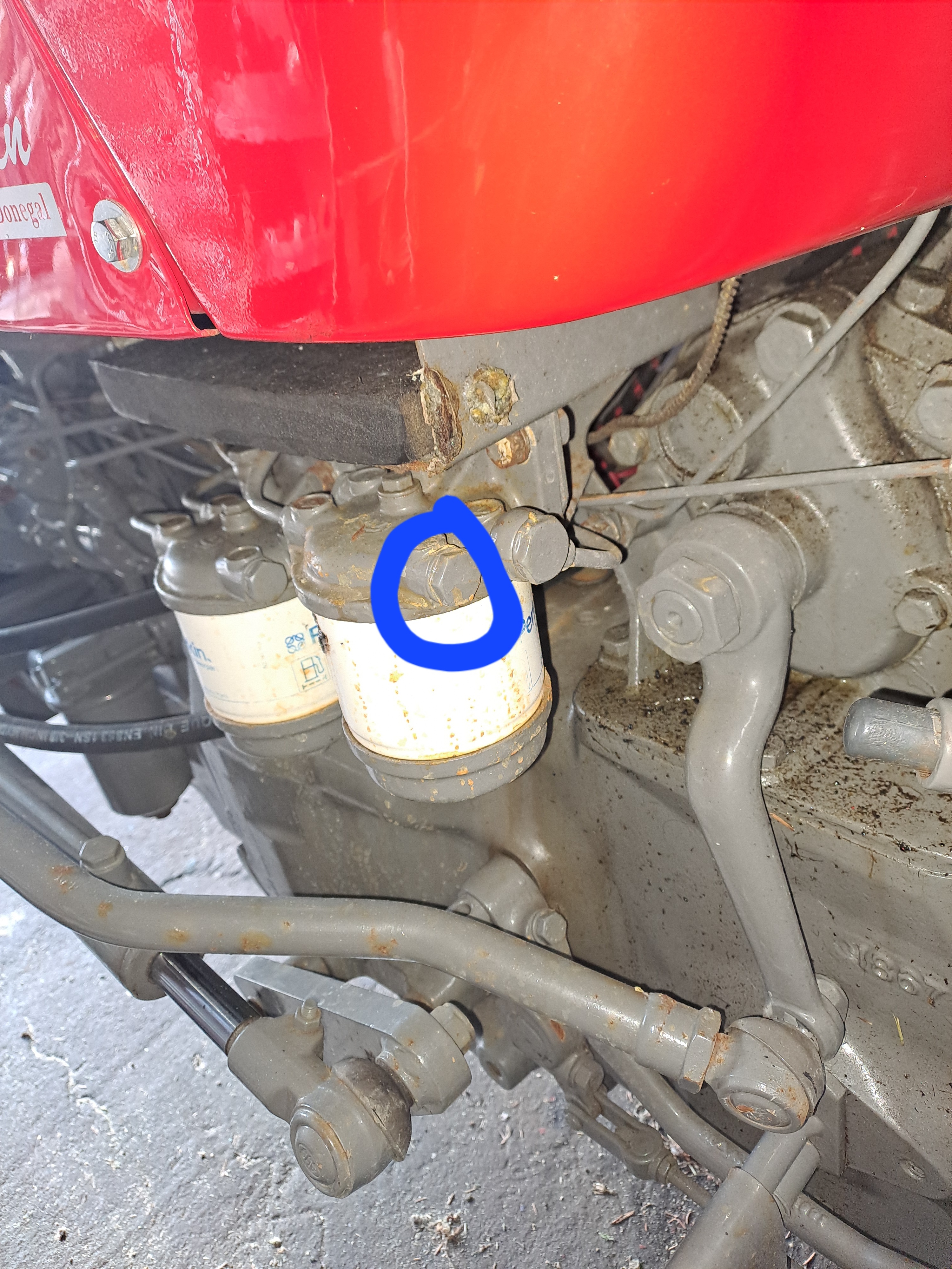

Hello, can anyone identify and tell what exactly this bolt is called or where to buy one . It is on the fuel filter of a massey 135

It's not really a bolt, but a bolt could be used. It's a plug, Massey number could be 731364M1 with a 731364M1 washer. .It is a 1/2" S.A.E. thread, so you could use a bolt if you can find one fully threaded and cut it short enough to fit. Any proper size copper or aluminum sealing washer should work.

Yup, reply #2 is right, it's the neutral safety switch.
Reply #4 is correct industrial version, it's the only one with an external dash light.
