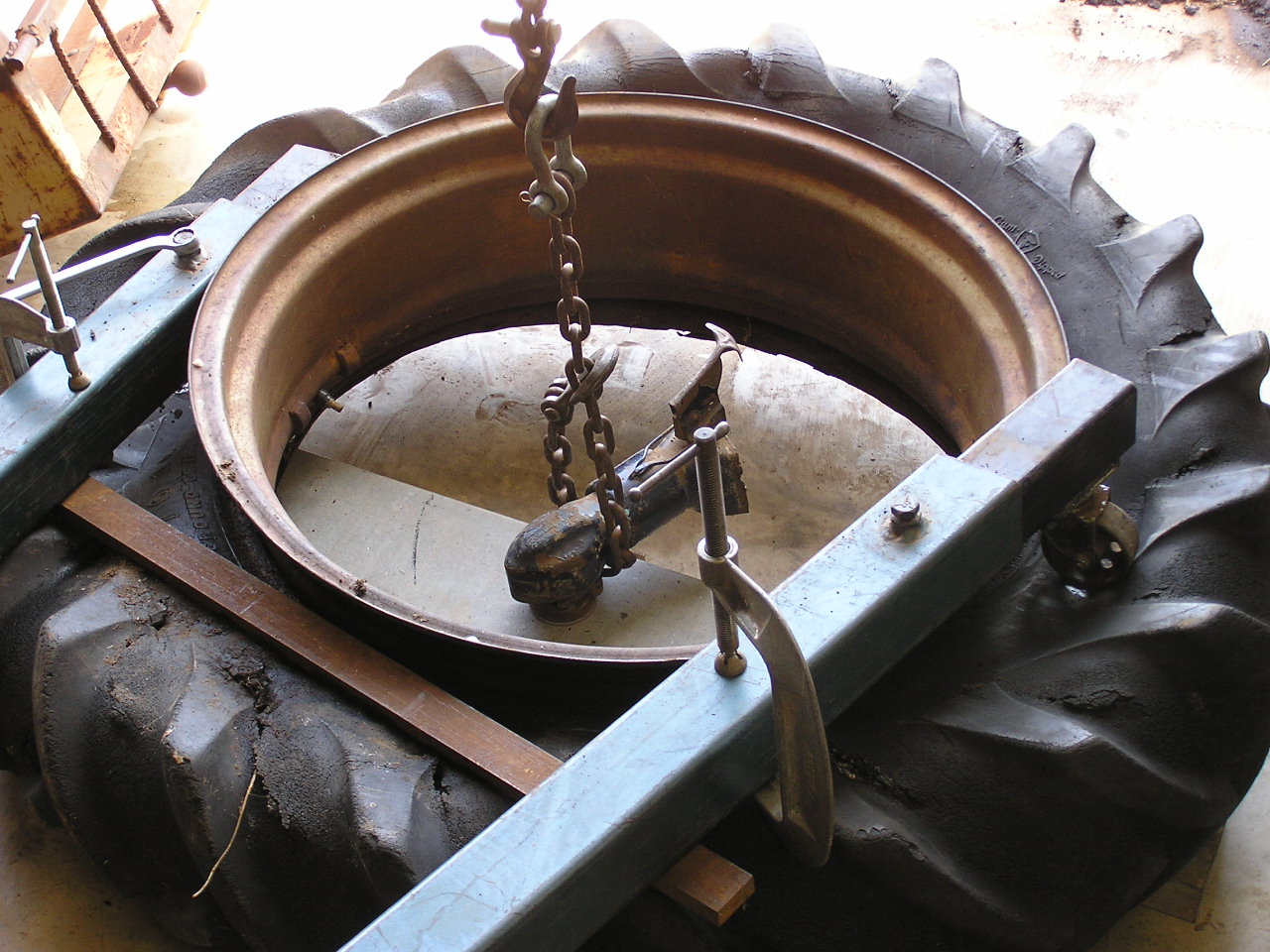

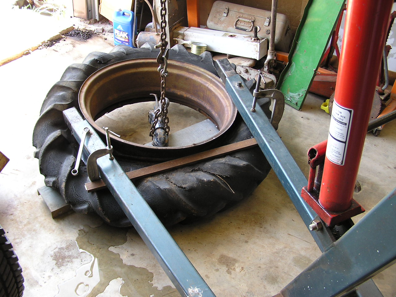

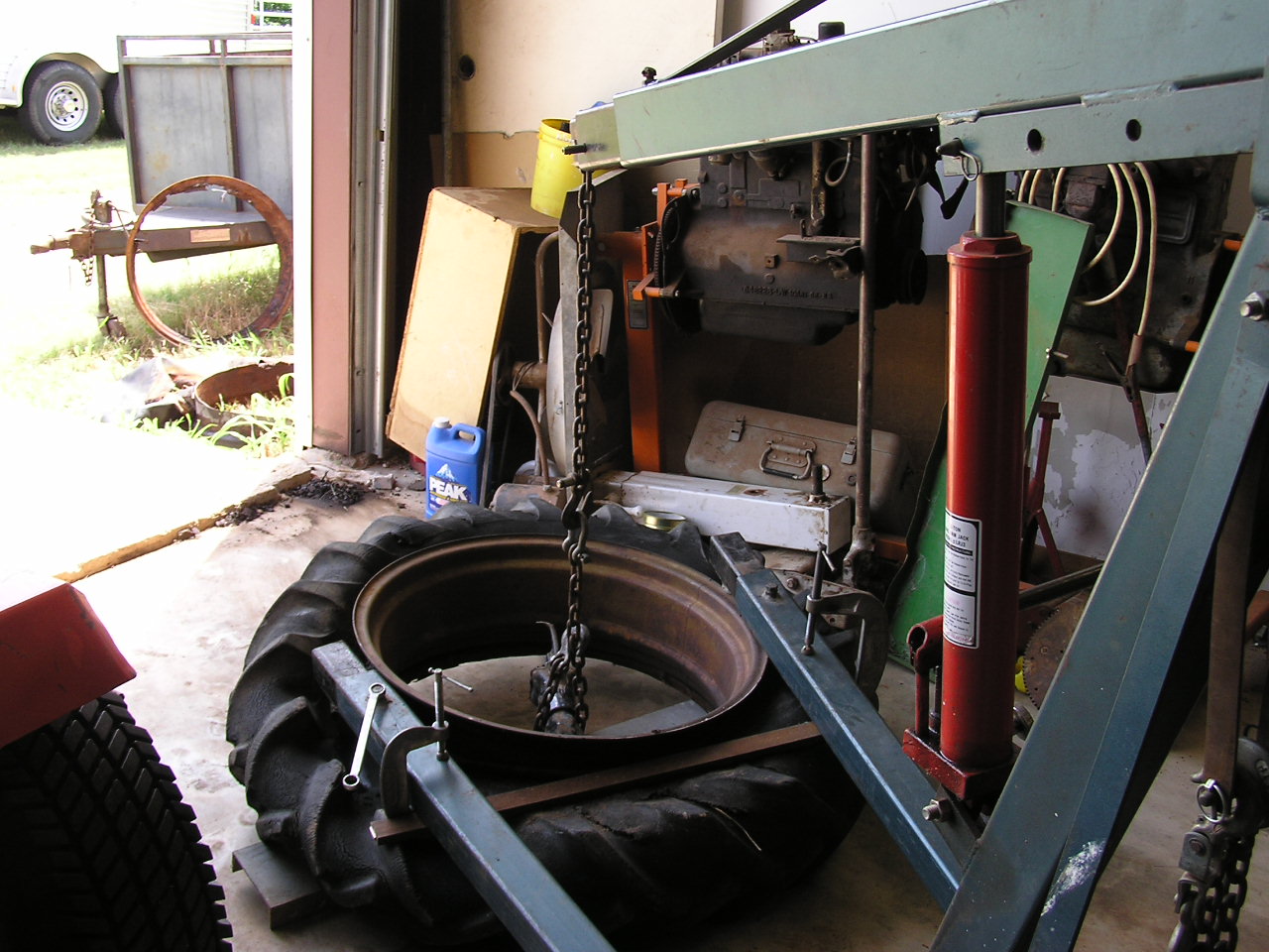

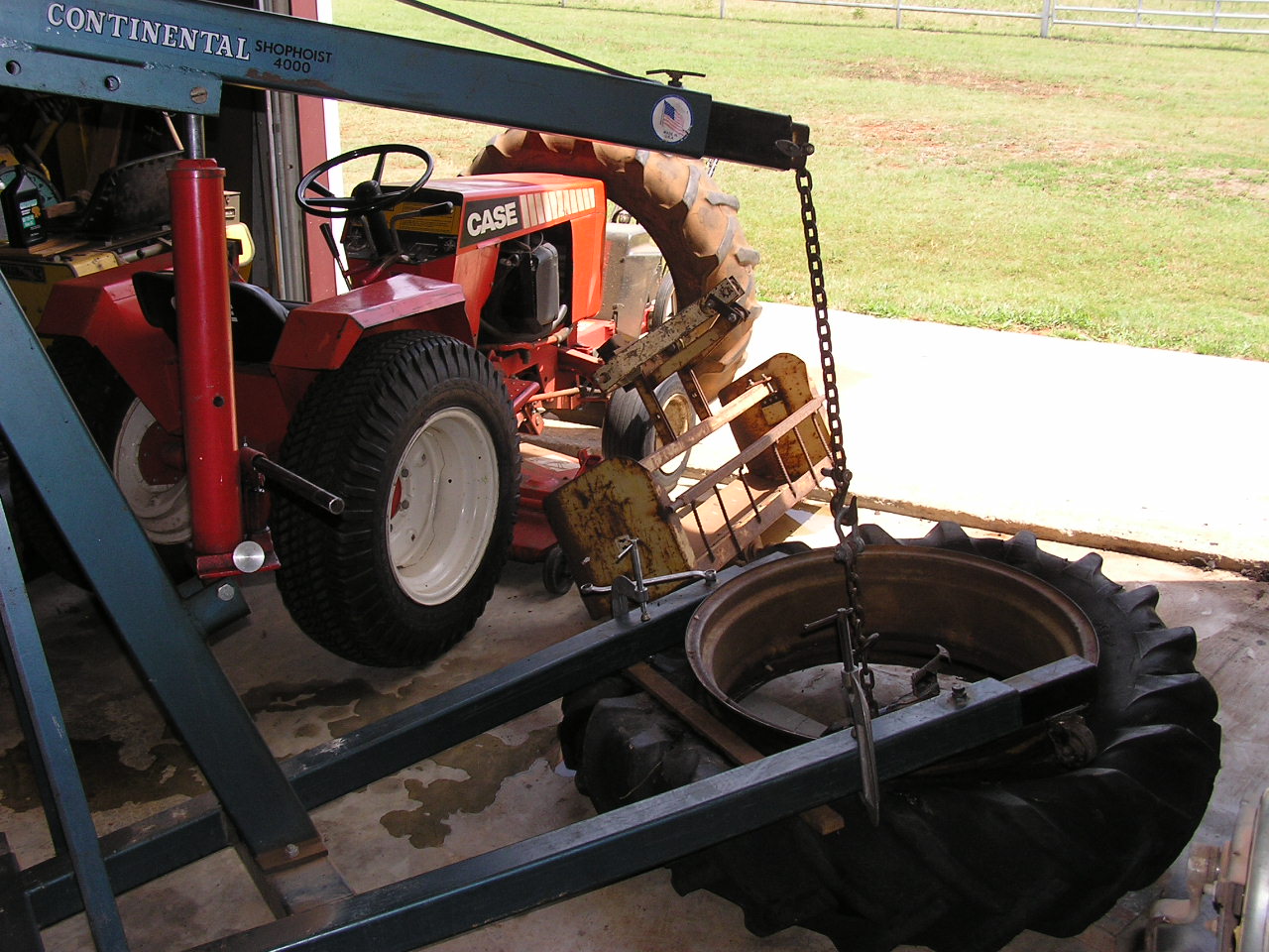

I use the Shop Crane to lift the wheel and move it, same thing I use to break the bead.
   / MF135 REAR WHEEL REMOVAL #16
That's a neat way to put your hydraulics to work.:thumbsup: Good thinking.
Thanks, I wish I'd taken a picture of the setup before I applied pressure, the solid steel bar was up on edge, next to the C clamps, against the bead. It still took a lot of effort on the jack handle! :)
