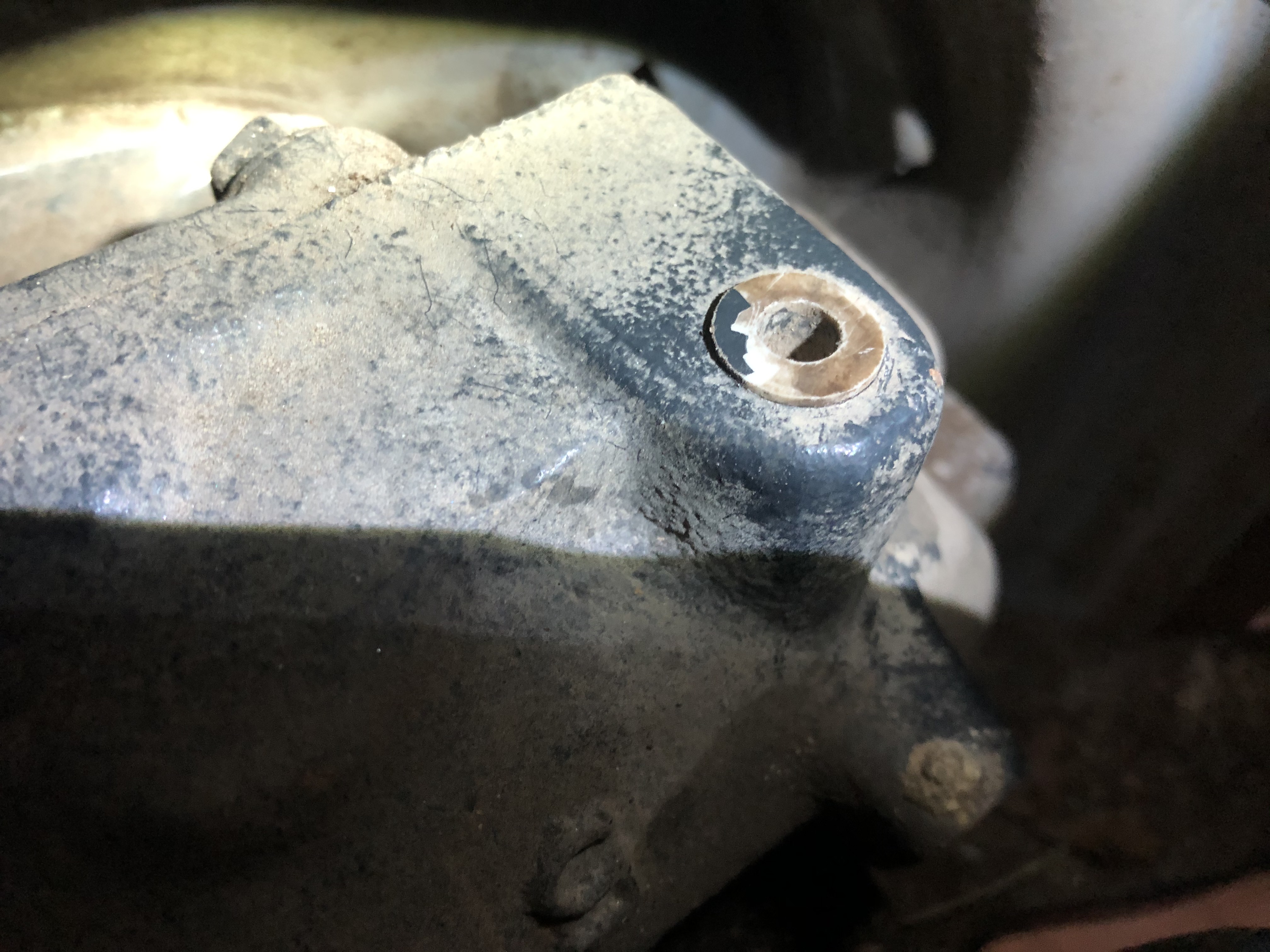

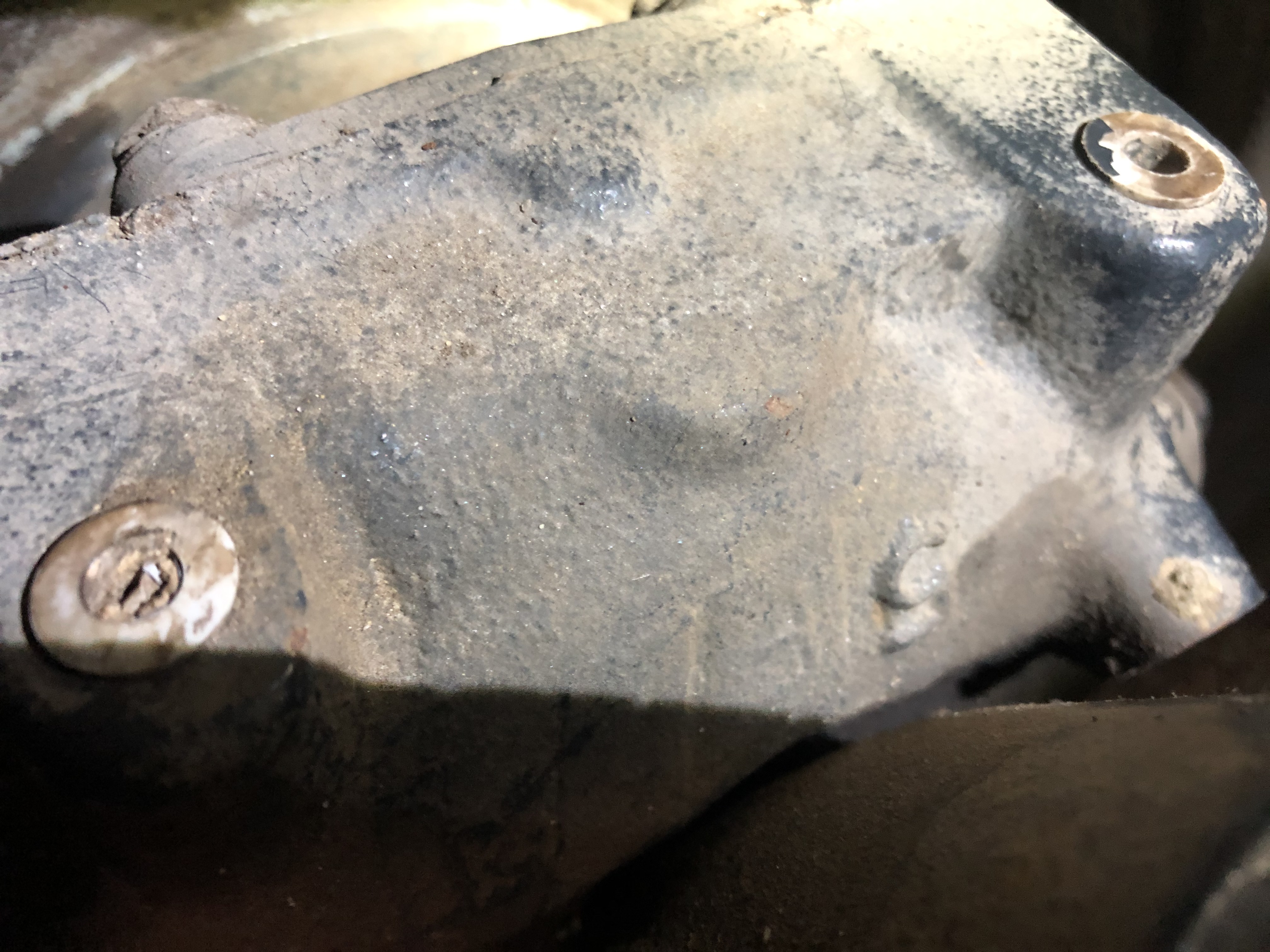

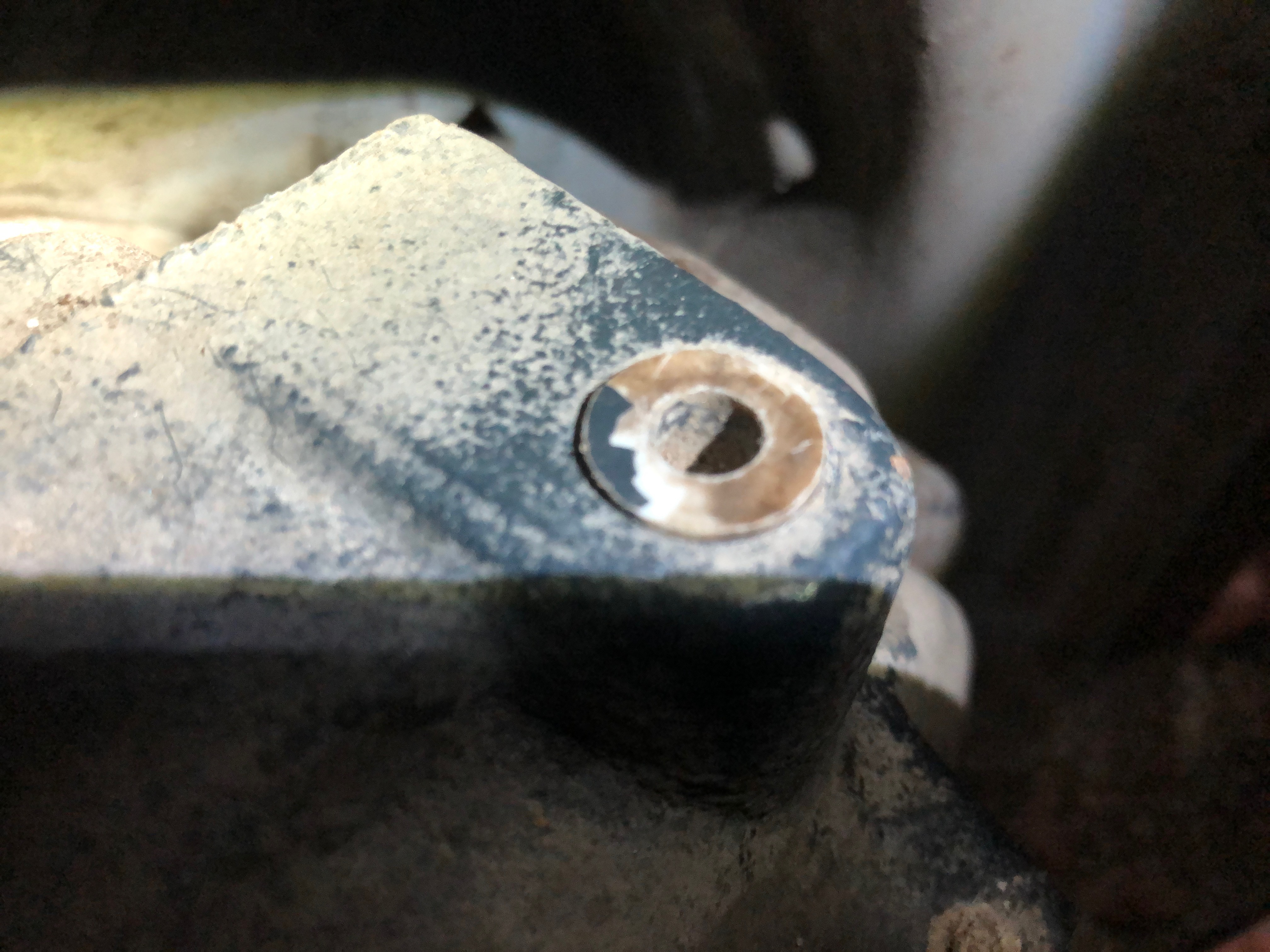

I see it in the pic,on the right.
Better pics.
Are you saying this plastic plug is the fill-level?
   / MF1540 4x4 front axle oil change #15
If I were you I would just look in the large fill hole and fill it until the shaft is almost submerged. That’s what I did for the first 2 years until I got the service manual.
#16
Yep, same recommendation I got earlier.
Thanks for the help.
   / MF1540 4x4 front axle oil change #18
If you get a little too much in it it'll just come out the top a bit. No harm. The fill cap on mine is made to let out overfill.
   / MF1540 4x4 front axle oil change #19
I'm in a similar boat, I have a 2006, the manual has that fill bolt, but jamming my head in there around the loader, it's definitely not there.
#20
I just went with the "fill halfway up the axle shaft" or maybe just a little over that. Certainly not the 7.9 qts it called for…
