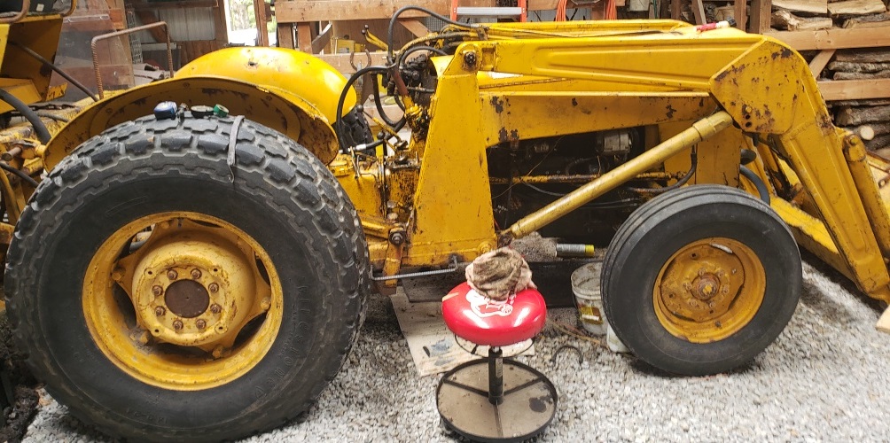

just brought a mf 2135 industrial (9A35824) with 200 loader and 222 backhoe. sat outside for 10yrs. Perkins 3cyl diesel, full hydraulic steering , squared off rear fenders. rear disc brakes Pulled head as engine full of water from open exhaust.
got engine running ok. Hydraulics were cobbled using rear pto for hydraulic power for loader and backhoe. Ive ordered the front pump and driveshaft
Need help/advise with
Replacement hood and side panels where to get one p/ns. 512953m91 available is too short 43" approx. My hood should be 50" long x24"
The loader leaks down when moving the control lever and is dangerous. nas anyone a workaround replacement option to replace.
The lower link that is on the left axle for the 3ptlift is missing. does the axle housing have to be removed to install a new one?
thanks in advance for any help

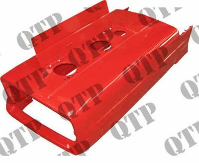

The axle housing does have to be removed to replace the pin. Unfortunately
Your hood may be a two piece hood. A short section over the battery. cI'm guessing but some M.F. did have two sections. The 7" remaining between 43" and 50" doesn't seem wide enough the battery section though.

See the two extensions on the rear of this hood photo.
There's your missing length.

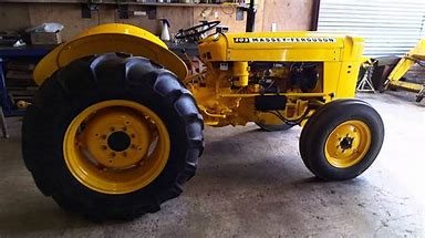

This is a photo of a 203 without the backhoe and loader.
I have a 1962 203 backhoe loader. Its in progress. In pieces but going forward.
Ill measure my hood and side panels tomorrow if you need.
Other members may be able to give other options to ID it. Casting numbers. ??

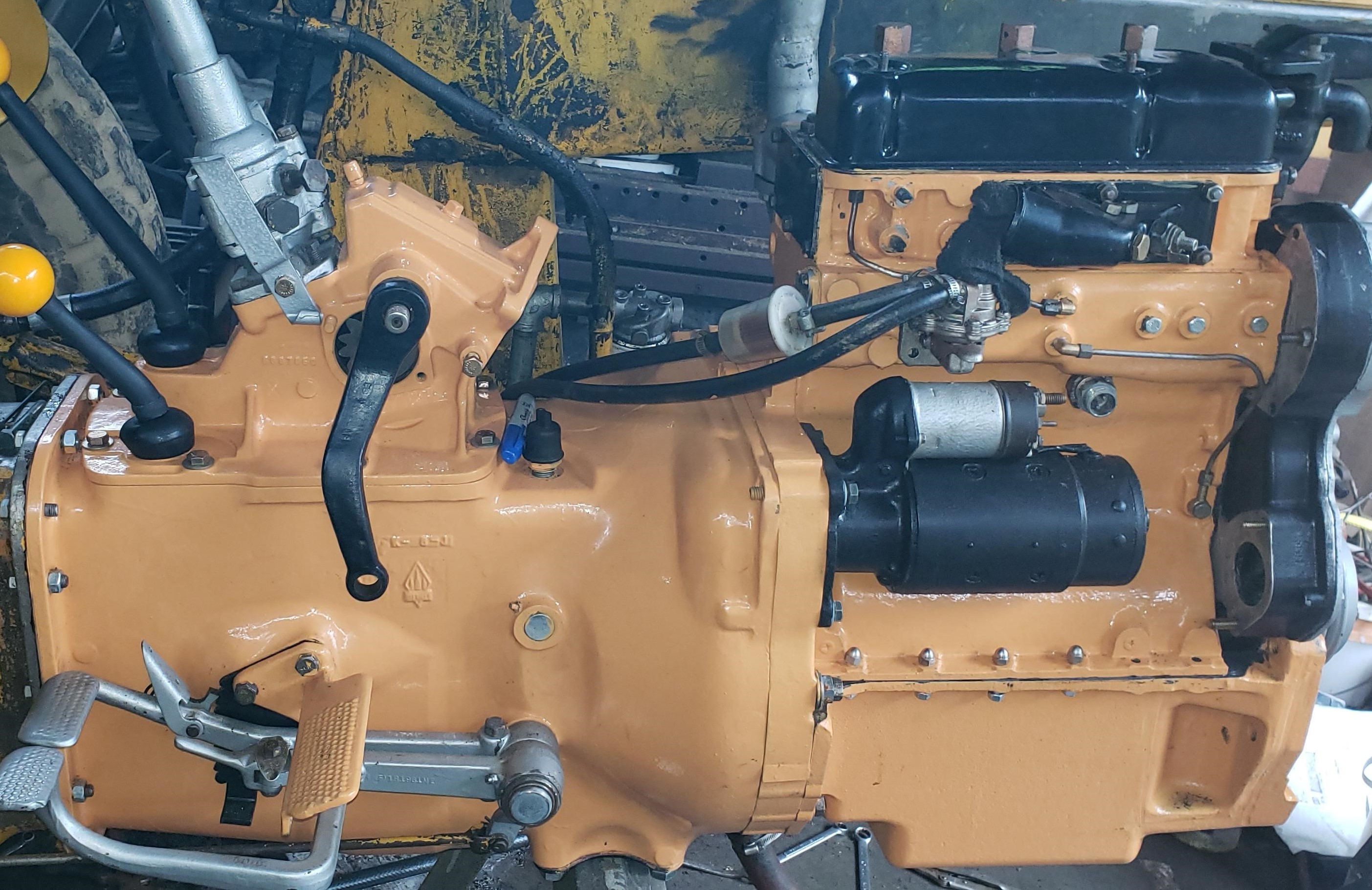

my progress.

I'm learning mine inside out because it was used hard and the engine failed. To show how things can get changed . If the square fenders were less expensive I would have ordered a new pair for my 1962 203. But I ordered the clamshell type.
One good thing is that there are a lot of fairly inexpensive parts for these models. I just completely rebuilt my engine and put all new gears and bearings in the transmission for less than $1,500. Parts and about $350 in machine shop work.

Let me throw some more into the mix. It has the 203 type grill, manual shuttle lever on lhside dash, single stage clutch, pto lever is engage/ neutral. brake pedals that pivot below the footplate and operate disc rear brakes via rods. it has a floor mounted throttle and dash mount lever inter connected. The steering has no mechanical linkage to the 2 steering cylinders mounted on l&r side of tractor . The steering valve is contained under the dash sheetmetal above the cylindrical air filter housing. The front axle is solid with 1.5" dia spindles. It has the 3pt lift and as mentioned the previous owner ran the hydraulics off the pto fed to the front bucket valve set and split off to the rear hoe and power beyond is used.
