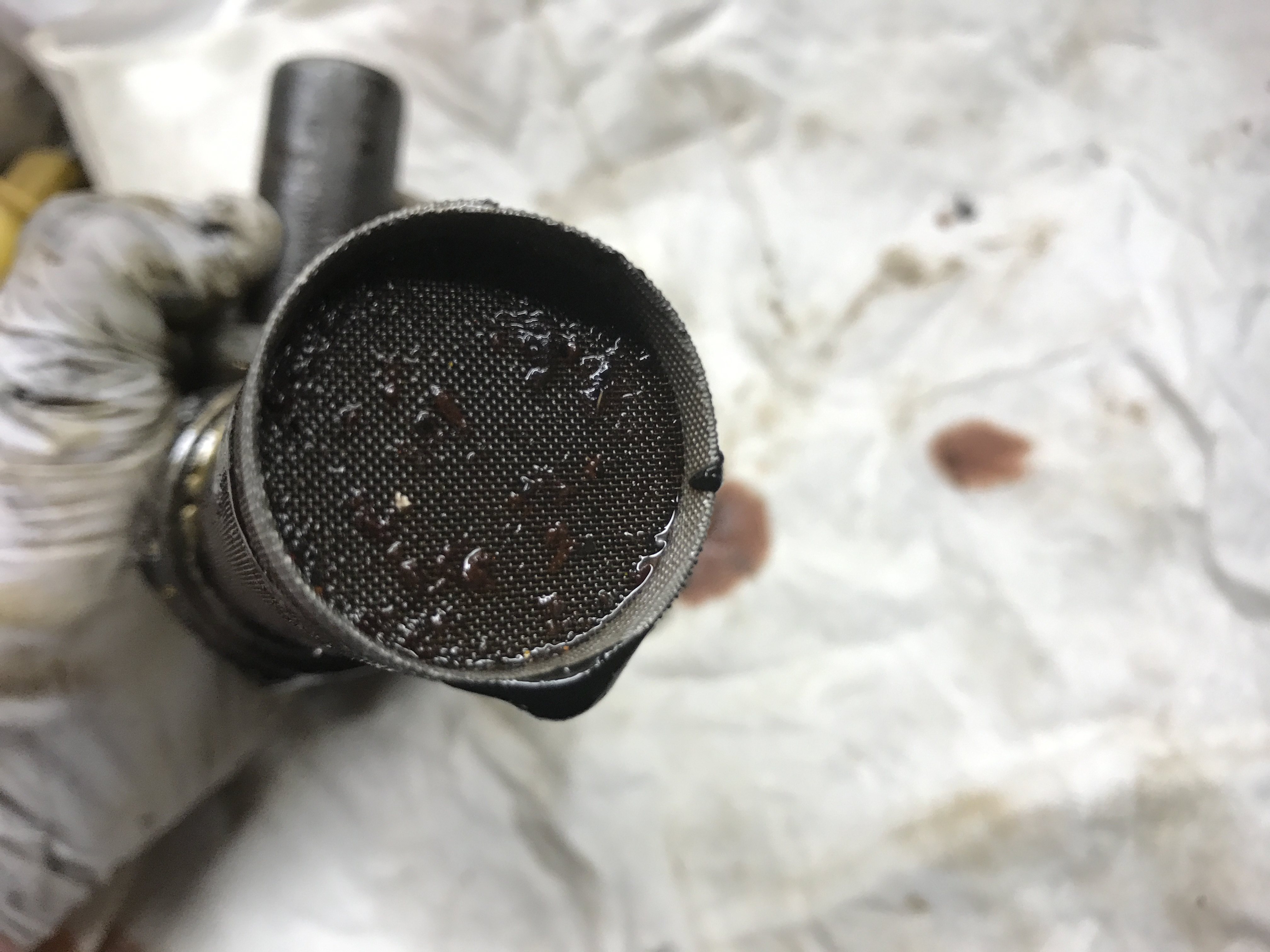

I have the tractor back together now and ran it last night. When I raise the loader as far as it will go, the screaming noise is not coming from the relief valve. It's coming from the hydraulic pump up front. Does anyone know if that's normal or not?
I had convinced myself that the weak lift was due to a lazy relief valve by now I am not so sure. My next step is to drain the existing fluid and find and clear that screen you all mentioned. The current fluid is red and looks relatively clean but I have not changed it since I got the tractor ten years ago and also don't know if the previous owner ever changed it. I plan to check specs on AW46 or AW32 hyd oil to see if it meets the "MF Spec M1110" that Patrick mentioned.
Two questions:
  • is there no drain plug in the loader frame to drain the oil? I looked under there and did not see one.
  • to get at the screen, do I just remove the hose from the bottom of the loader frame reservoir? Is it just sitting right there?

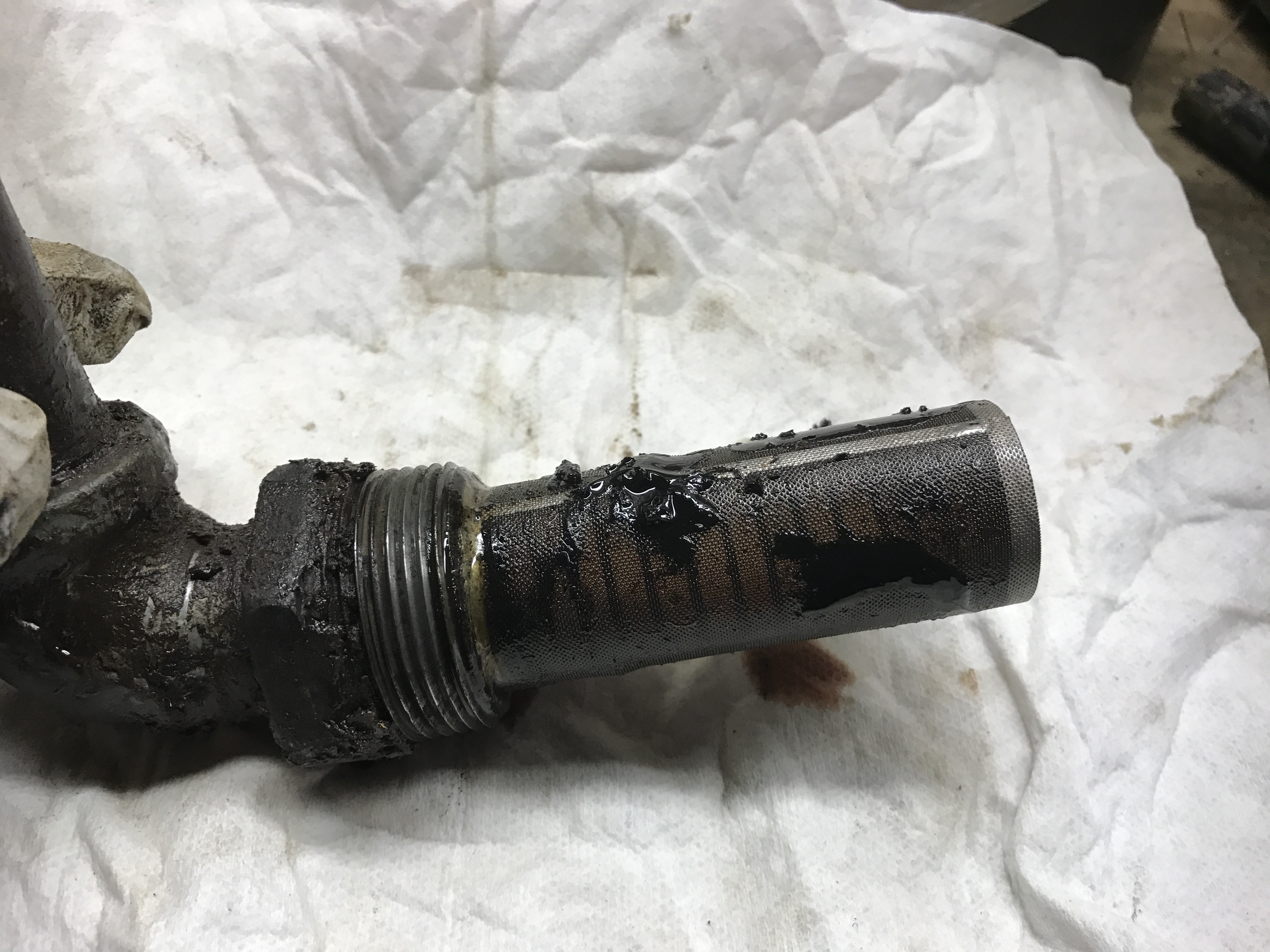

On the 99 loader there is no drain plug. You'll need to remove the lower suction hose from the barbed fitting, then the hex shaped adapter that goes into the reservoir. The screen should be right in there. I'm planning to drain and refill mine before winter, it had lots of water mixed in when I drained it the first time. I run the UTF from Tractor Supply in my loader, seems to run fine.

Bmiszuk, that screaming noise sure sounds like cavitation caused by a restriction in the oil supply. Does it seem to get worse after working (including driving) the machine for some time? Also, does it seem more pronounced at higher revs compared to when the engine is idling?
It may be as easy as washing out the pick-up screen and the reservoir! ;)

Not so much when it's warmed, but more about after it has run and moved about for a while. Remember the pump will be circulating hydraulic oil through the pick-up screen, filter, pump, valve block and back to the reservoir continuously. The only time that changes is when you move a valve to use the bucket.
This oil circulating and tractor movement will do two things:
1. Slosh the oil Front-to-rear in the reservoir, stirring the sludge and other impurities off the bottom; and
2. Allow this to be sucked against the pick-up screen, progressively blocking it.
The possible results I would expect:
1. Slower movement of all bucket actions, and increasing engine (and pump) speed makes no or little difference;
2. Increased howling (cavitation) noise as more of the pick-up screen becomes blocked;
3. Lifting strength may be reduced. That's what happened to our 135 with the 3PL pick-up screen (and gearbox oil) - was weaker and took 30-45secs to raise - except there wasn't any audible noise at all.
It's going to be interesting to find out what's in the bottom of the reservoir! :laughing:
Don't discount the possibility though that the noise is only caused by a worn bearing in the pump. :rolleyes:

The screen has some gunk on it but it wasn't too terrible.

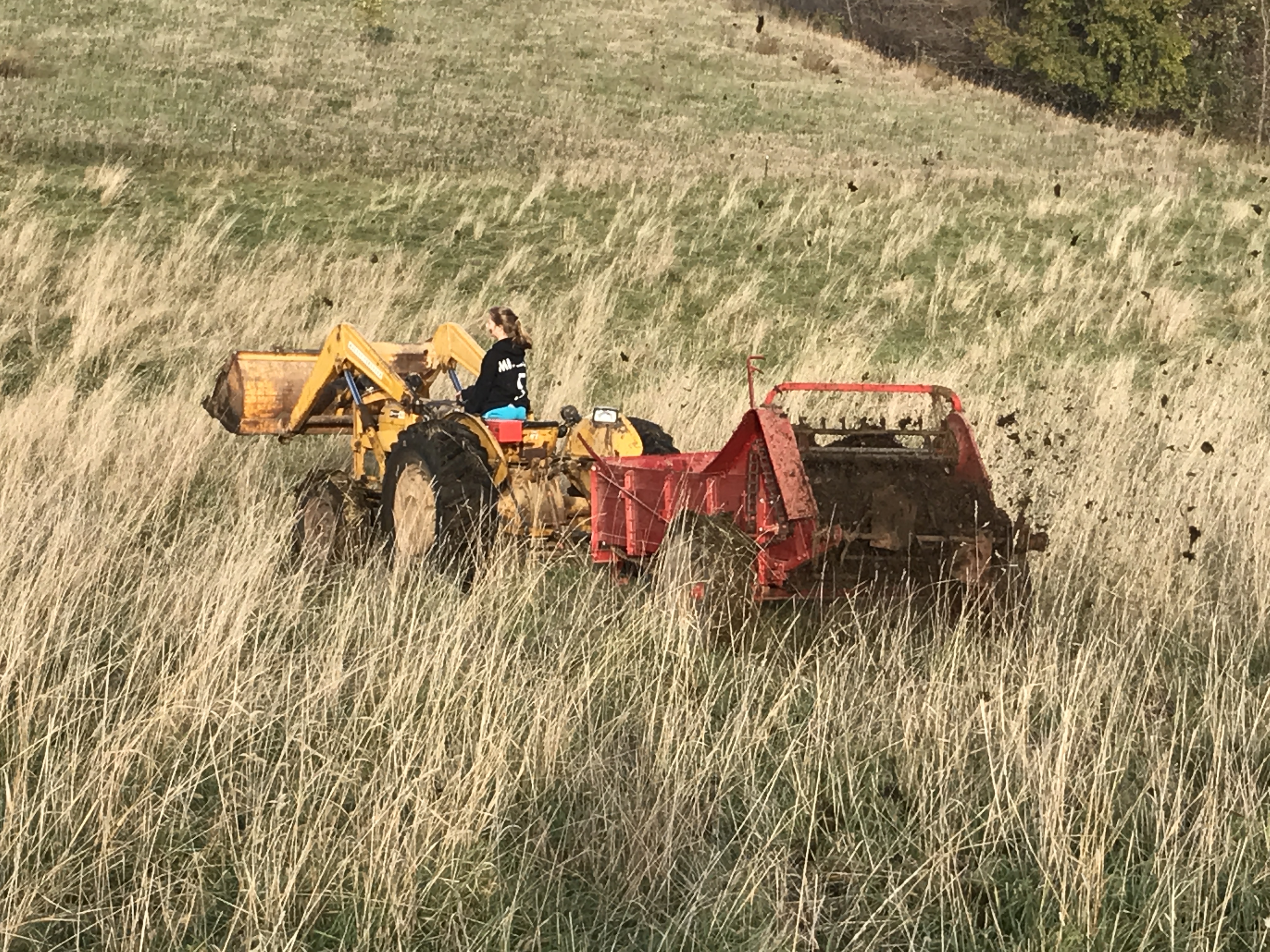

BTW, yesterday we cleaned up the feed area and spread 5 or 6 spreader loads of manure. A 55 year old tractor pulling a 60-70 year old manure spreader :thumbsup: The spreader is a David Bradley that was given to me as junk a few years ago. My daughter and I rebuilt it last winter, replacing all the wood and giving it a fresh coat of paint. It works very nicely for what I need.

Great pics - thanks, seeing it makes things a lot easier than imagining!
That isn't a lot of matter on the screen - but I wonder if it has dropped off while the tractor's been parked and you've been removing the oil pick-up? There's not a lot you can do about it though.
The matter on the screen was actually SOLID. It was like a sealant that had dried on the screen or something. I had to gently clean it off using the wire brush in the grinder.
I then put the screen back on and put some new hyd fluid in the reservoir, ran the tractor, moved the loader up/down and tilted the bucket. Drain the fluid, cleaned a little bit of foreign matter off the screen. Repeat. And repeat again.
The last time I did it, the fluid still had a slight red tint to it (from the old fluid) but there was absolutely no evidence of sludge or crud or anything on the pickup screen.

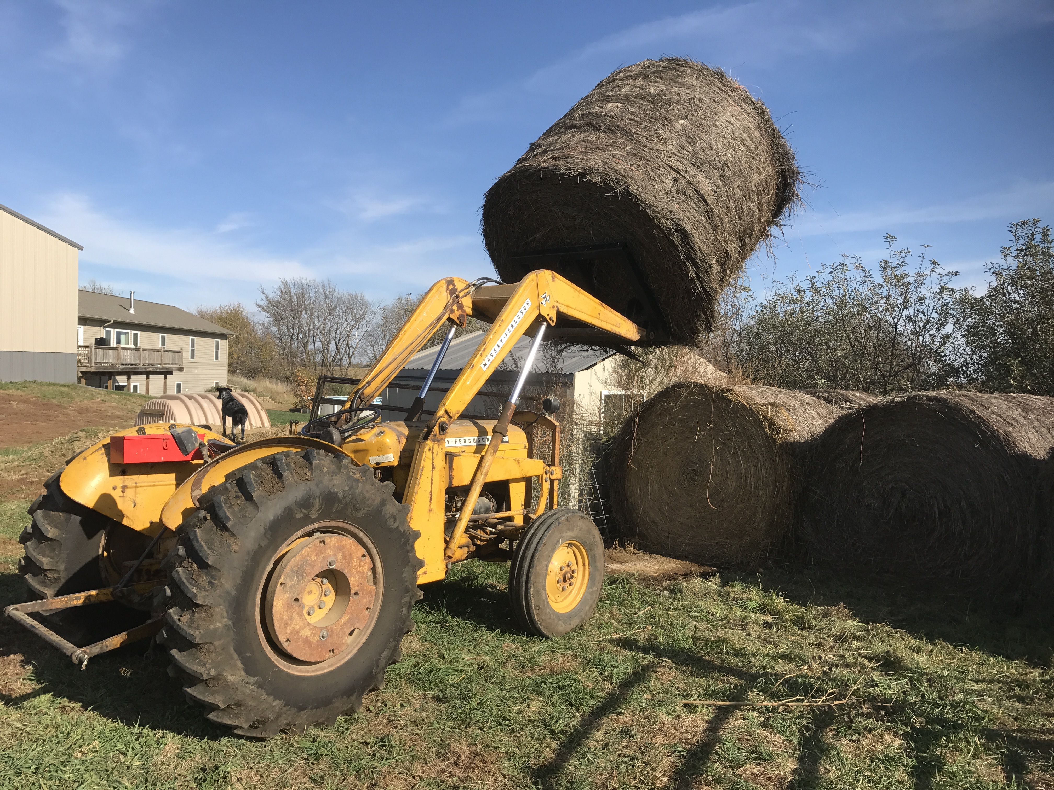

I refilled it with new Universal Tractor Fluid from Bomgaar's and exercised the hydraulics until all the air was out. I think the next pictures tell the story best of all!
   / MF35 Utility - repairs for winter #39
I don't remember if your loader has a bale spike or not but if you have just forks please be careful lifting a bale like in the first picture. My uncle spent several days in the hospital after a bale rolled down the loader arms onto him.
I really like the fact that your daughter spreads manure. Those kind of experiences are good for every younger person to experience.
pmsmechanic, can you look at the bale spear pictured in the very first post of this thread and let me know if you think it could be a problem? Did your uncle have forks attached to his bucket only?
I think it's good for them to experience it also. I walked along side her virtually the entire time to make sure she stayed safe. What's amazing is that she even thinks the manure spreader is a pretty neat machine :cool:
It sure is good to get the kids off their cell phones and outside for a while to see what the real world is like ;)
