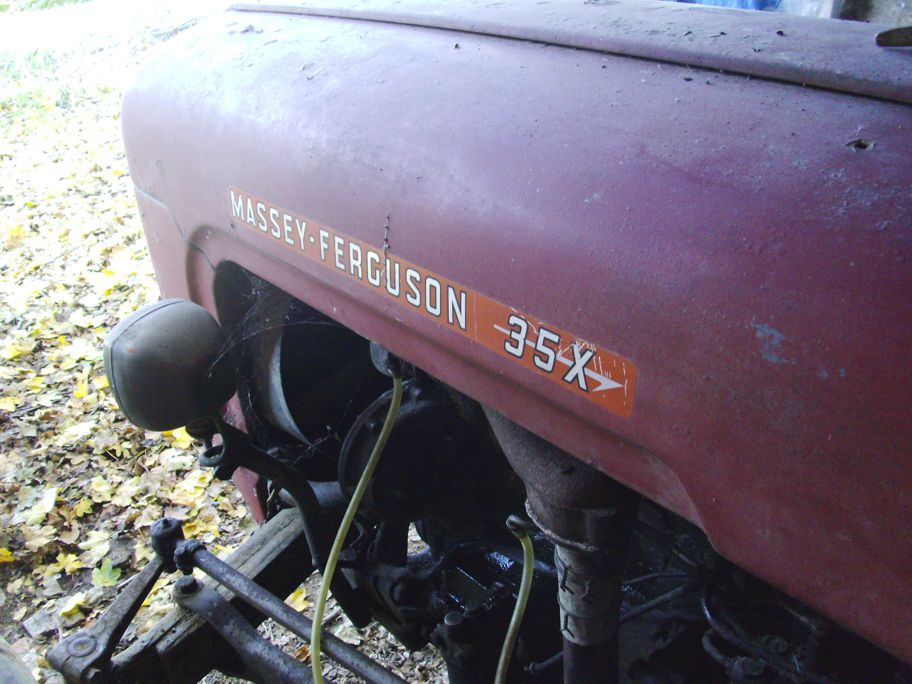

Hi all!

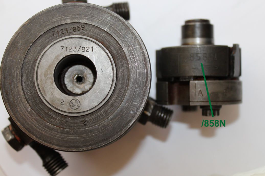

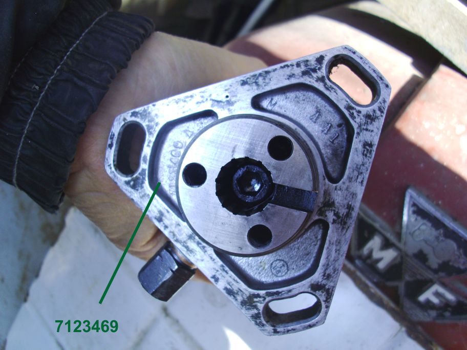

The rotor head of the injection pump of my tractor Massey Ferguson 35X is broken.

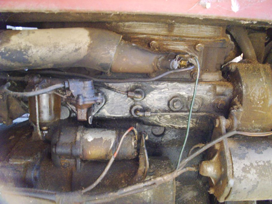

I壇 like to buy another rotor head or another pump (CAV/Delphi) but I don稚 have the article codes or the serial numbers of the rotor or of the pump.

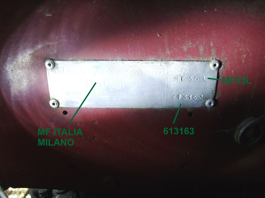

Could someone help me to find these codes/serial numbers from the attached pictures?
Where is the original MF 35X serial number?
Is the engine a Perkins A3.152 or A3.152 advanced? Where is the location on the engine Perkins serial number/code?
Is the pump DPA3230F030 o DPA3232F788?
Is the rotor head 7139-235, 7180-589N or 7170-226N?
Thanks in advance! 01_Trattore_.JPG02_Trattore_.jpg03_Etichetta_Trattore_.jpg04_Pompa-CAV_Delphi_.jpg05_Pompa-CAV_Delphi_.jpg06_Motore_Perkins_.jpg07_Rotore.jpg

The pump is a CAV style pump. A specialty diesel shop should be able to help you with the broken pump. I cannot tell by looking at the photos what engine you have, however if the injectors are straight up in the head then the engine is a A3.152, if the injectors are angled then it is a AD3.152. The A3 is a indirect injection motor, and the AD3 is a direct injection motor.

The injectors are straight up, so the engine is a A3.152, but I've read somewhere there are are 2 versions of this engine, one standard and one advanced.
In this web site there are N.2 pumps suitable for that engine, 3230F030 and 3230F180, so I have to understand which is the one I need....

I'd give them a call, and give them all the numbers off the injection pump, if they are good they should be able to tell which pump you have/need.
