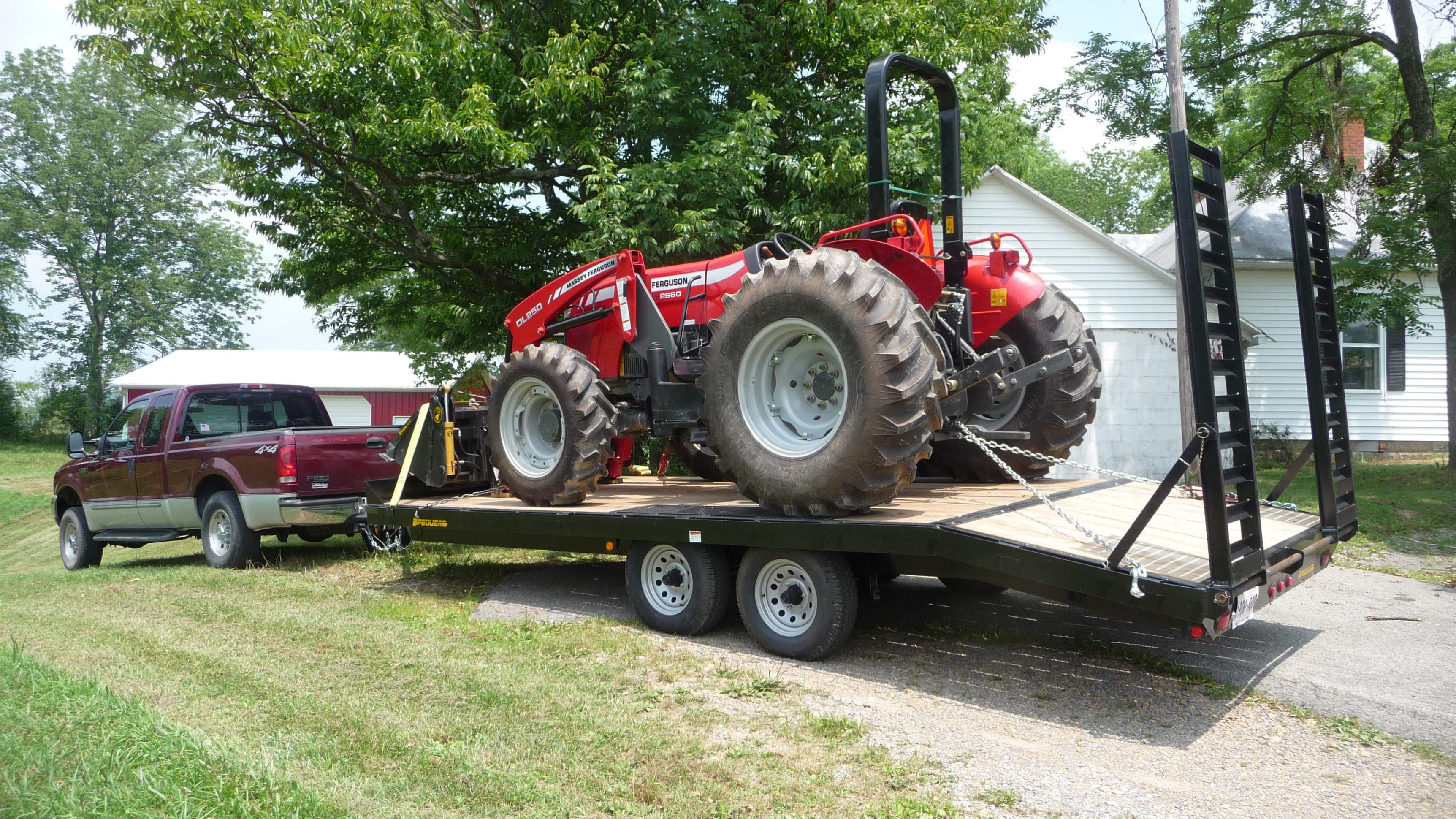

I own a MF 4610 for about 8 months now. I bought it from a JD dealer with 96hours on it. In some ways it has been a great tractor, but it is not perfect.
Here is a list of pros and cons from about 150 hours of use, mainly with loader work or round baling:

Actually, the JD dealer did give me the prior owner's name and phone number. I talked with him but he didn't have much to tell me. Said he used it to move bales and run a round baler, but then needed a new round baler. Ended up getting largest round baler JD makes, and told me the 4610 was too small for the baler. Also, he was paying interest on it, while JD had 0% interest, so the JD dealer worked him a great deal on the big baler and about a 120 or 130 horse tractor. I got it for about $10k to $12K less than new price, so he had to lose money.
He wouldn't tell me any specifics of what liked or didn't like on the 4610.
I also talked to the MF dealer where it was purchased. He said the first buyer had never called him one time with any problems or complaints. He even went over to the JD dealer, picked up the 4610, took it to his place and put three factory updates on it and changed the oil for me, and then dropped it back off at JD for me to pick up! All at no charge! How's that for service?
The last error code turned out to be a defective fuel pressure sensor. It now has a little over 250 hours.
PA custom Farmer
