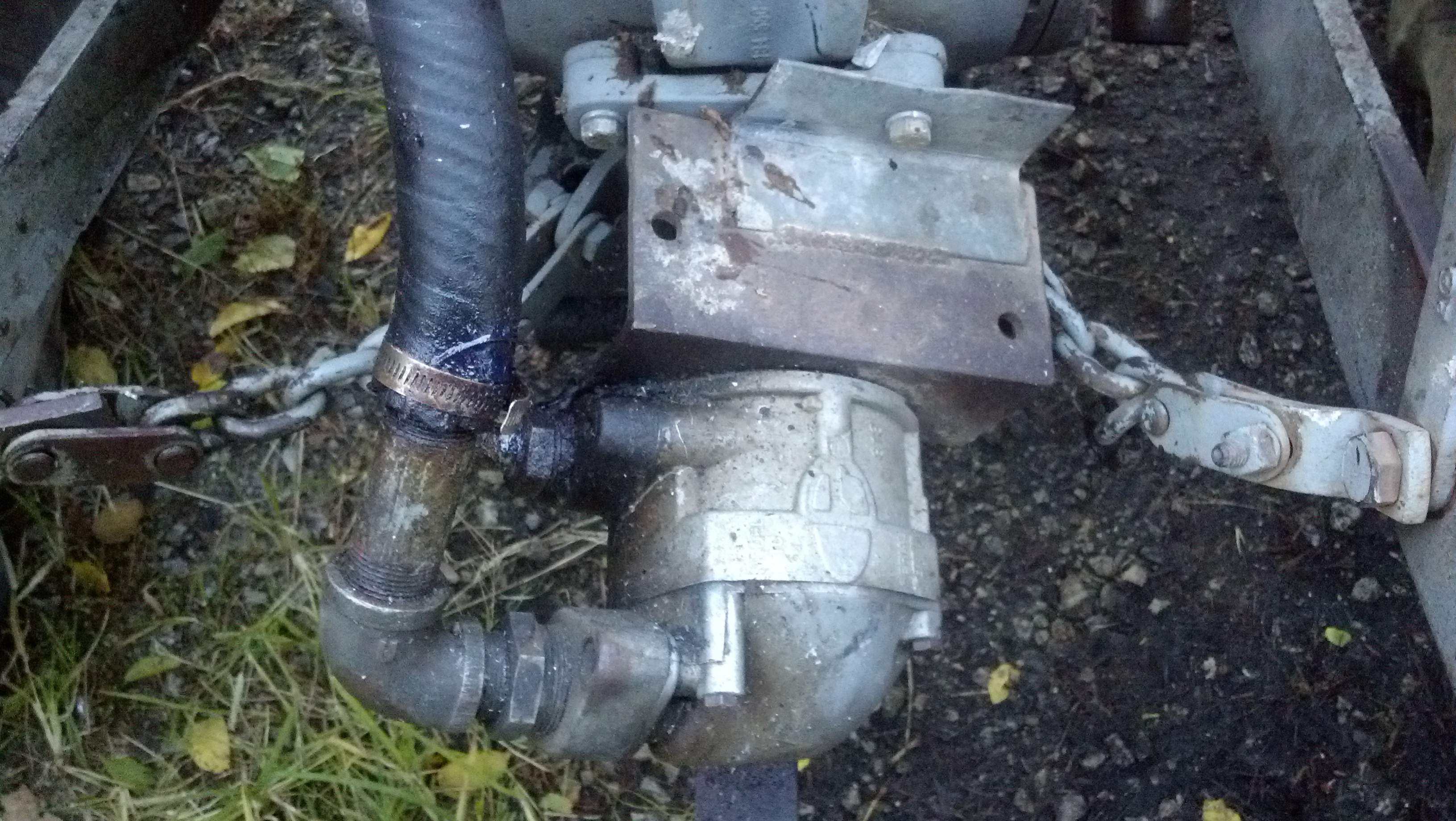

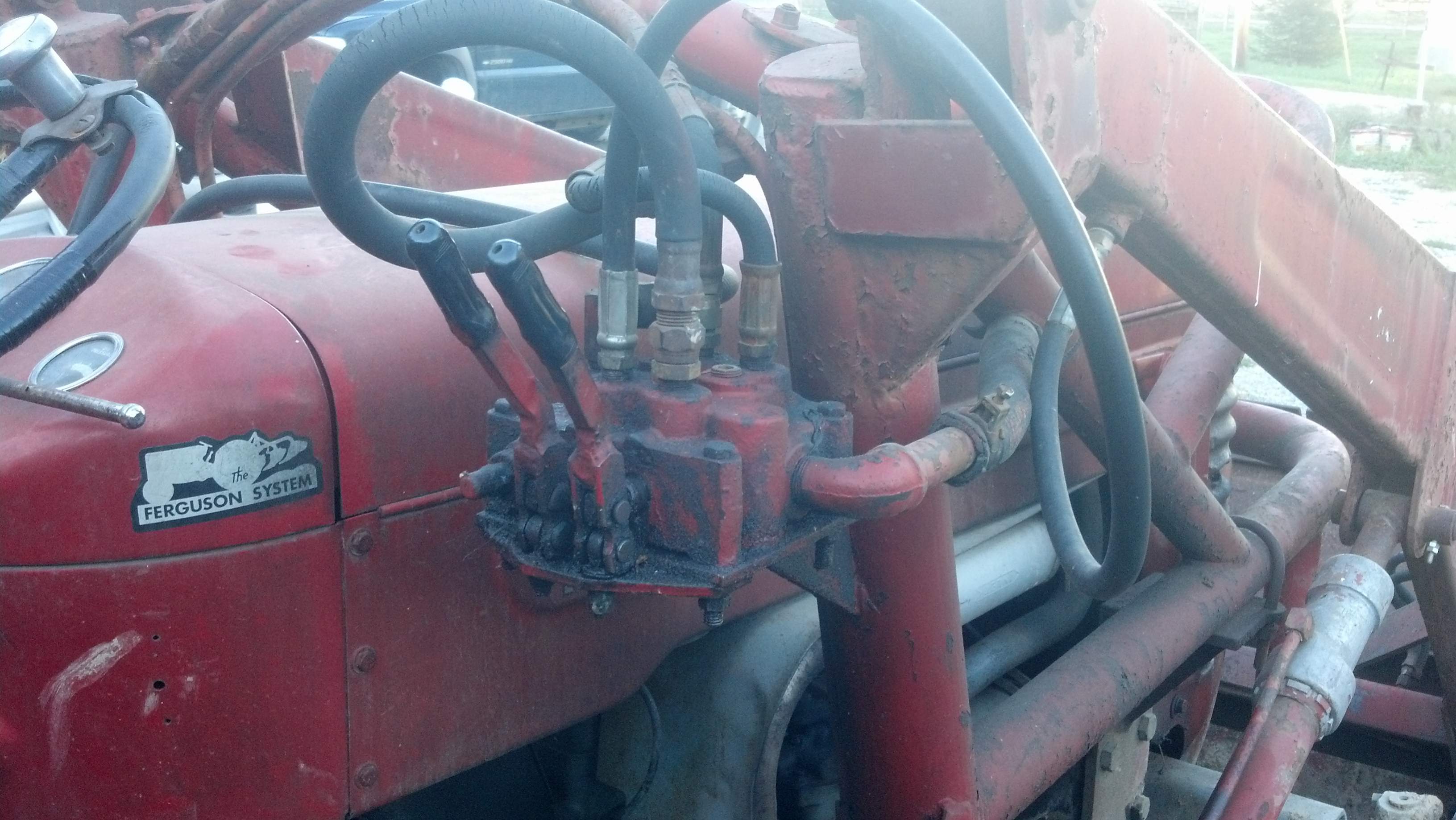

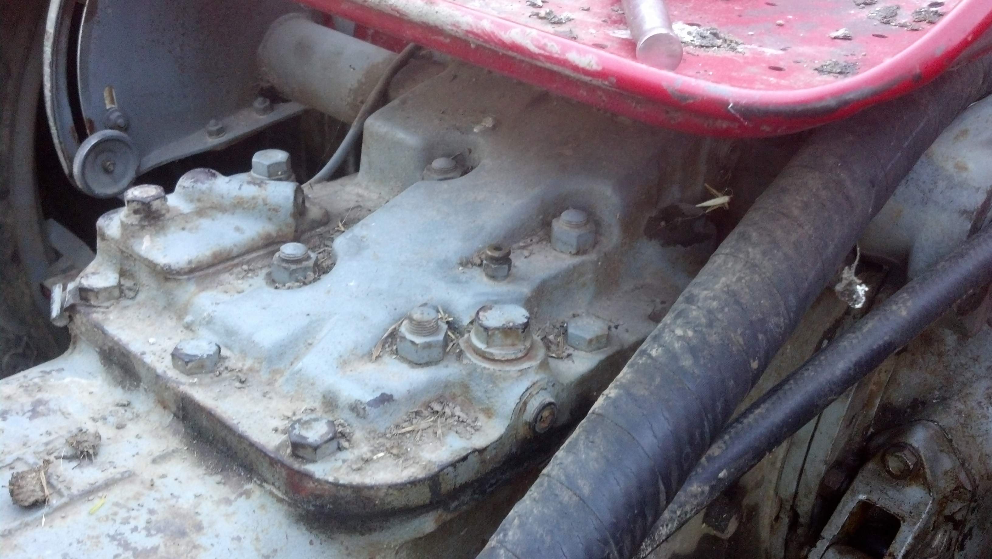

I have seen a few post on here about this but I am having a little trouble understanding what I am wanting to do with this. 1958 MF65. it has a front loader that works off of a unit hooked up to the rear PTO spline. The loader has a hydraulic control valve on it that I use to move the bucket and arms. I would like to be able to use the rear PTO for other things and not have to unhook the loader. I am going to post pictures with this. Can I move the supply line from the rear unit to the thing under my seat. and if so which hole do i hook it upto. what about the big return line. can I just cap it. the control unit on the loader has a return line also.

You have more than sufficient hyd on your tractor, just run a hose from the tractor pump to the IN port of your FEL valve and connect the PB or OUT hose to the input to the 3pt.

I don't know the specifics on your tractor, but in general, you would run a hose from the hyd pump OUT port to the FEL valve IN port, and then run a hose from the PB to the 3pt port. The OUT port will go to tank.
If your hyd plumbing is internal, then you will have to look in your manual and find the correct ports.
Your hyd tank/reservoir is about 8 gal, so you do not need the reservoir in the loader arm.
After changing the FEL system to use tractor hyd, and after cycling all the cyl, then replenish the hyd fluid in the reservoir.
If that loader valve does not have PB, and you want to keep it installed, then you would use the OUT port on the loader valve to feed the 3pt. Not recommend, but it is what it is.

Ok been a little busy and still do not have this completed. In the first picture that is the hydralic pump for the 3pt. it works. my question is where on the pump under my seat can I hook up lines to the 2nd picture which is the control valve for the loader. that would enable me to get rid of third picture which is a pump mounted to the pto shaft.
I have a service manual but it only tells me how to rebuild the 3pt pump not where i can hook up to it. I think this should be as easy as unhooking the supply and return line from the PTO pump. and connecting them to the pump under my seat.

I do not see a hyd pump in the above first picture, however it could be internal, you tell me.
Do you have an external hyd pump other than the PTO pump?
Show a picture of the pump output if available.
Do you have a parts manual, or owners manual?

the pto pump under your seat is a Gresen TB-** vane pump, (the next numbers are the gpm's at 1200 (?) rpms)
http://www.maxxhyd.com/PumpsGresen.pdf
Check out page 177
Pump Tc-24 Gresen 24 Gal @1200Rpm Counterclockwise
is another view at a marine outlet, they use these for different purposes
