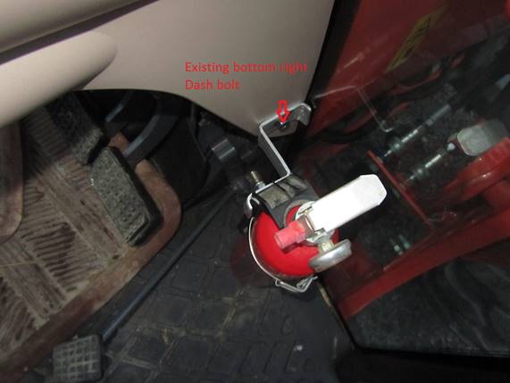

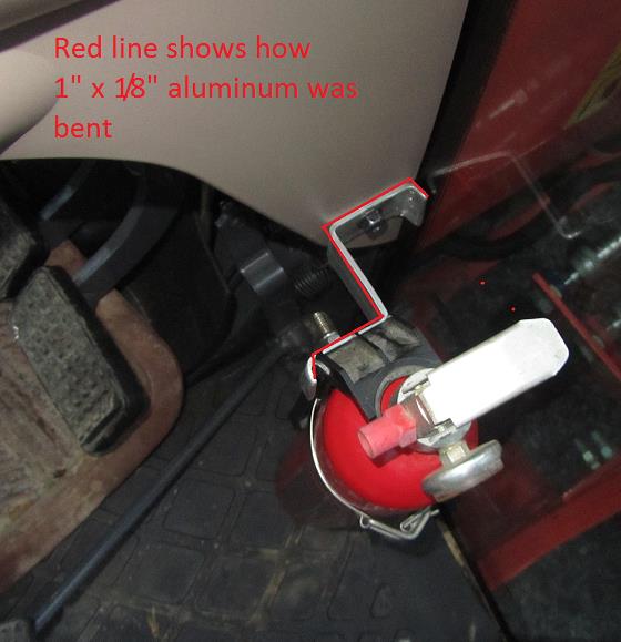

You have been warned to have a fire extinguisher on board :)
I have had several fires from squirrels building a nest around my turbocharger.
By the time i realized there was a fire I was some distance from my home and water.

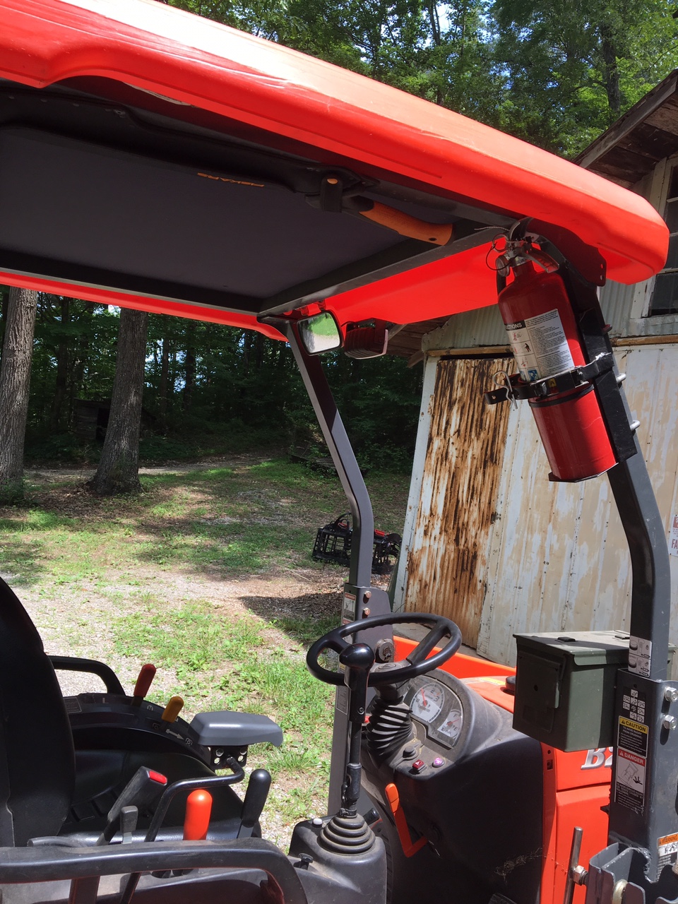

Fire extinguishers should be standard equipment. The only chance in a few seconds to prevent a small fire from becoming a major problem.
