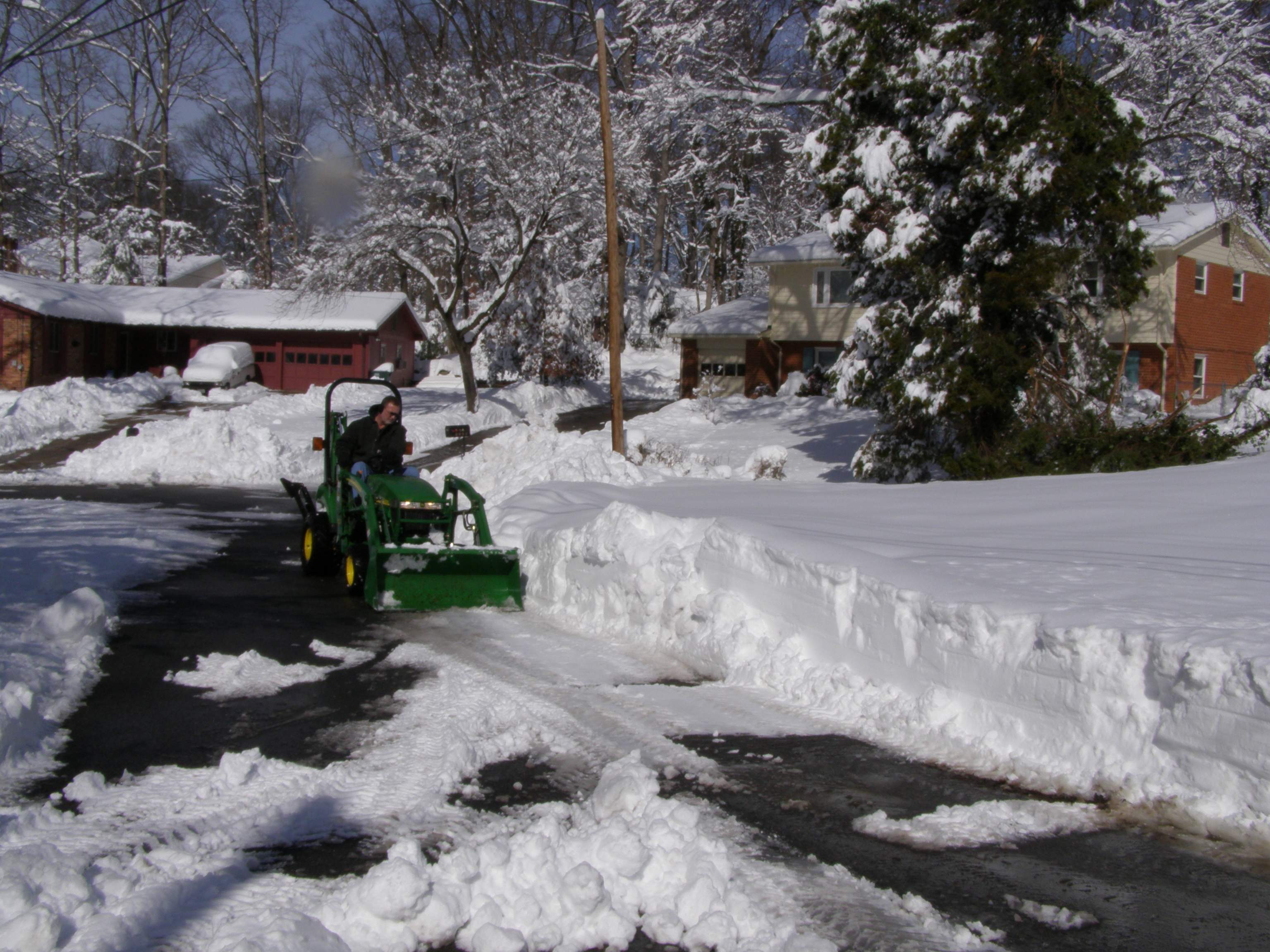

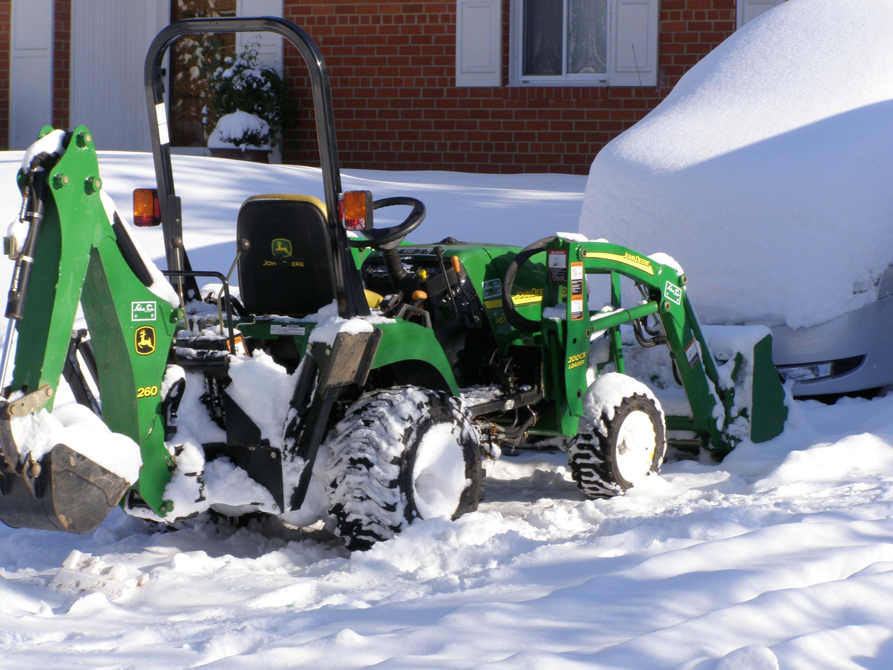

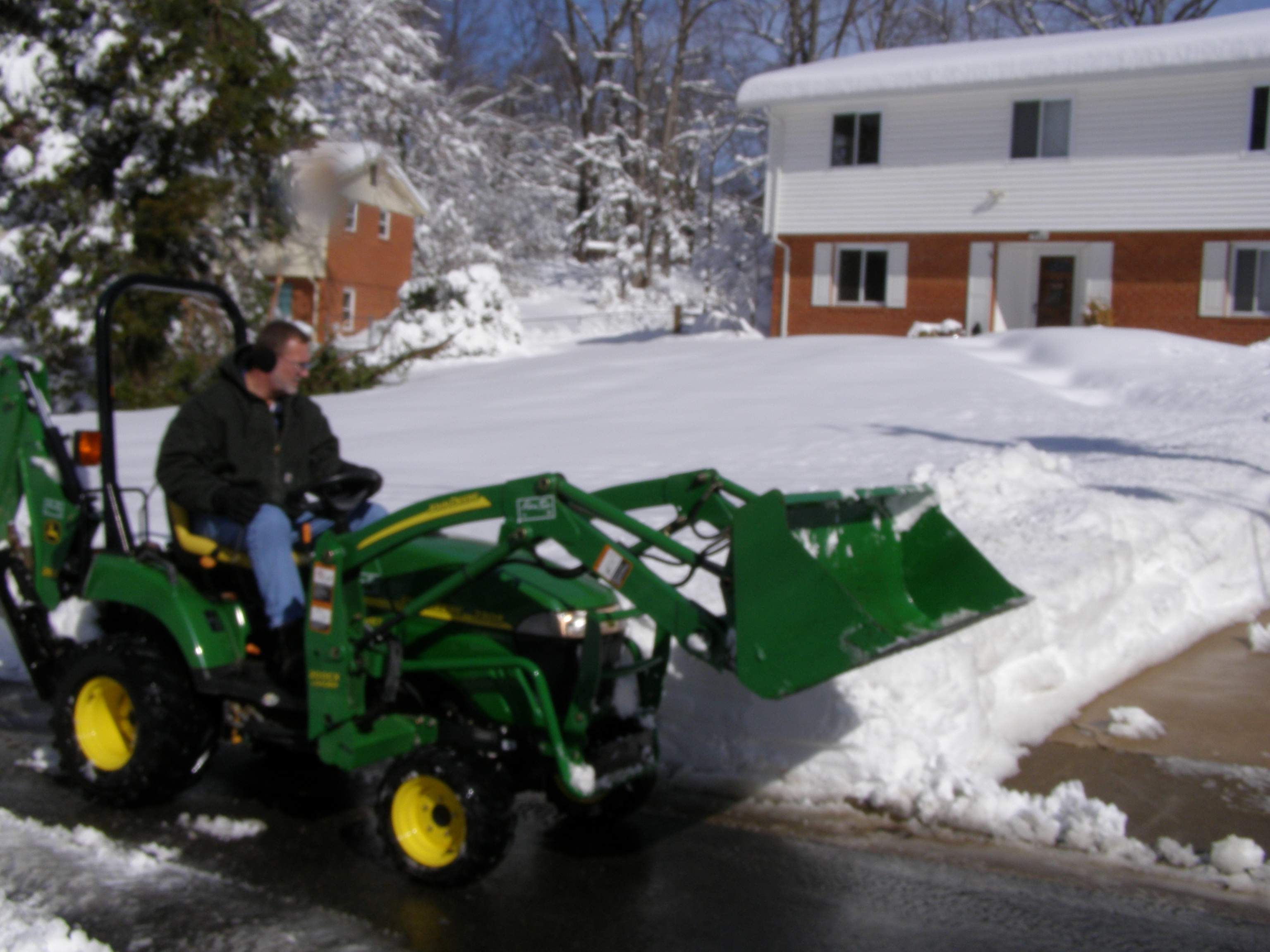

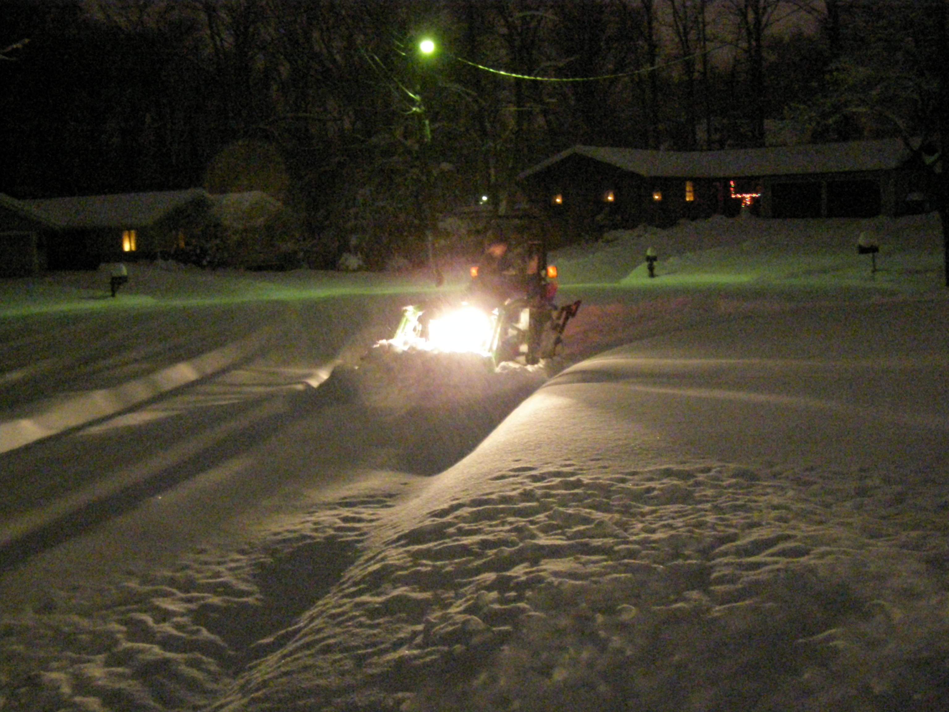

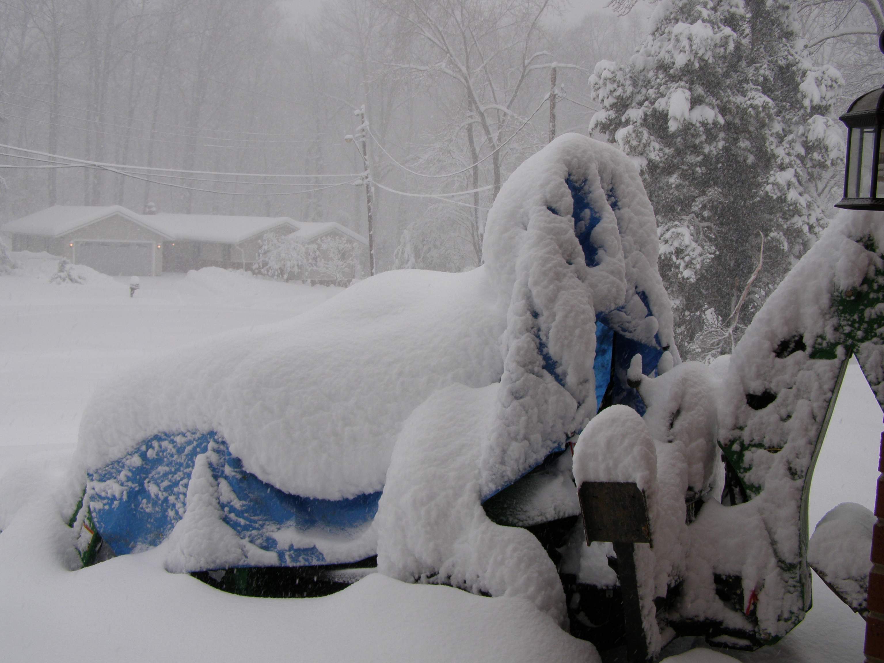

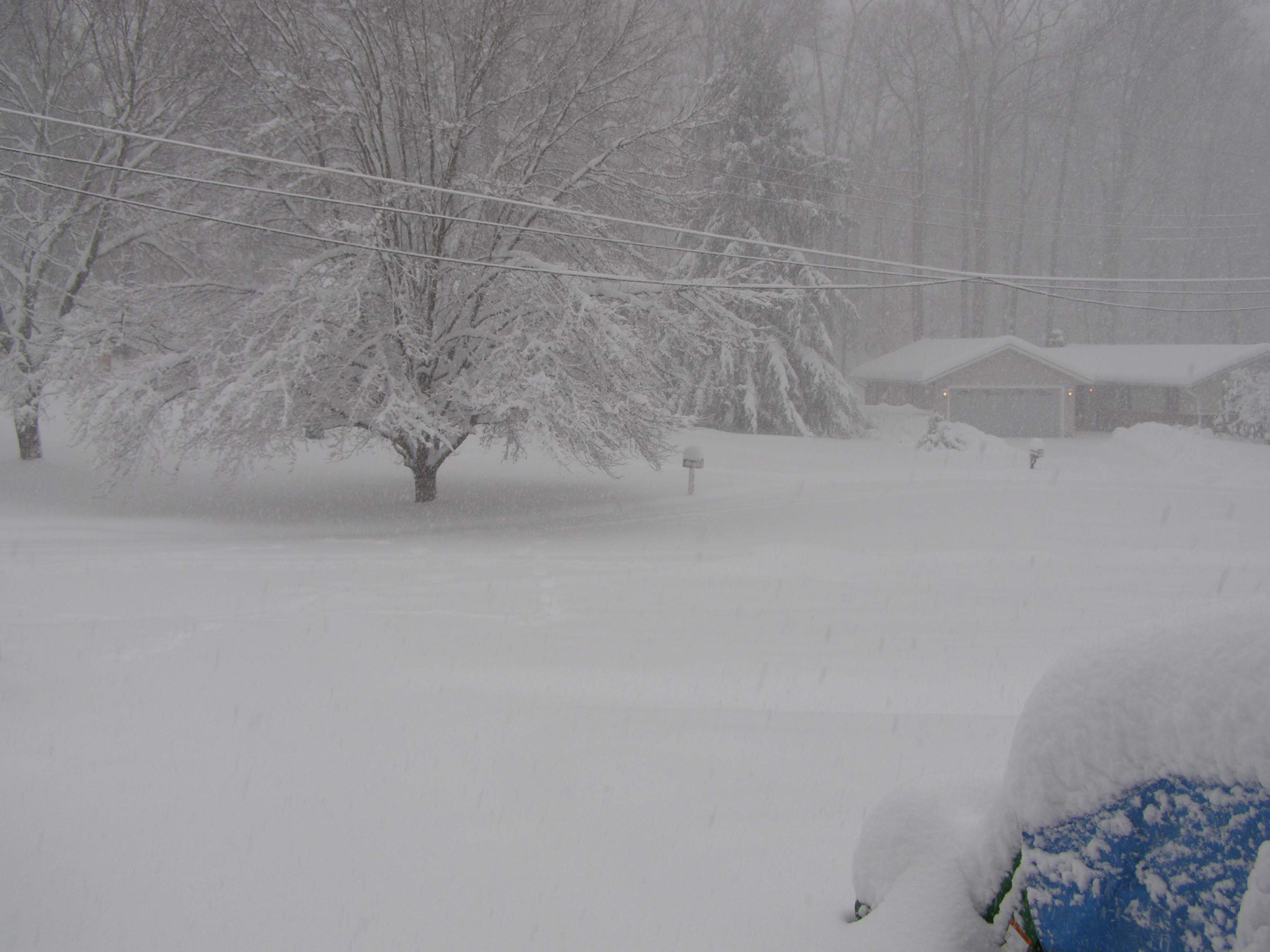

The first big one in December I made a mistake by leaving the tractor out back in the barn and waiting until the storm passed. It took me over an hour to move it 200 feet due to the snow depth. The last two storms I was smarter and parked it by the house for quick access. I covered it with a tarp to keep the snow off of it. After digging myself out I cleared the road and then helped my neighbors by clearing their driveways. My driveway is concrete but on a serious grade and impassible if not completely cleared.
Coating the FEL bucket with a shot of WD 40 really helped keep the snow from sticking. I kept the tractor in 4WD and just kept piling it on. I found that I could roll the piles over when droping new loads by lifting the bucket and pushing at the same time. I have R4 tires which did great in the snow so I do not see the need for chains. When pushing the snow it helped to keep the speed up. That helps overcome the hard packed areas when you cross them.
