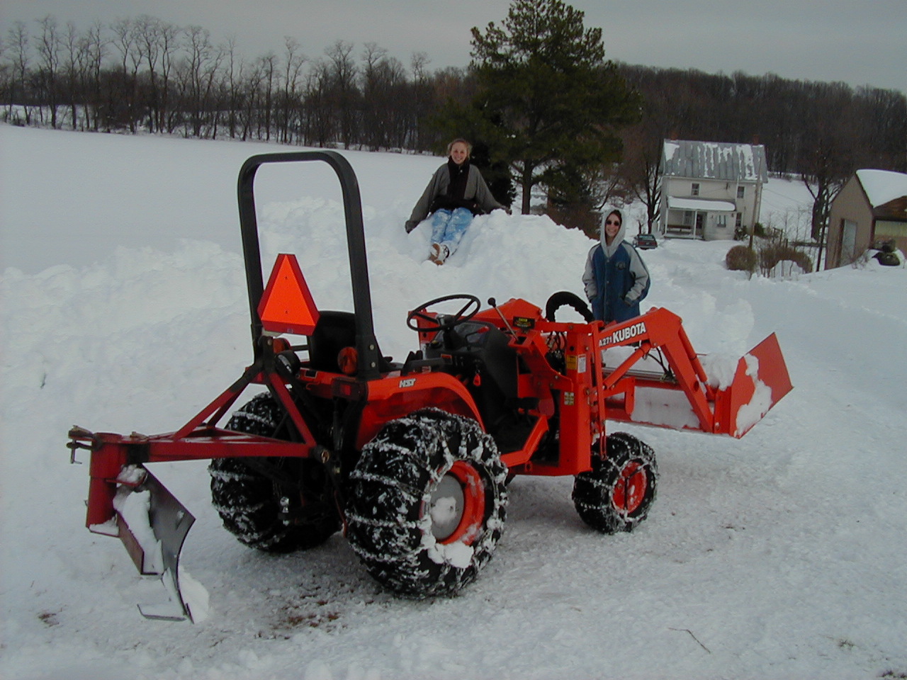

Chains on all four. Engage Front drive when needed, I have a steap hill that I need to go down to bucket the snow out. I need the chains on the front when backing up the hill with a load. I fabricated an 18" extension for my loader bucket. Attaches with 4 bolts like a tooth bar. Triples the capacity of the bucket. Works like a charm.
Ohh - I like it!
Any chance you have a drawing or specs on your snow pusher?
I'd like to build one myself.
