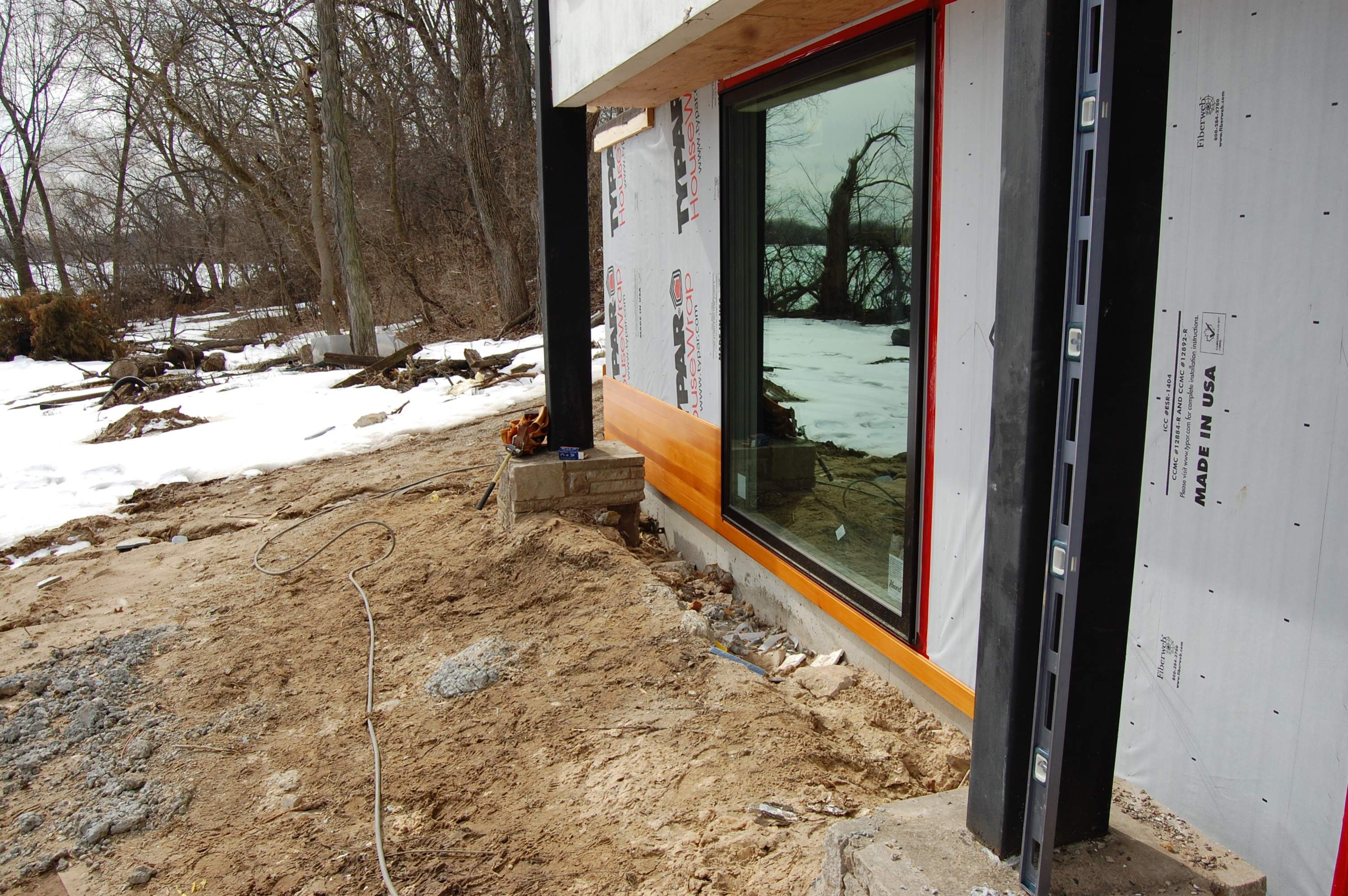

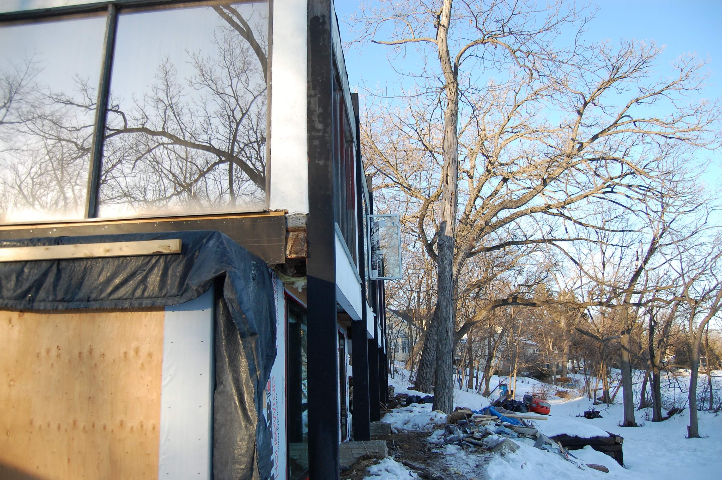

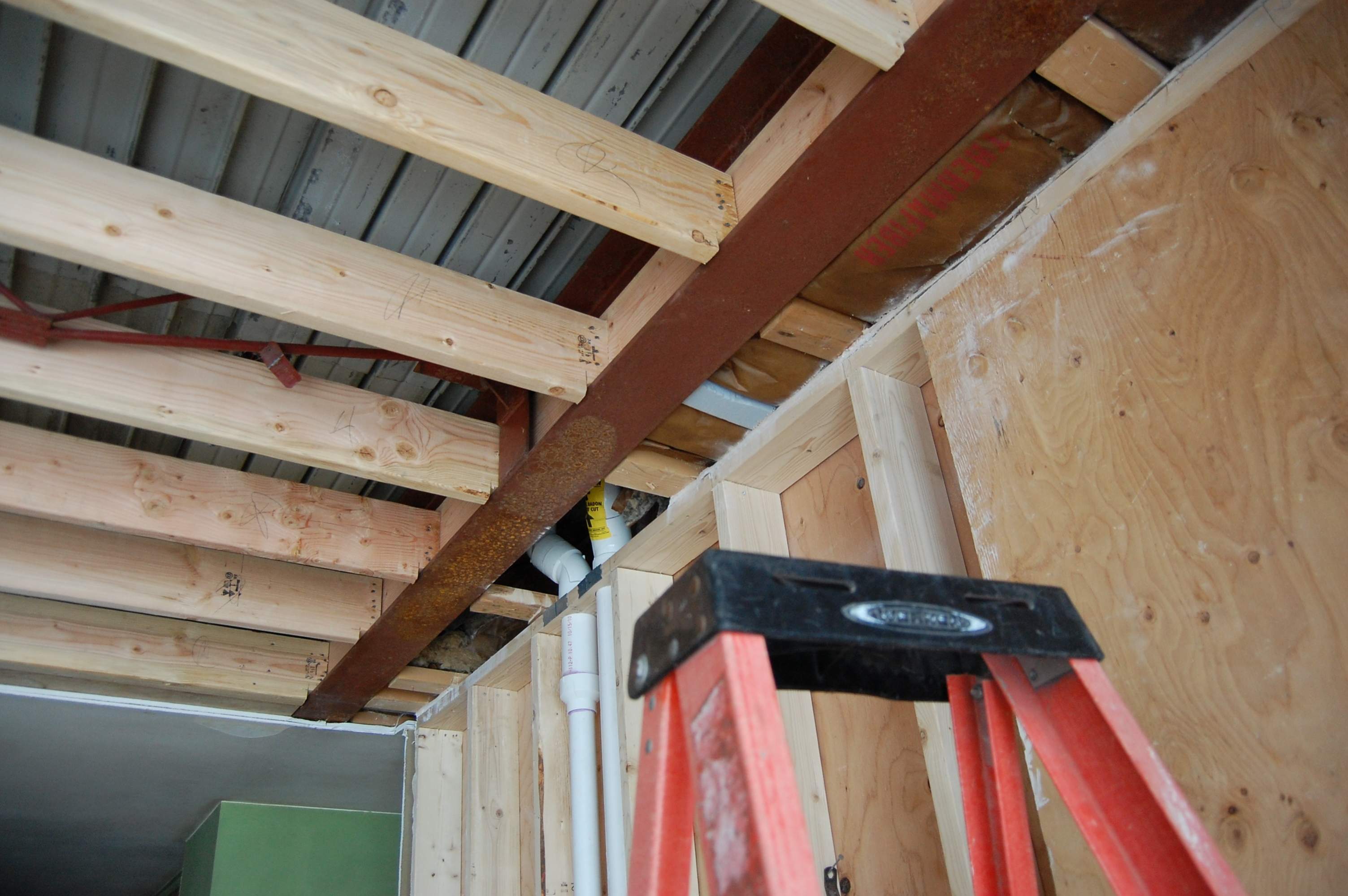

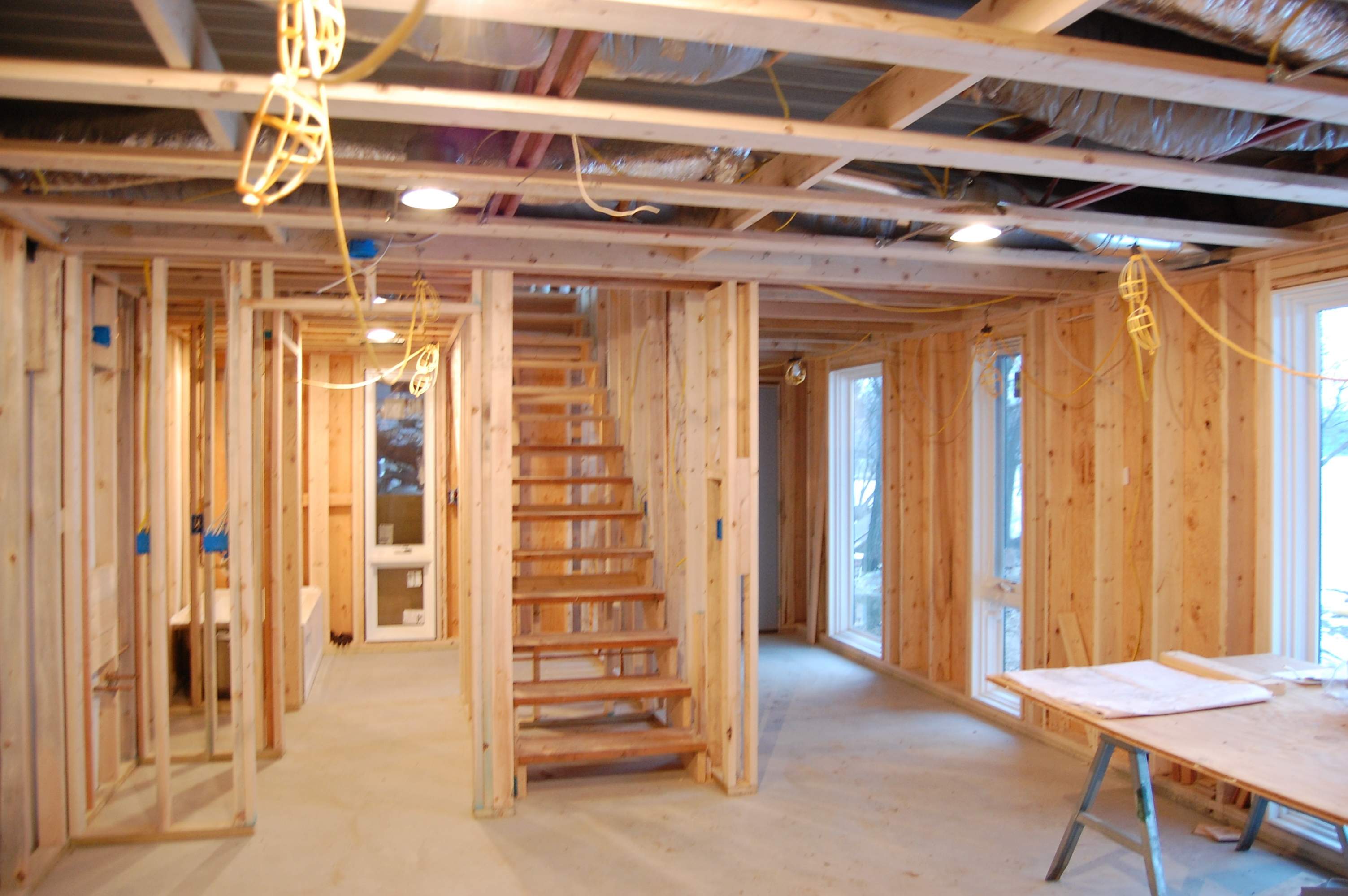

Sorry for the hiatus, was away for some vaca and holiday...

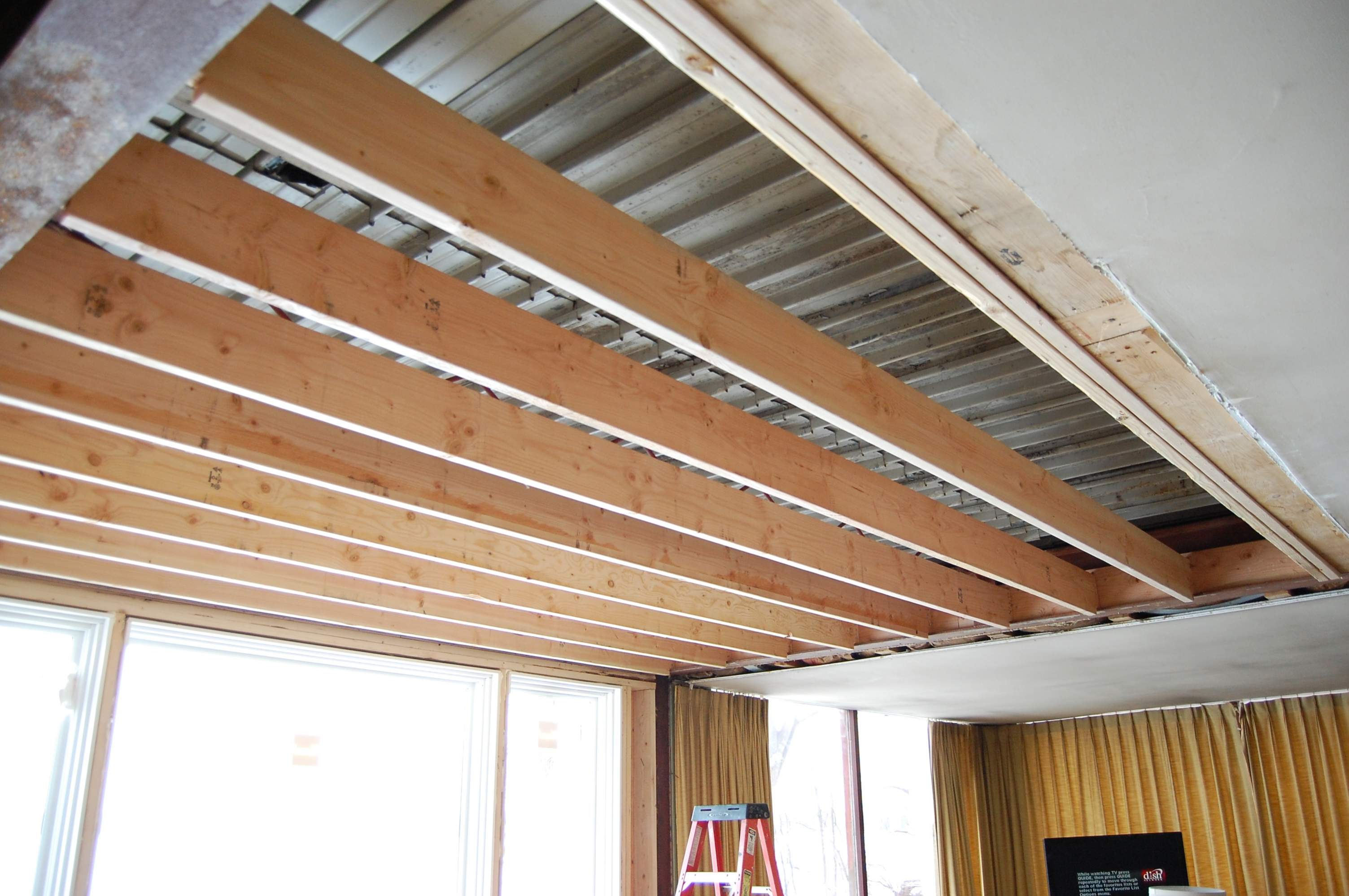

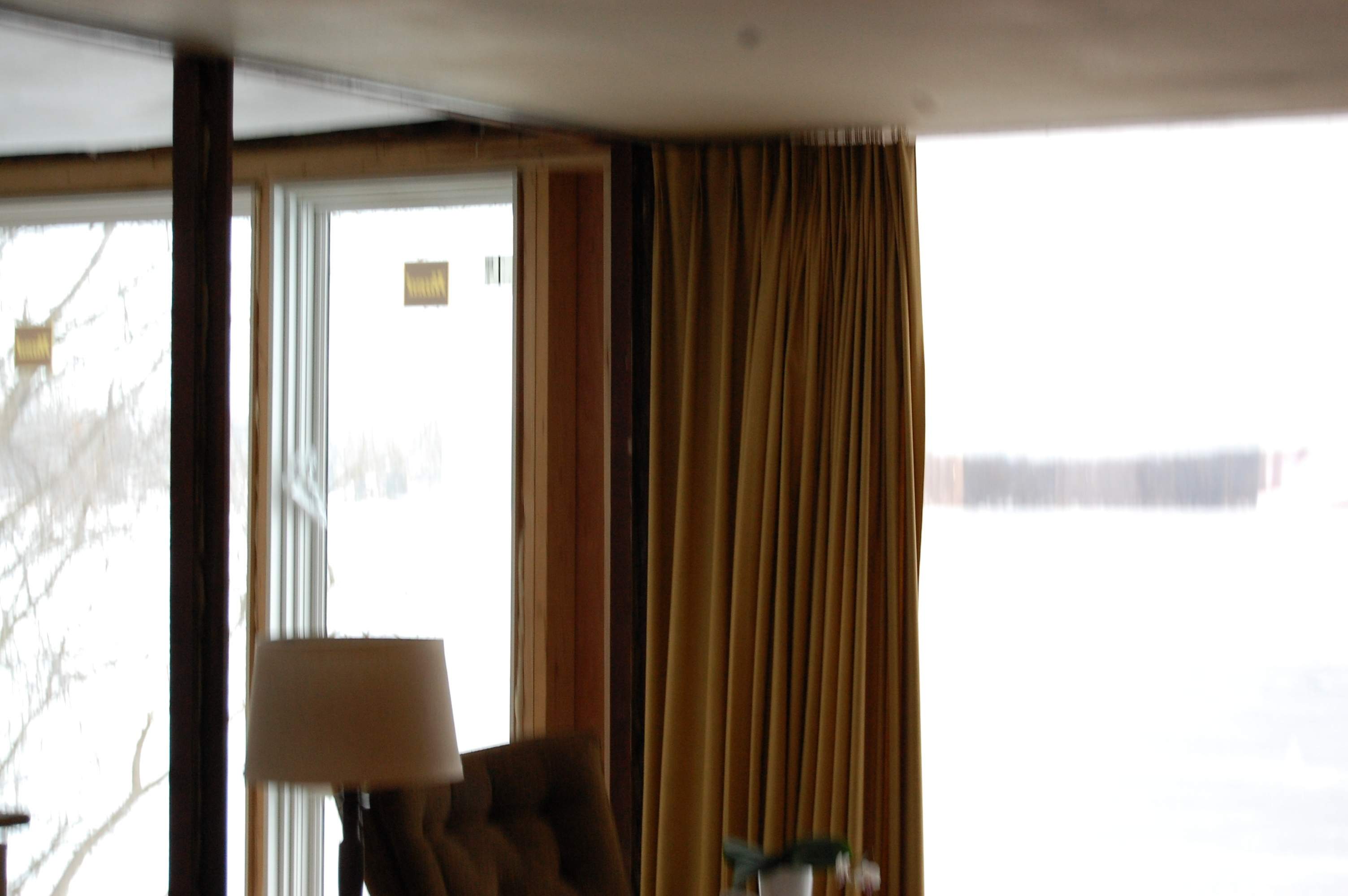

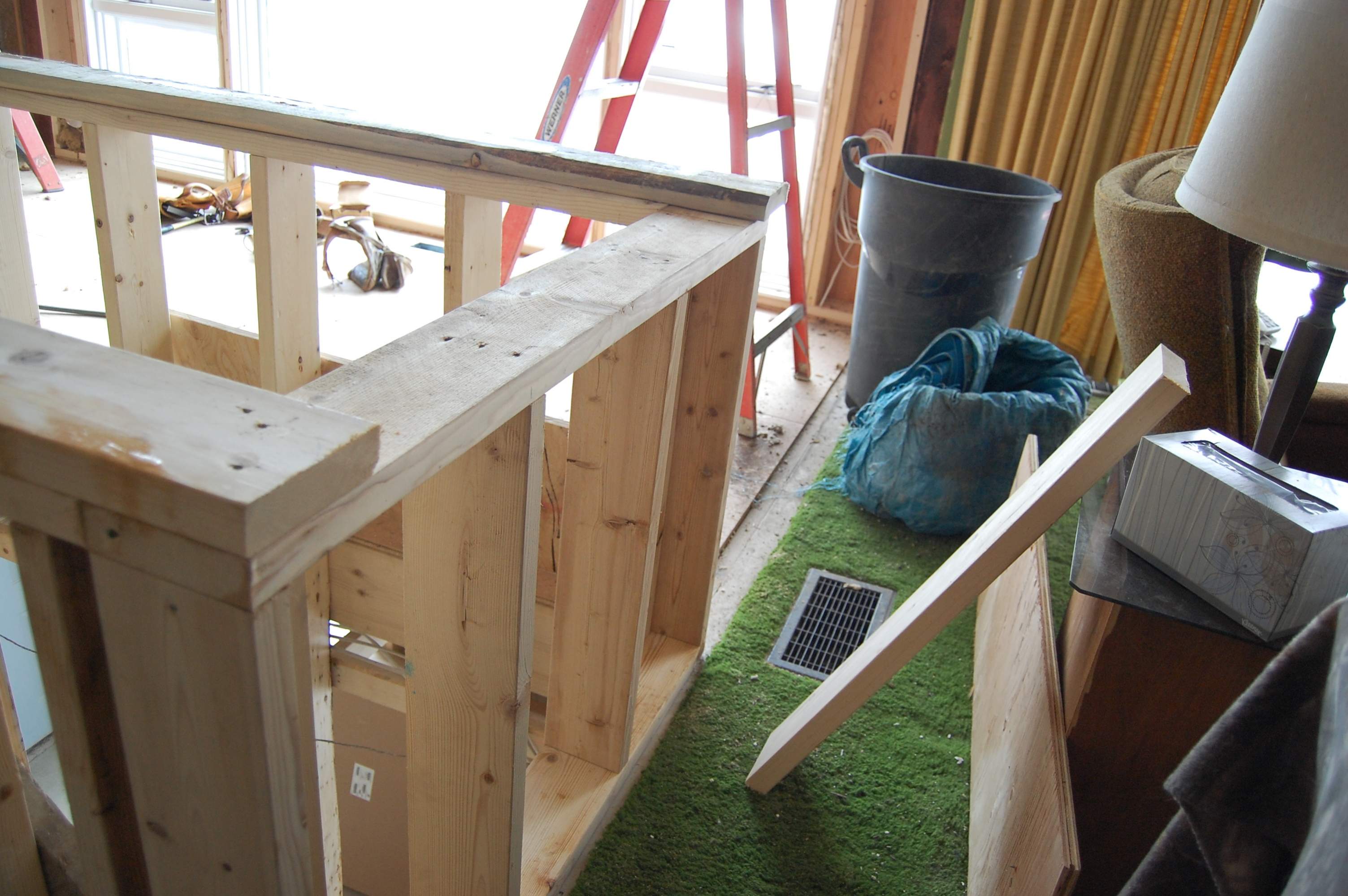

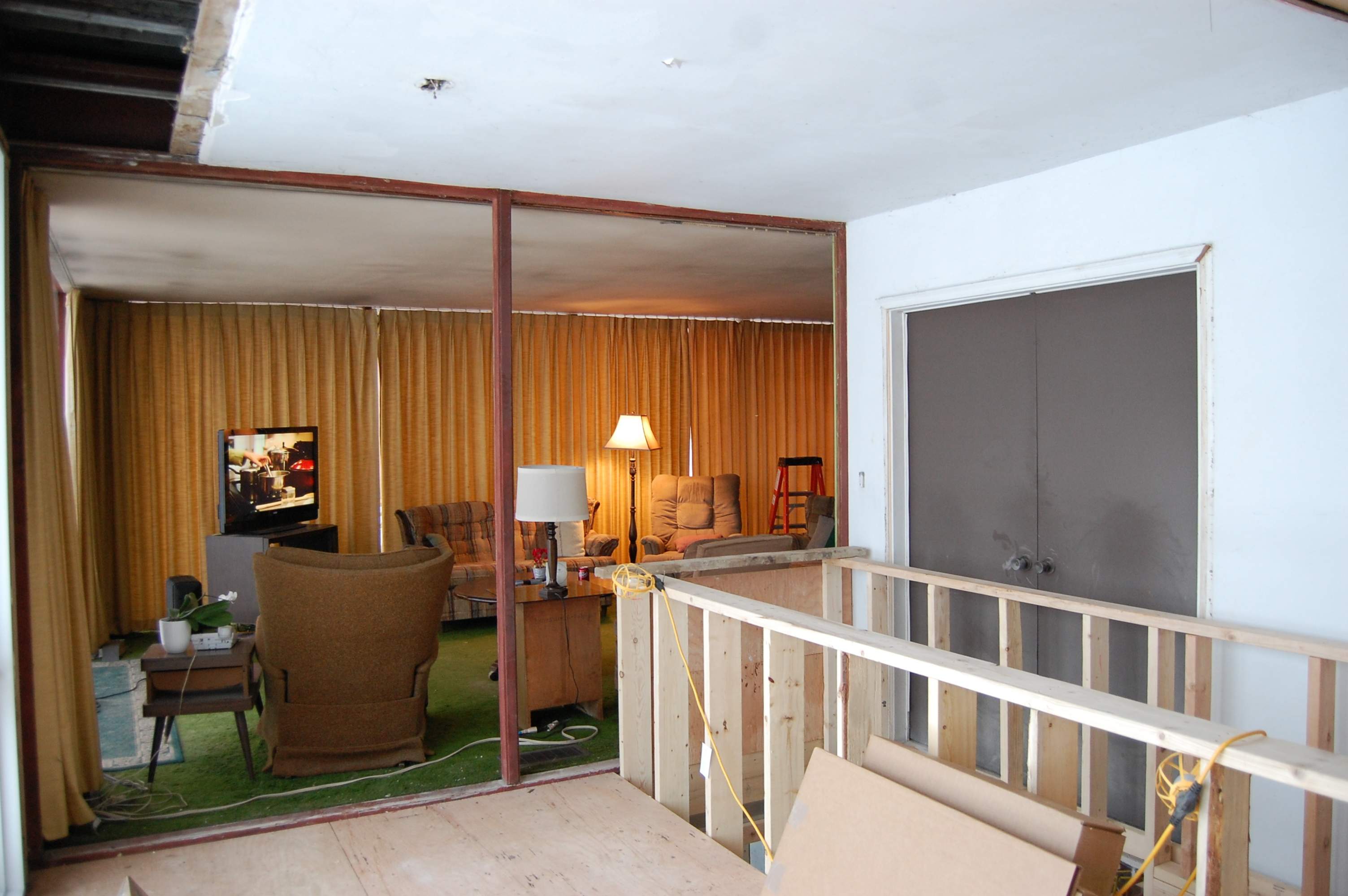

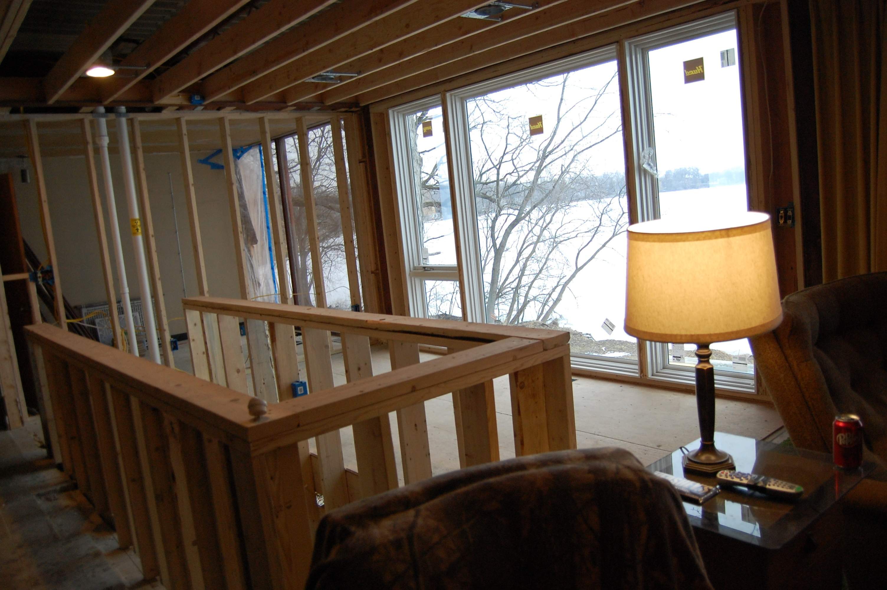

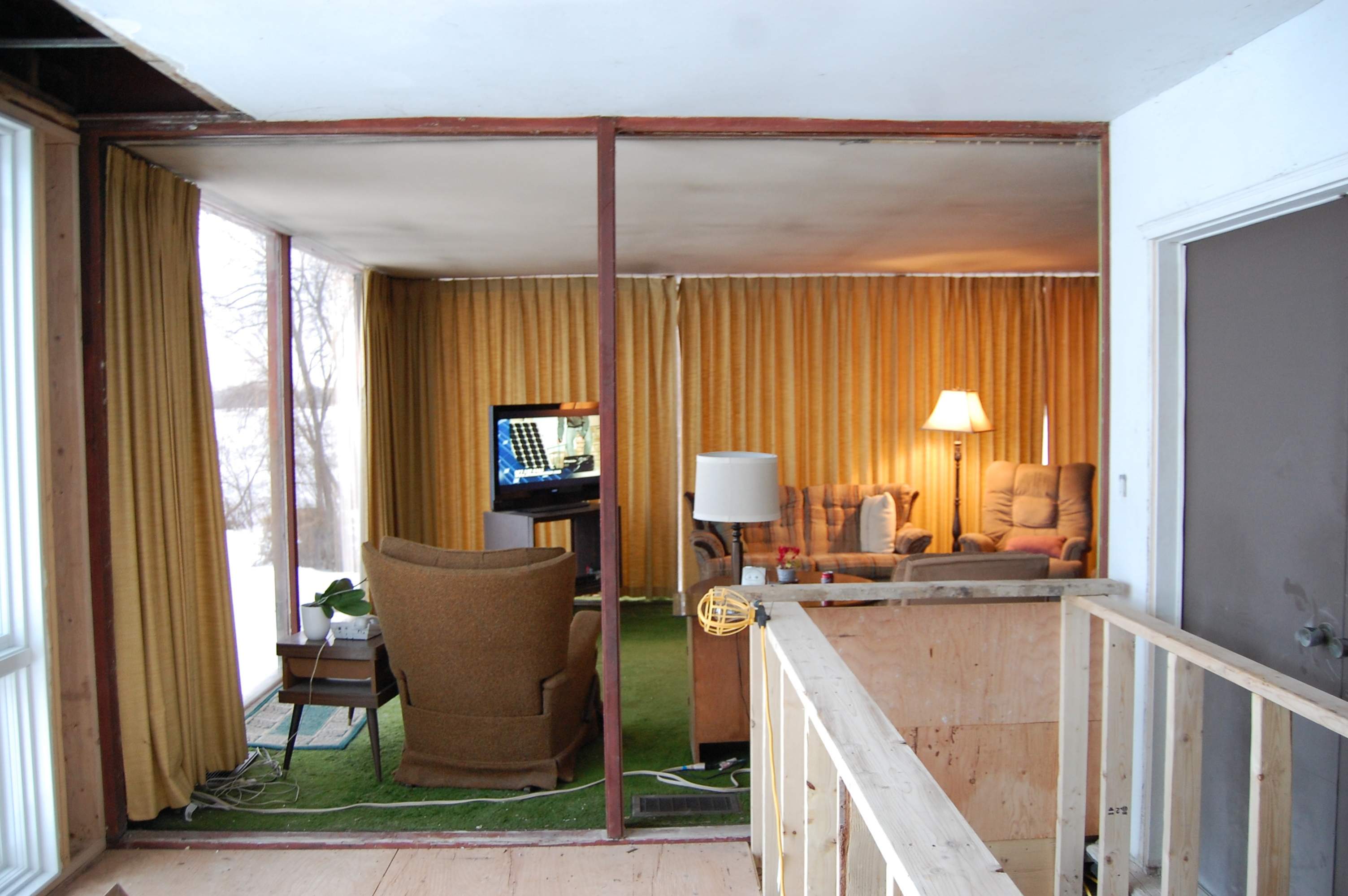

Here you see some more framing, and after we decided to take out the interior window wall separating the living room from the old stairs. The plans had to keep that in as a separation but it just did not look right, and we could tell having it all open was going to look spectacular...we hoped...

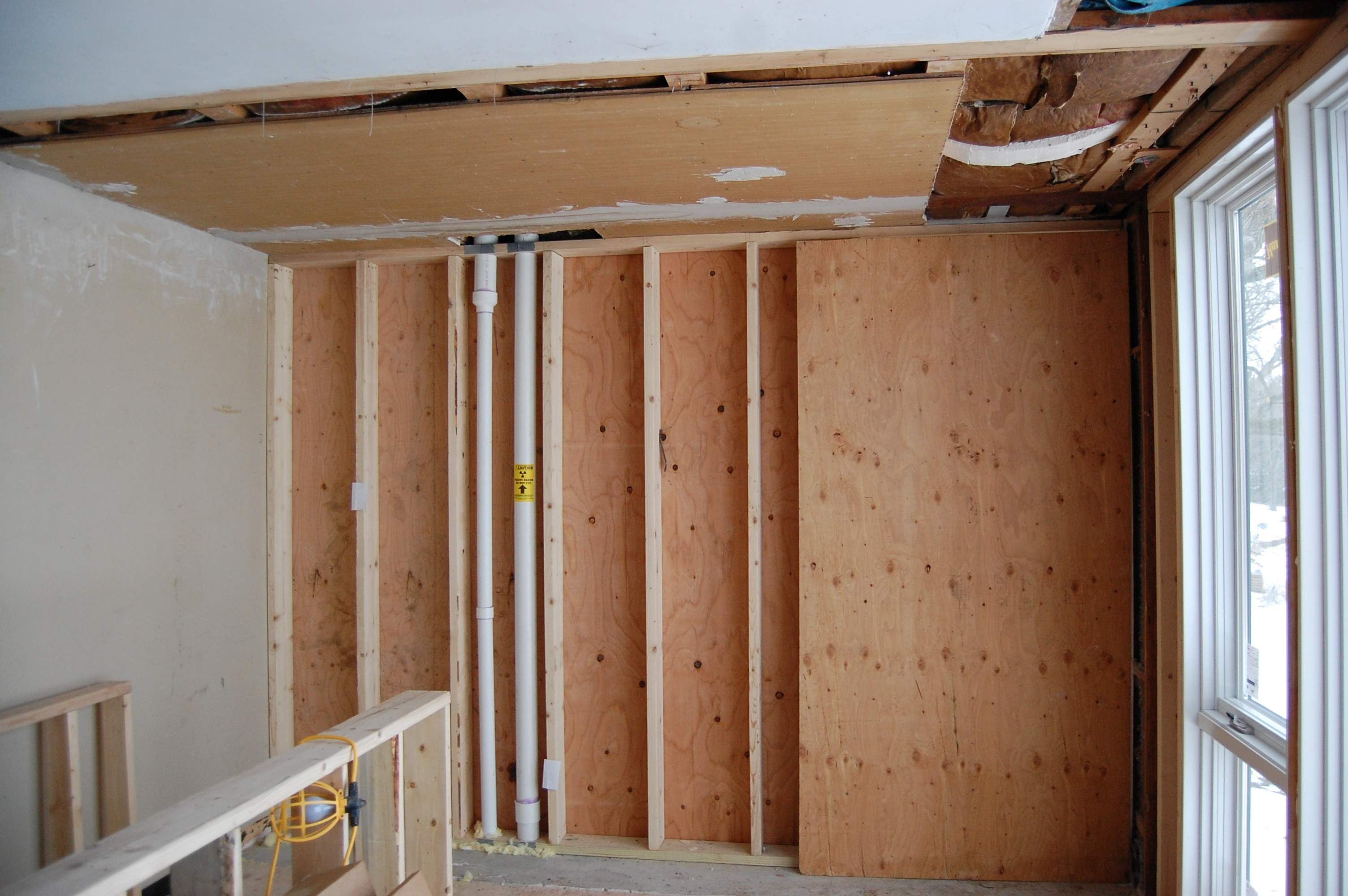

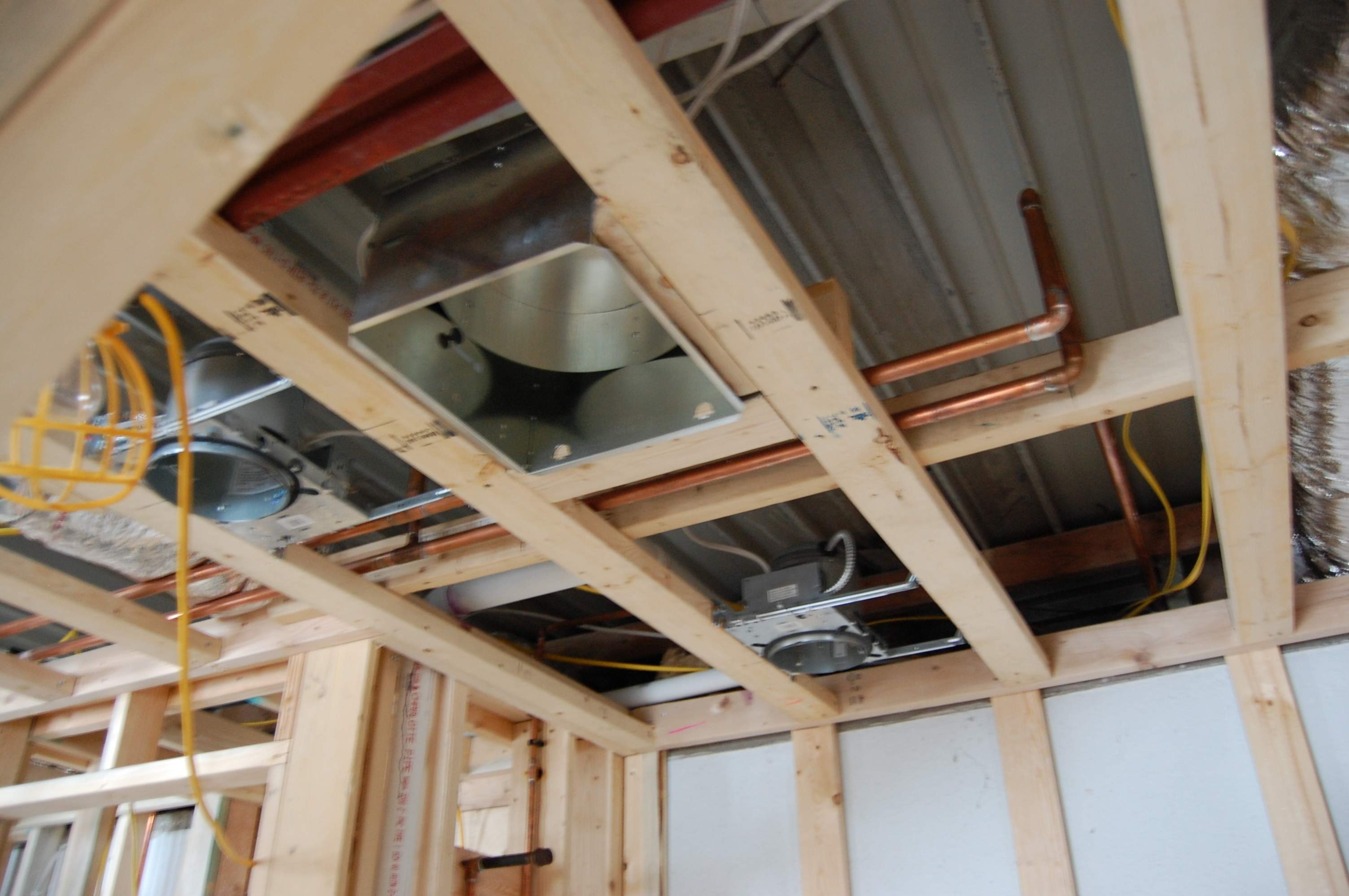

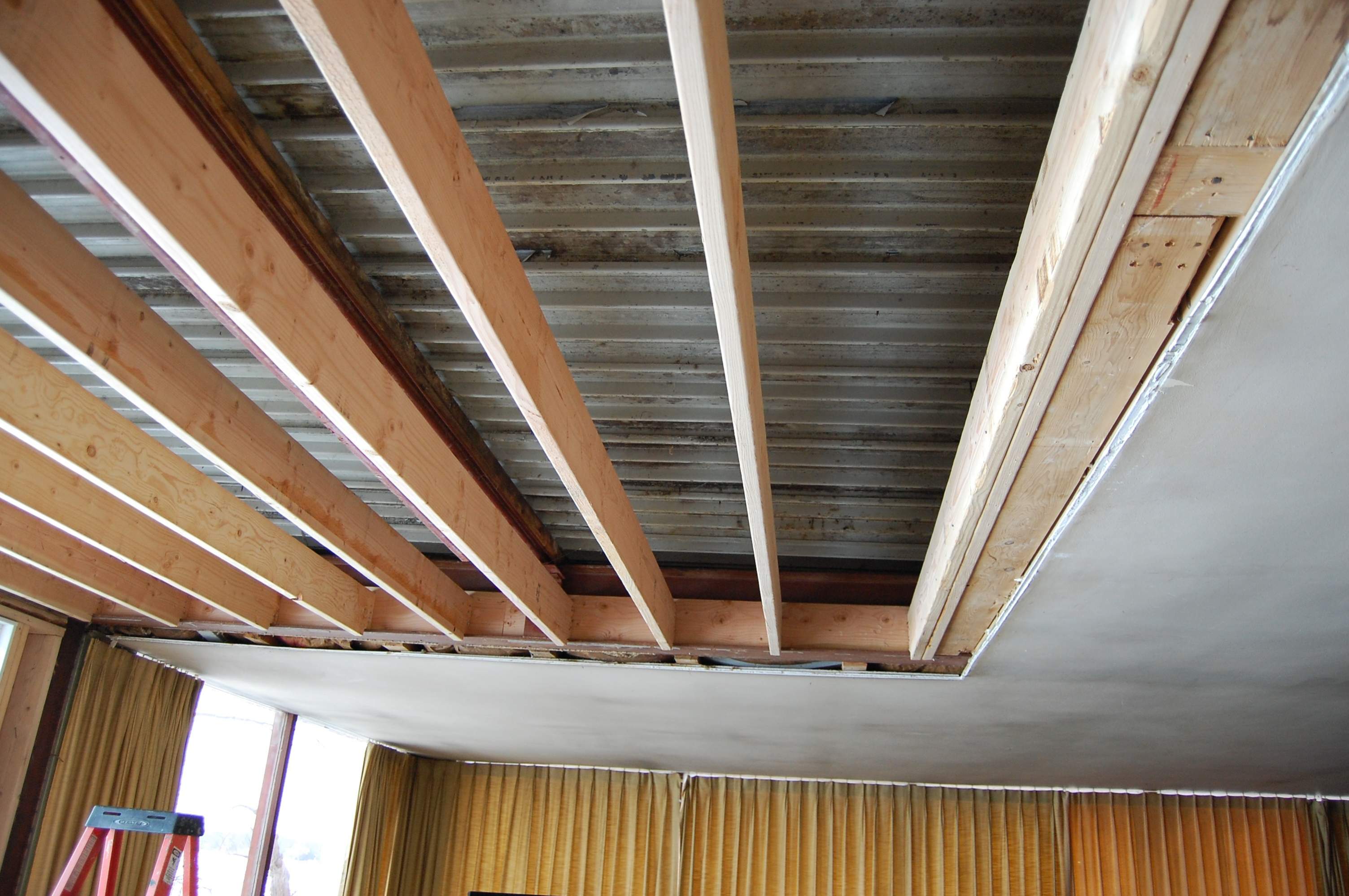

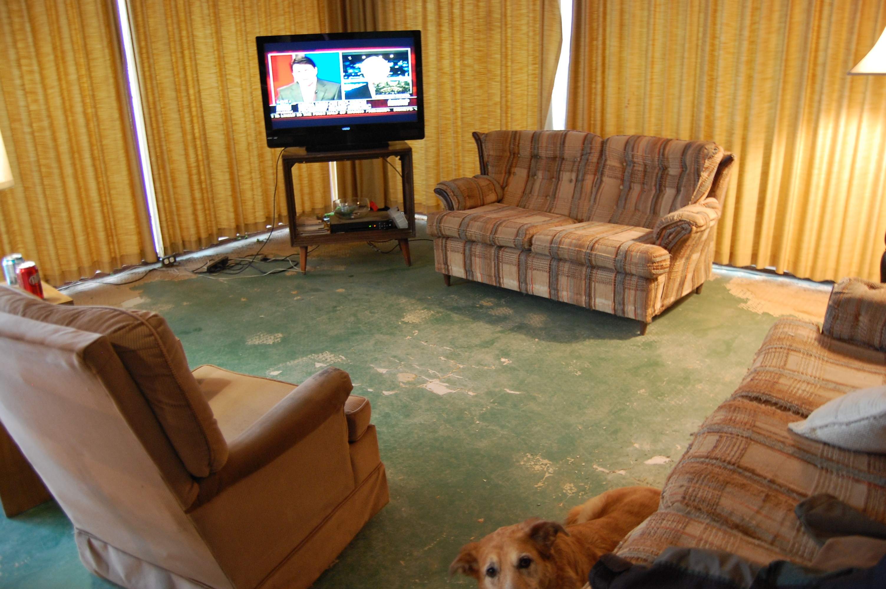

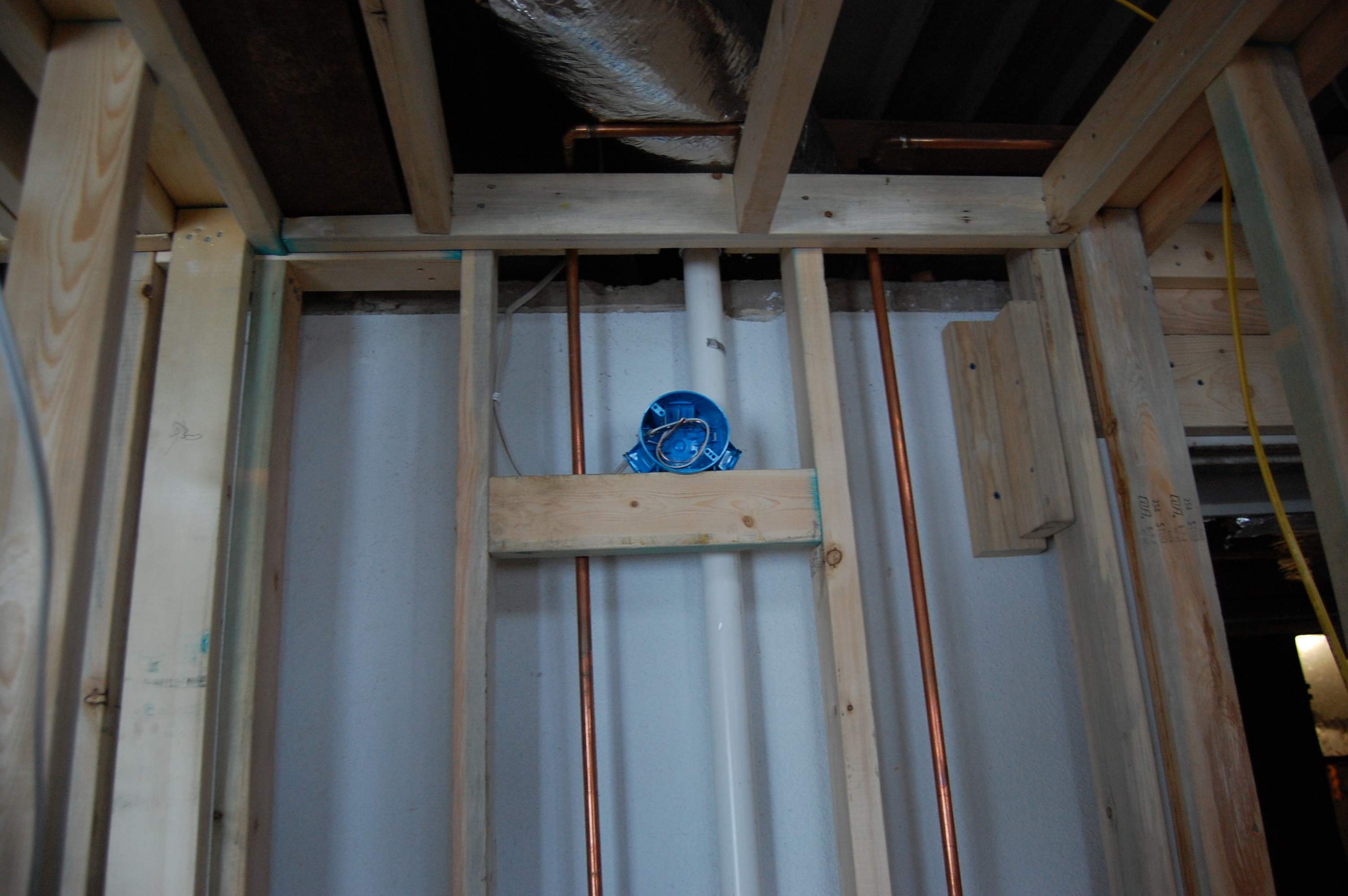

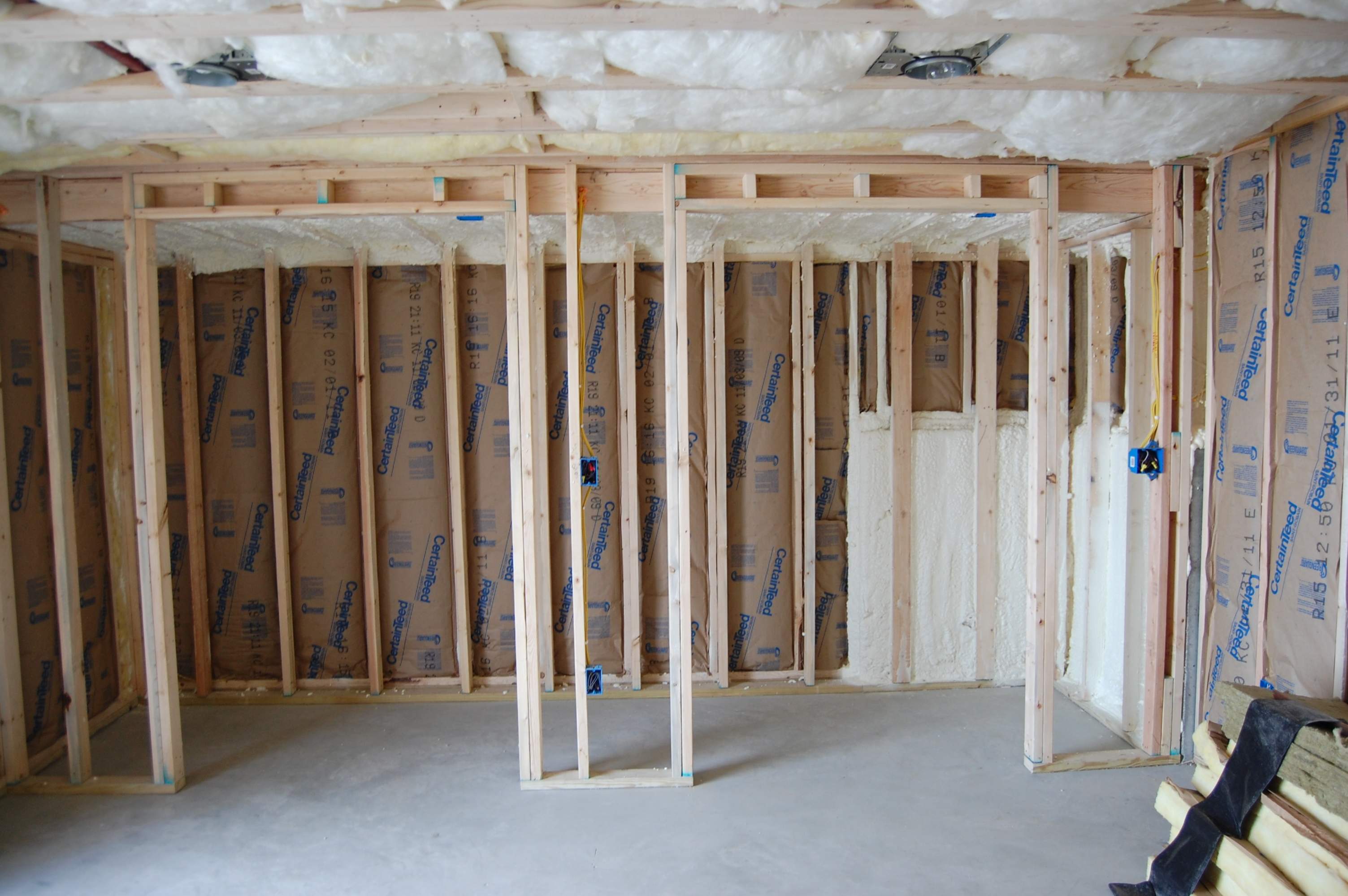

Pictures of the upstairs ceiling work prepping for drywall. The living room in a state of disaster, and some more downstairs framing in the closet prior to insulation.

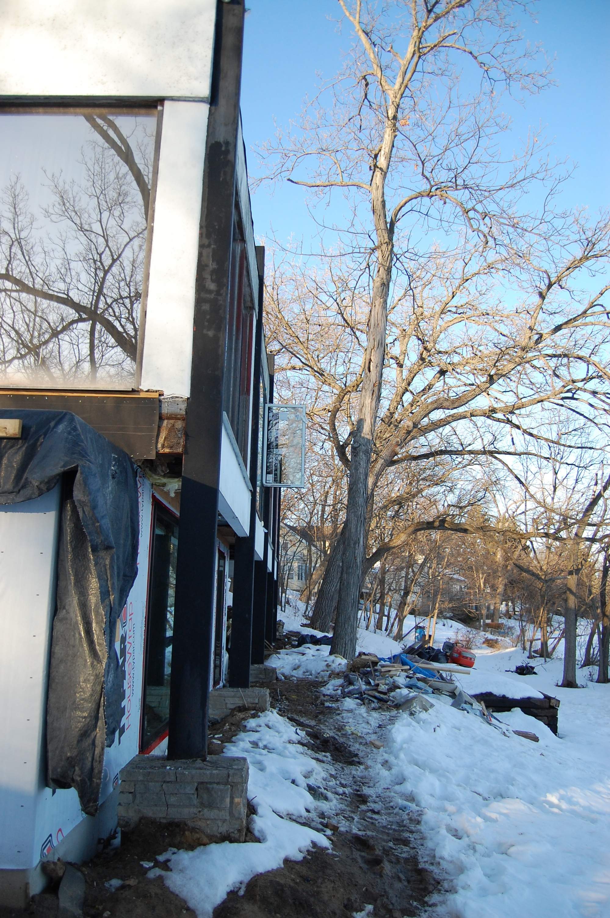

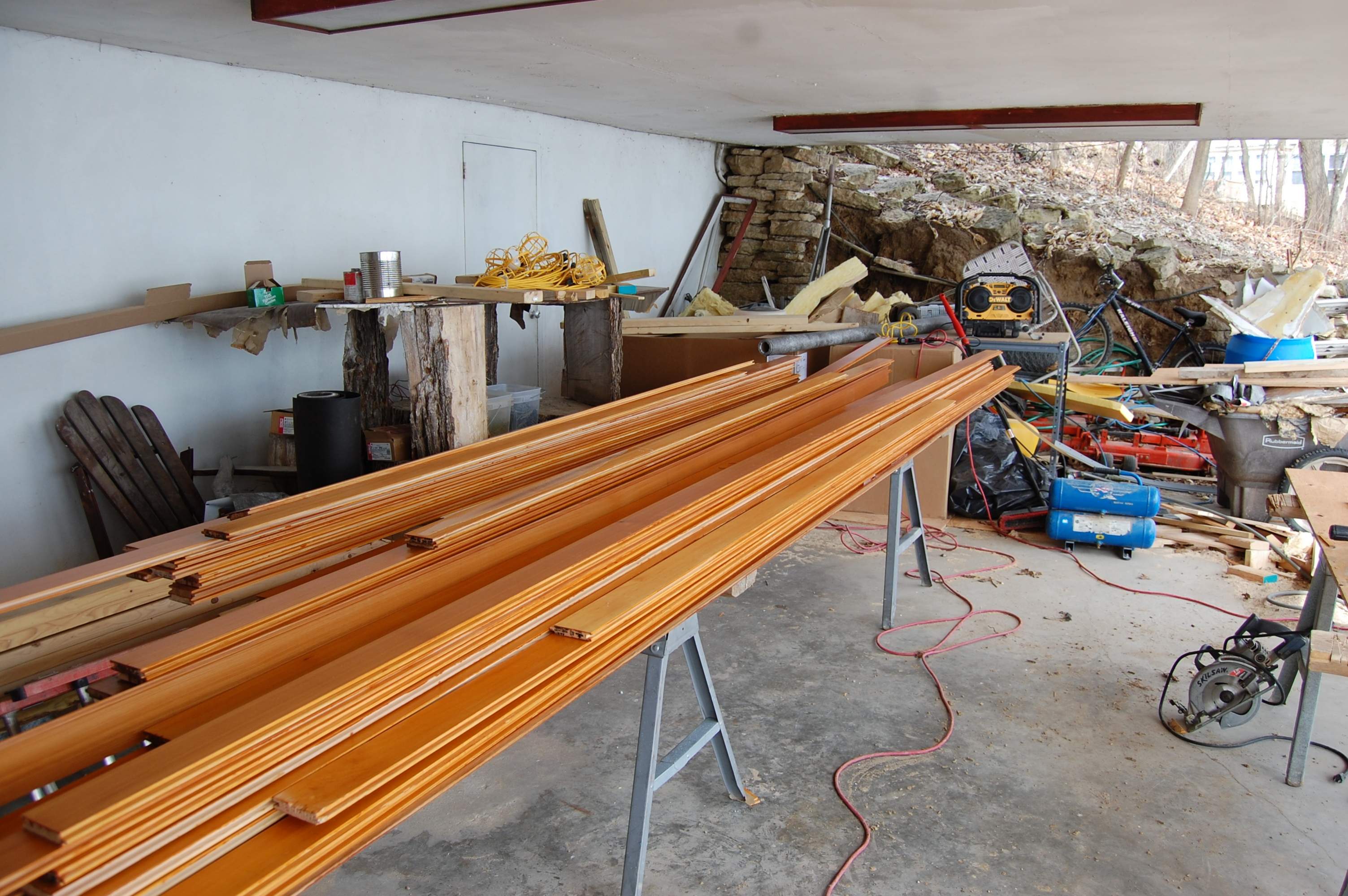

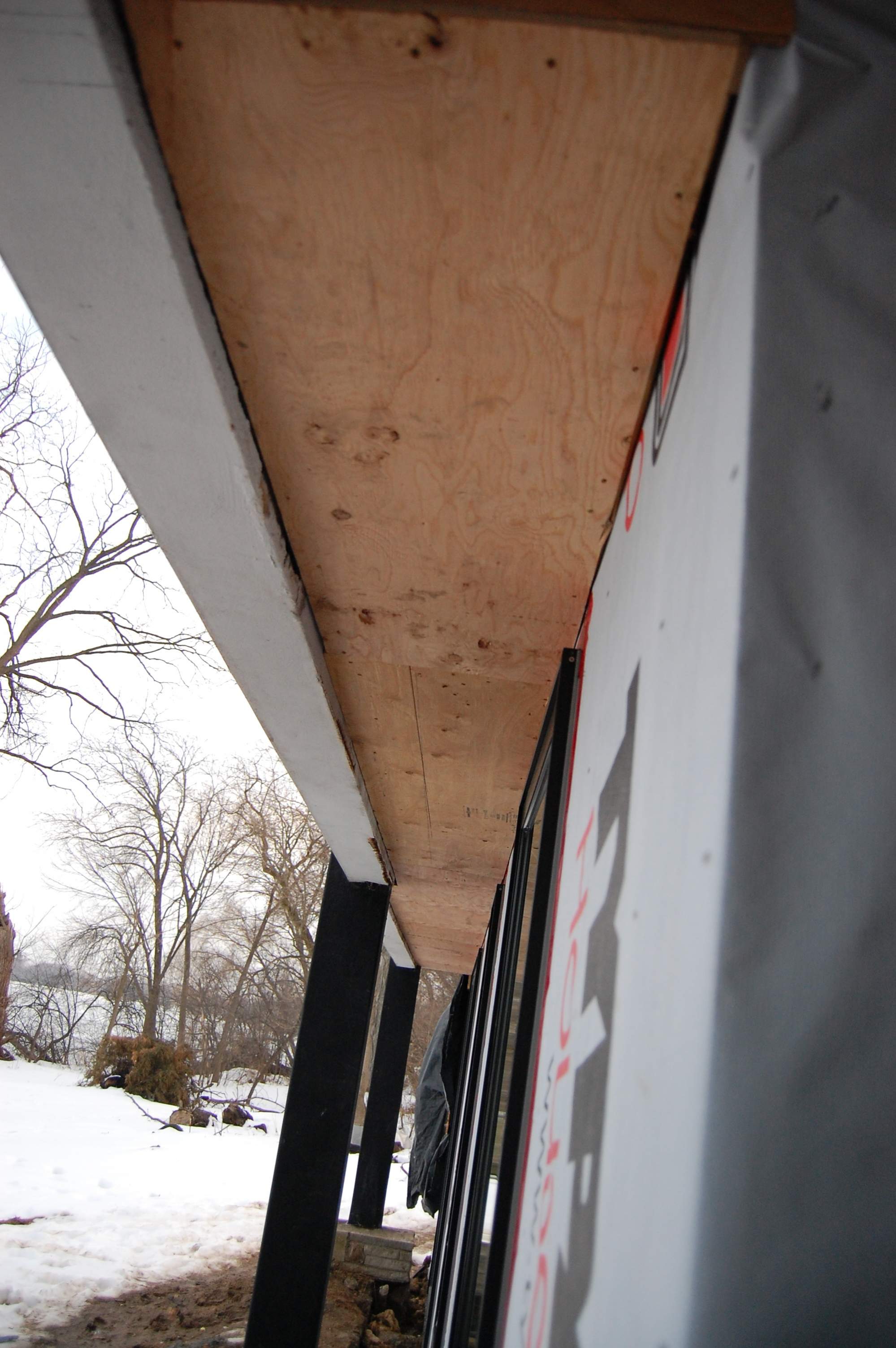

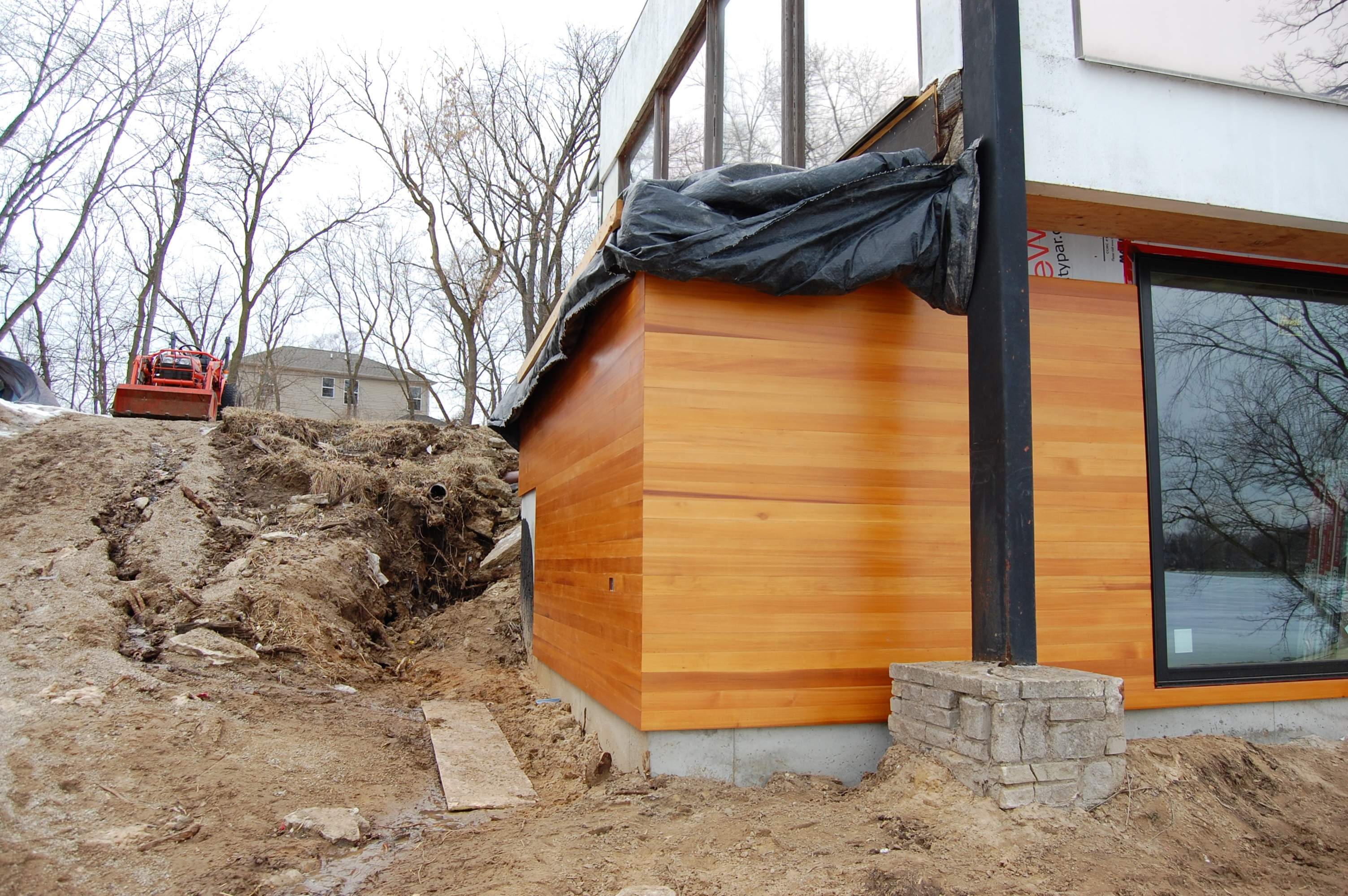

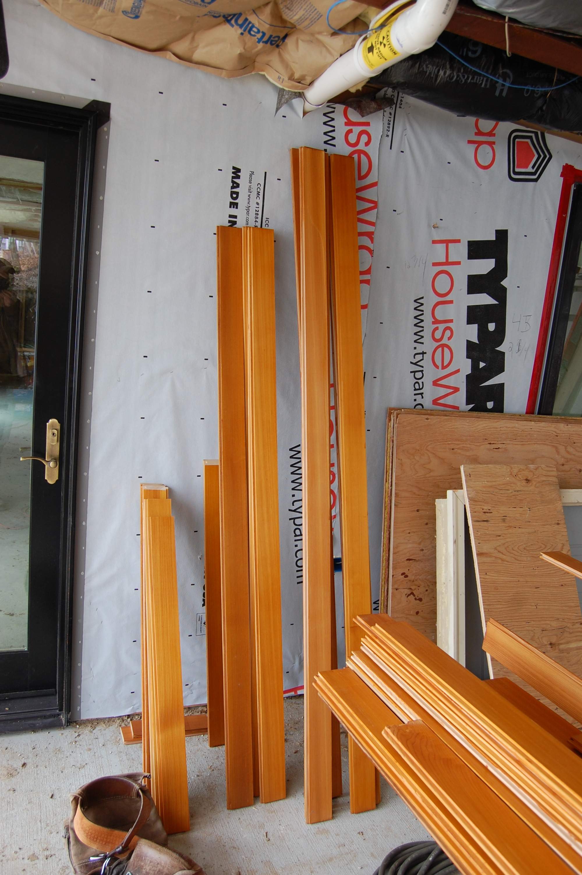

Some shots of the cedar going up. That was a fun day.

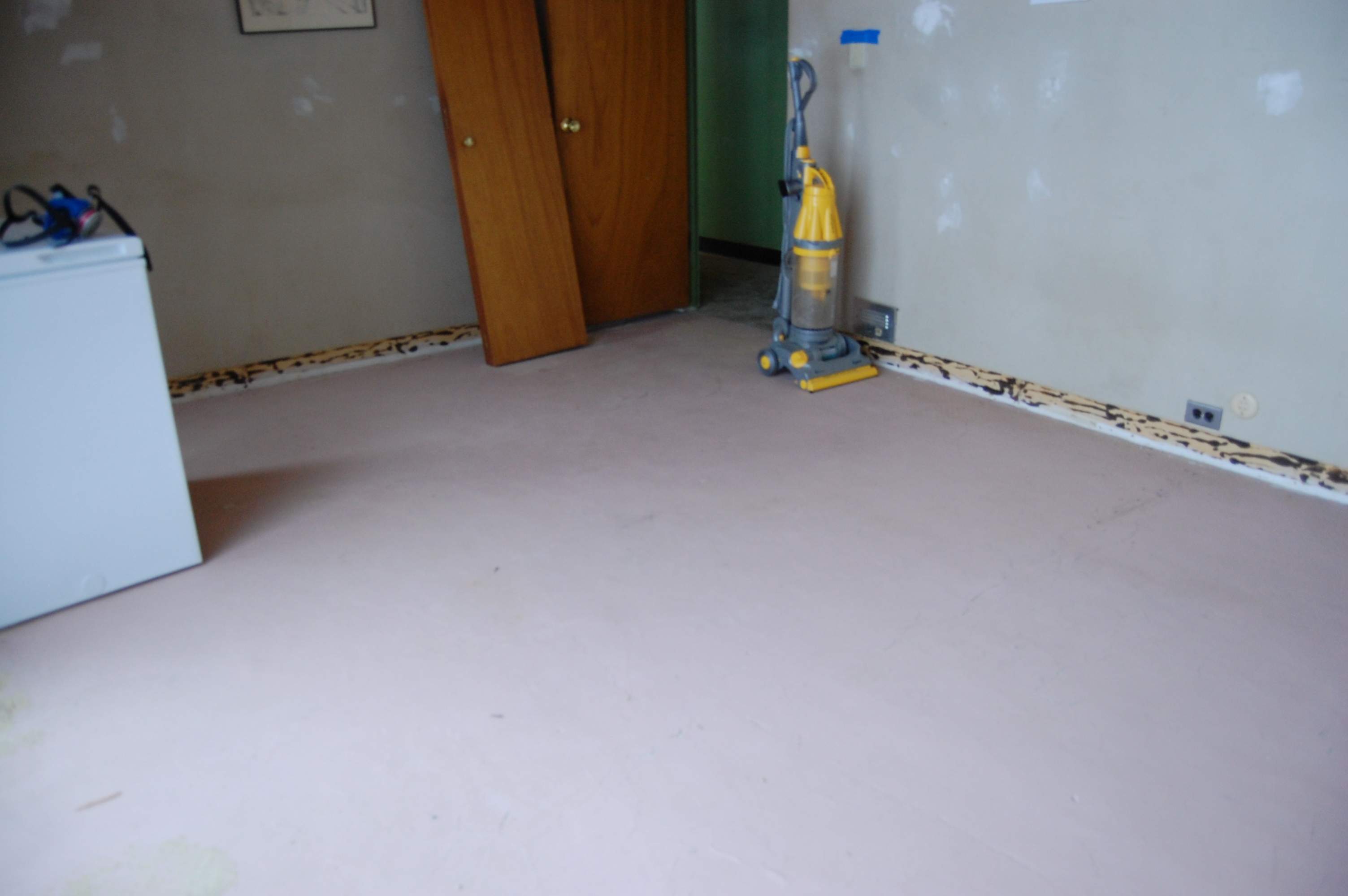

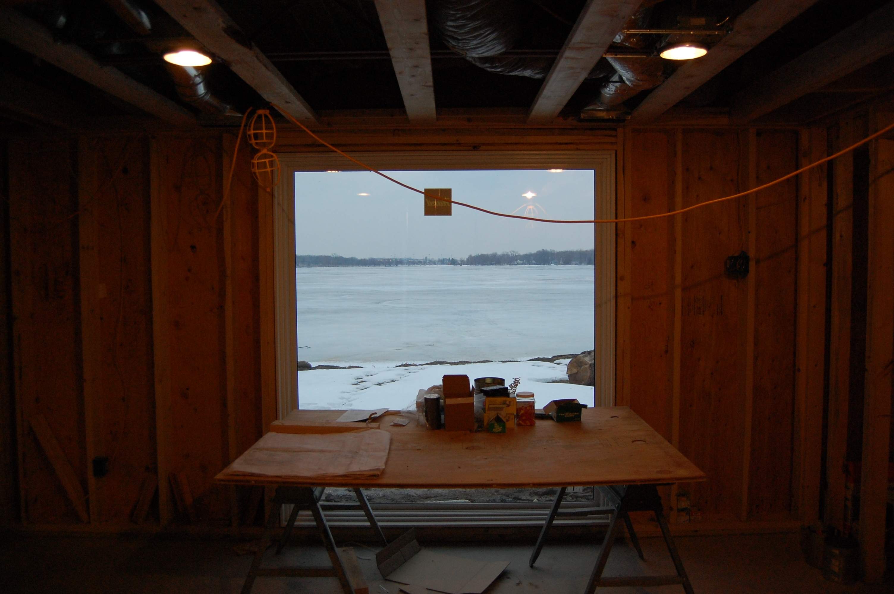

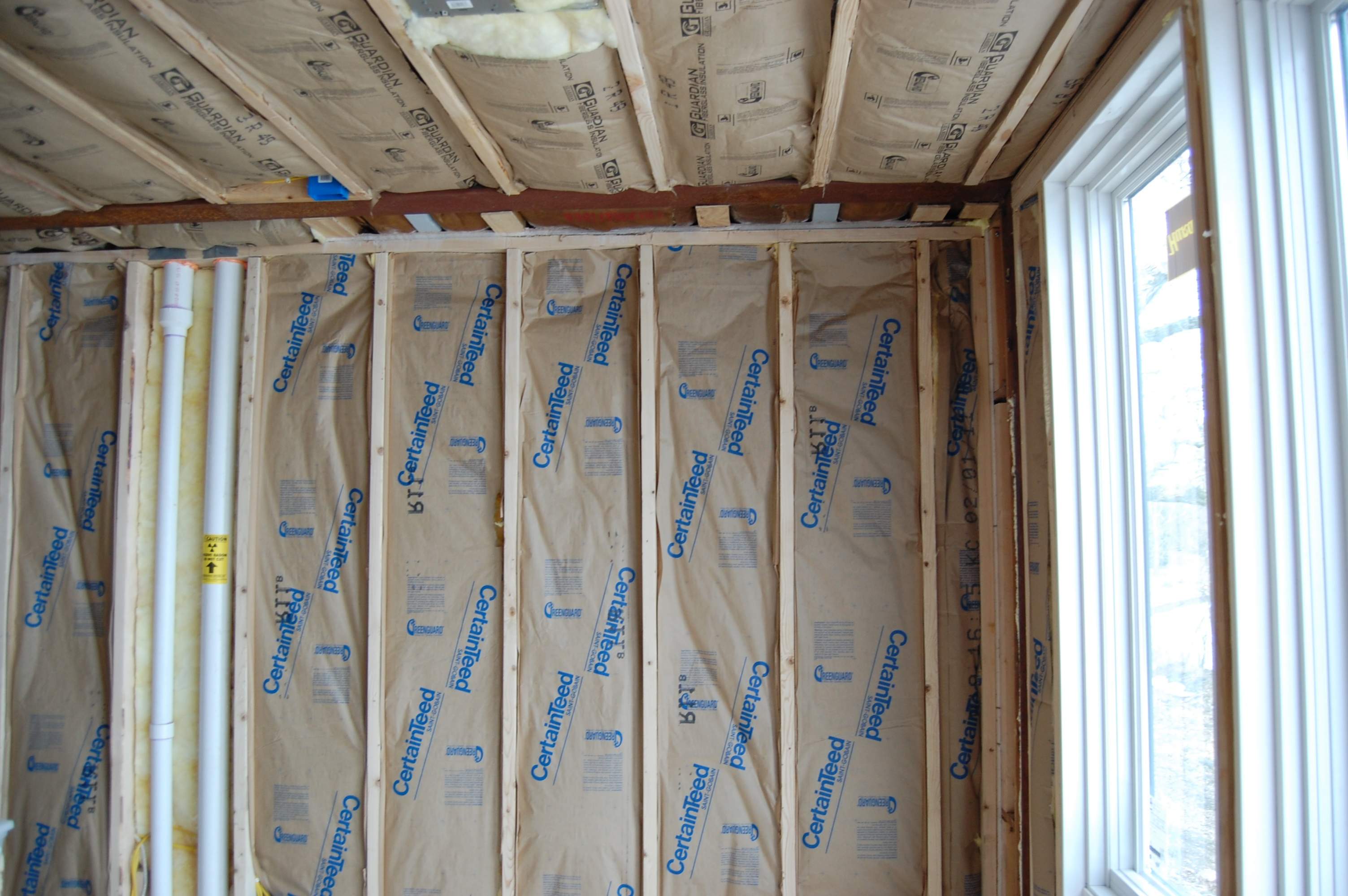

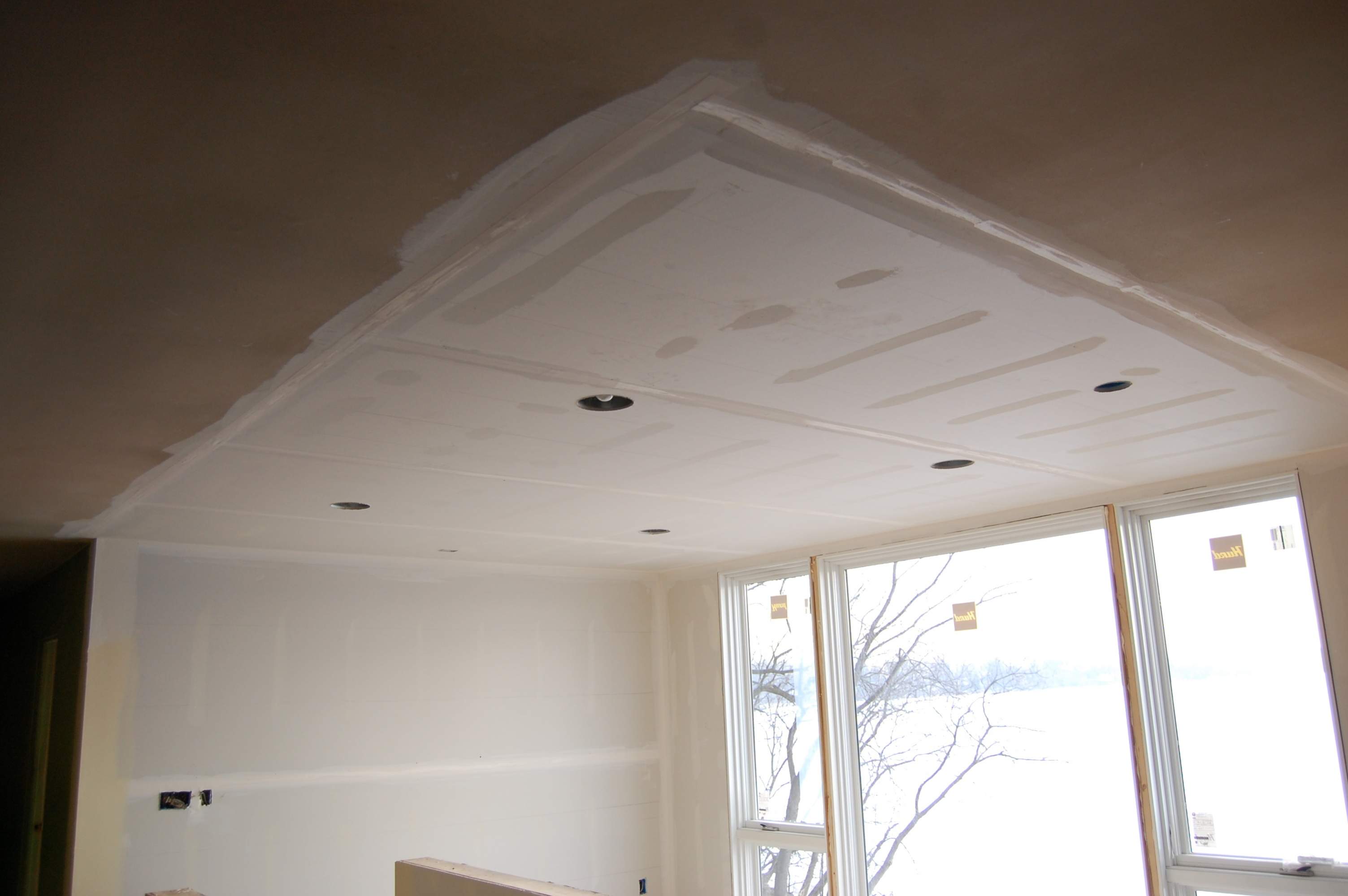

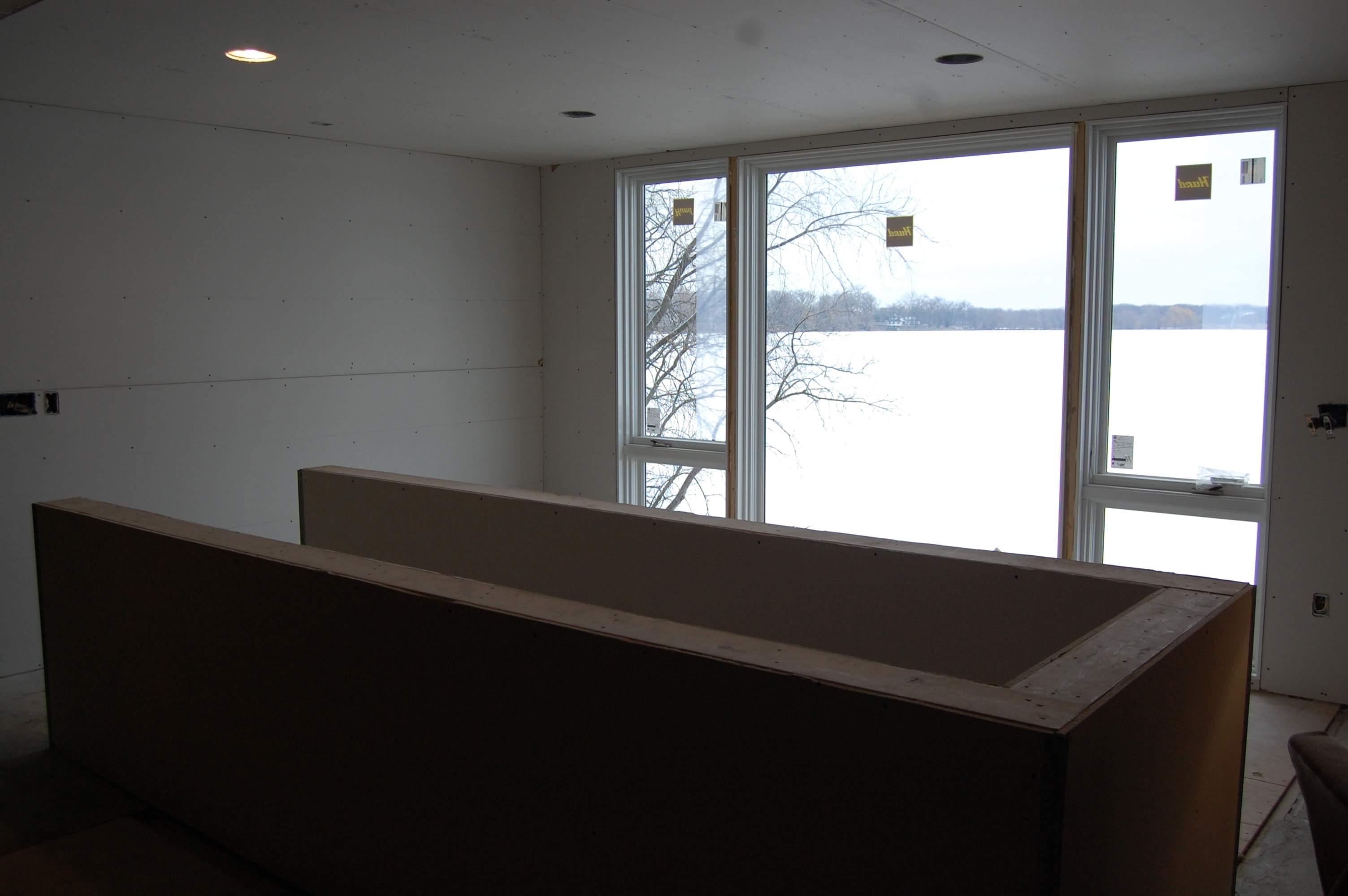

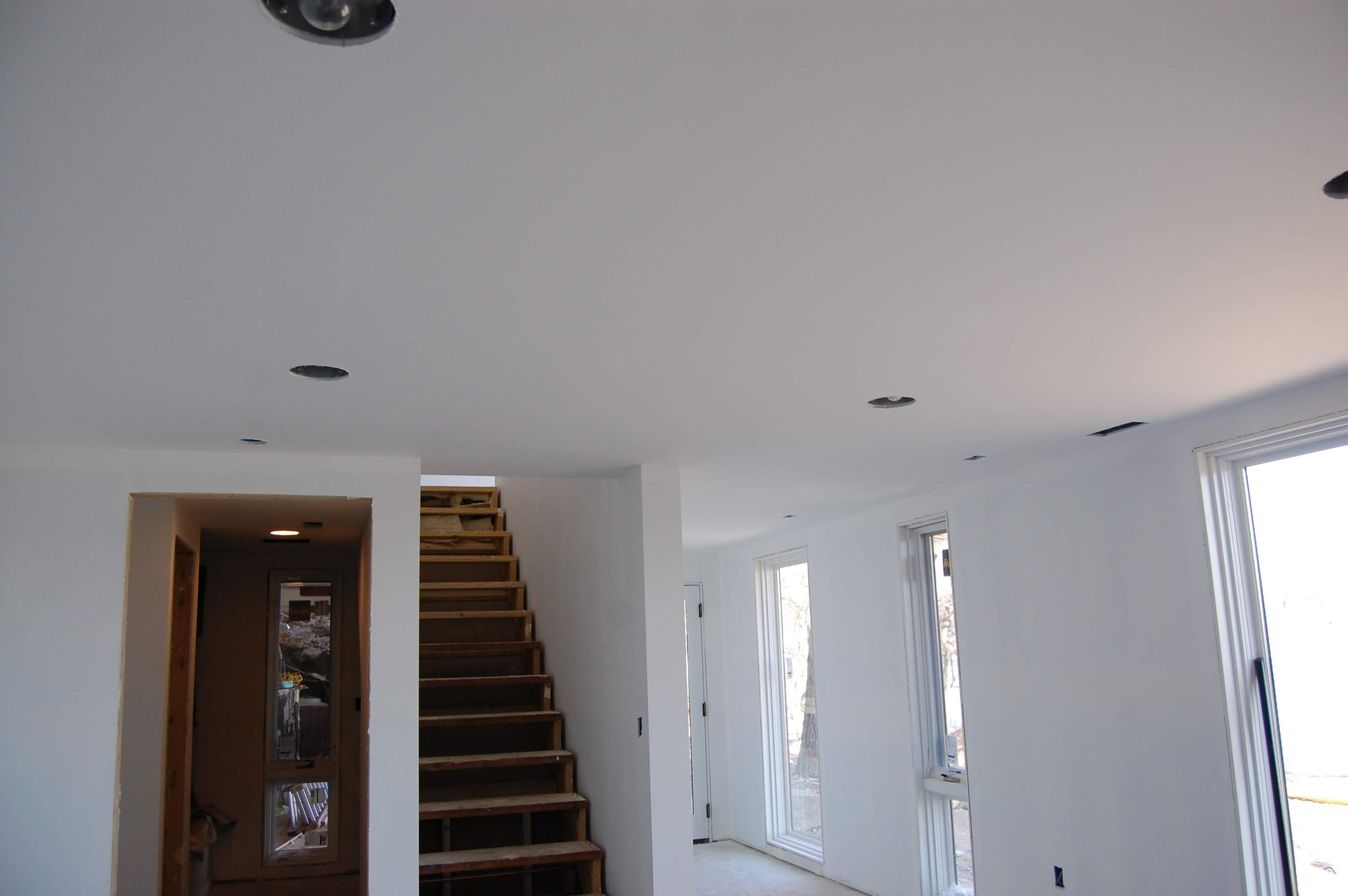

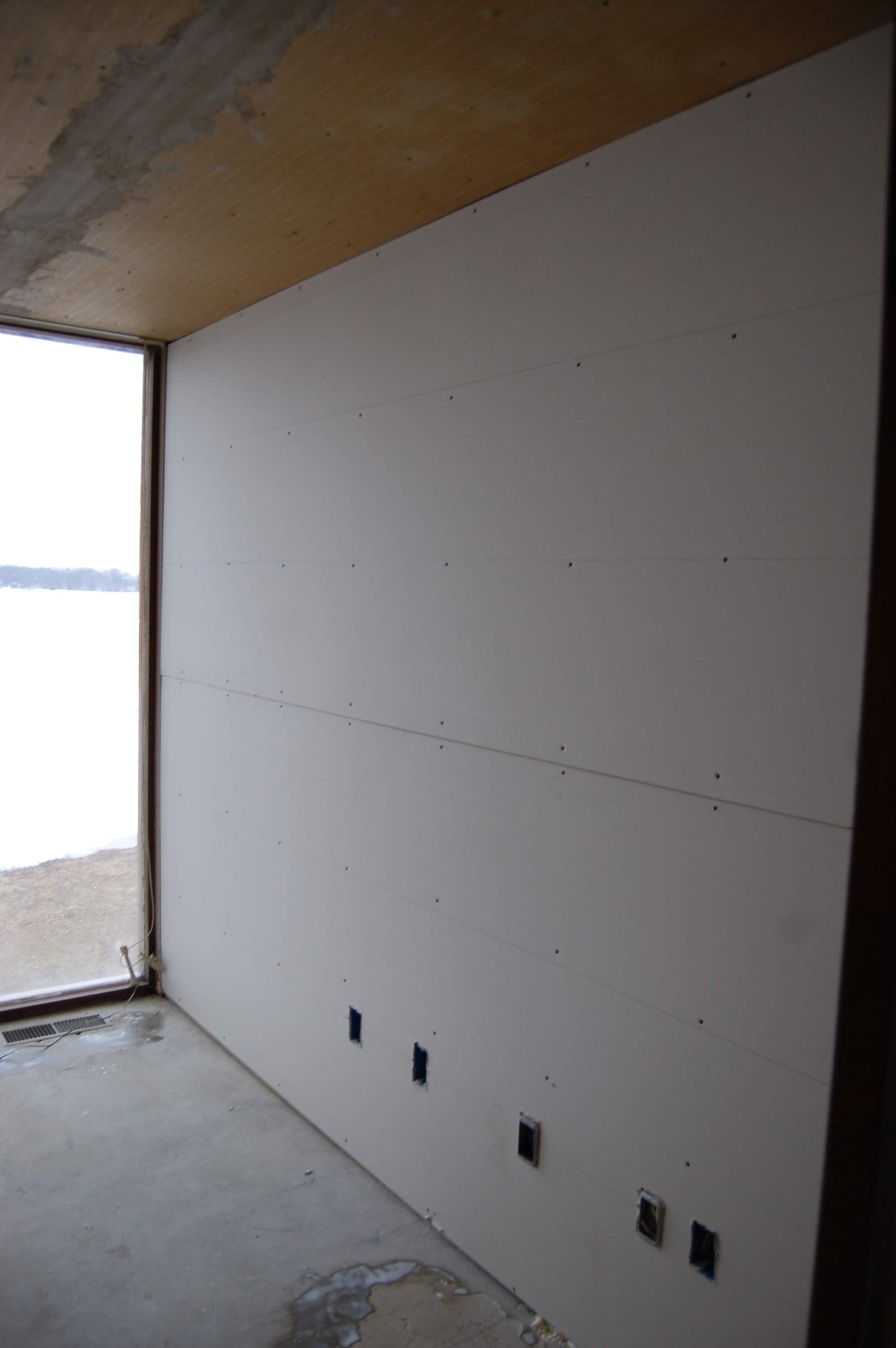

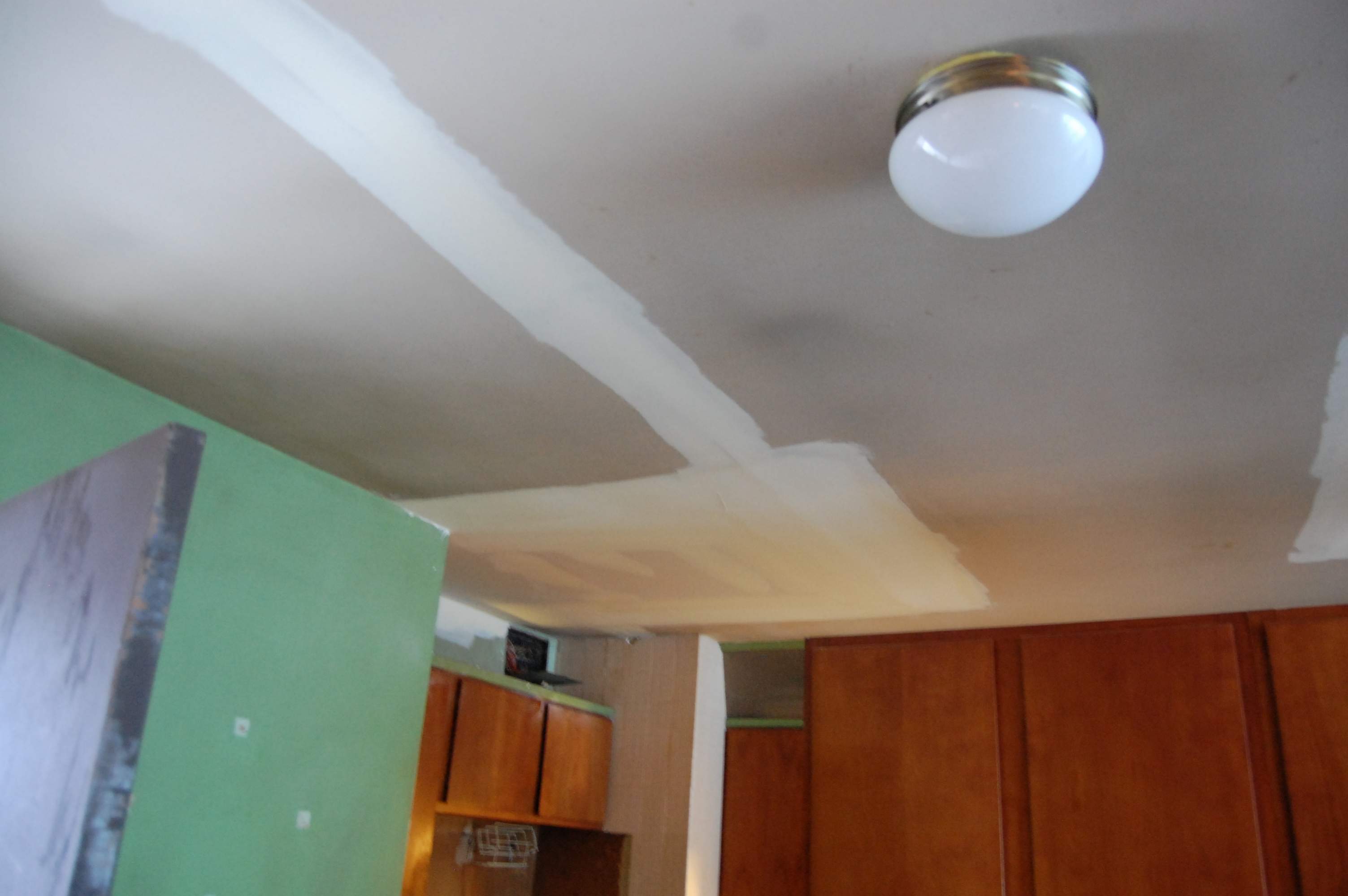

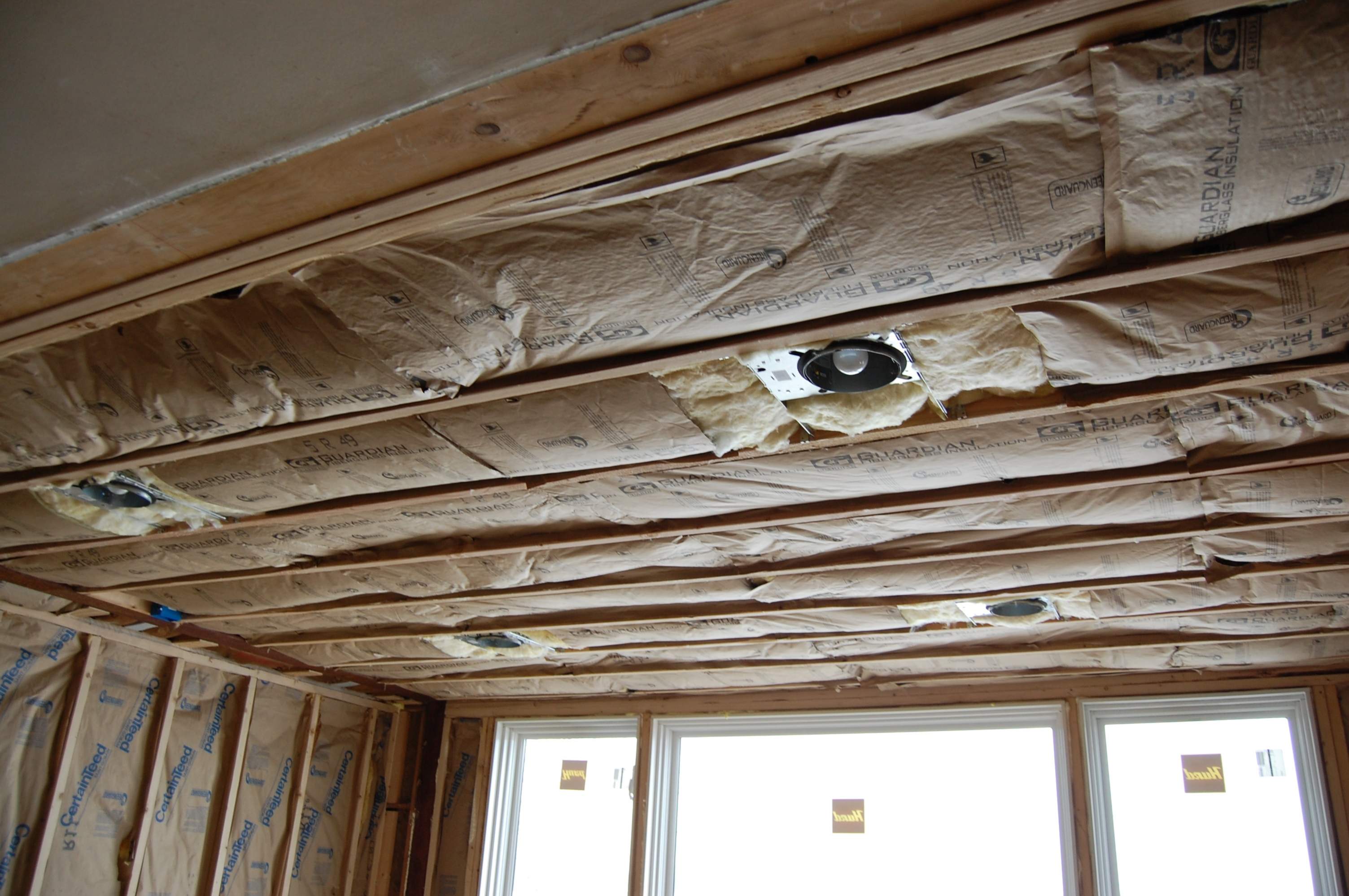

Forgot to mention we used blow in insulation in the downstairs addition, full thickness on the exterior wall ceiling on the lake side of the house in the overhang, and the extending closet. Then used several inches everywhere else covered by fiberglass insulation. The downstairs is buttoned up and is staying very cool - helps it is built into the side of the hill.
The following shots were of the drywall. First day 6 of the Anderson Brothers crew flew in and put up the board. Was fun to watch as it sure went up faster than when I did it....

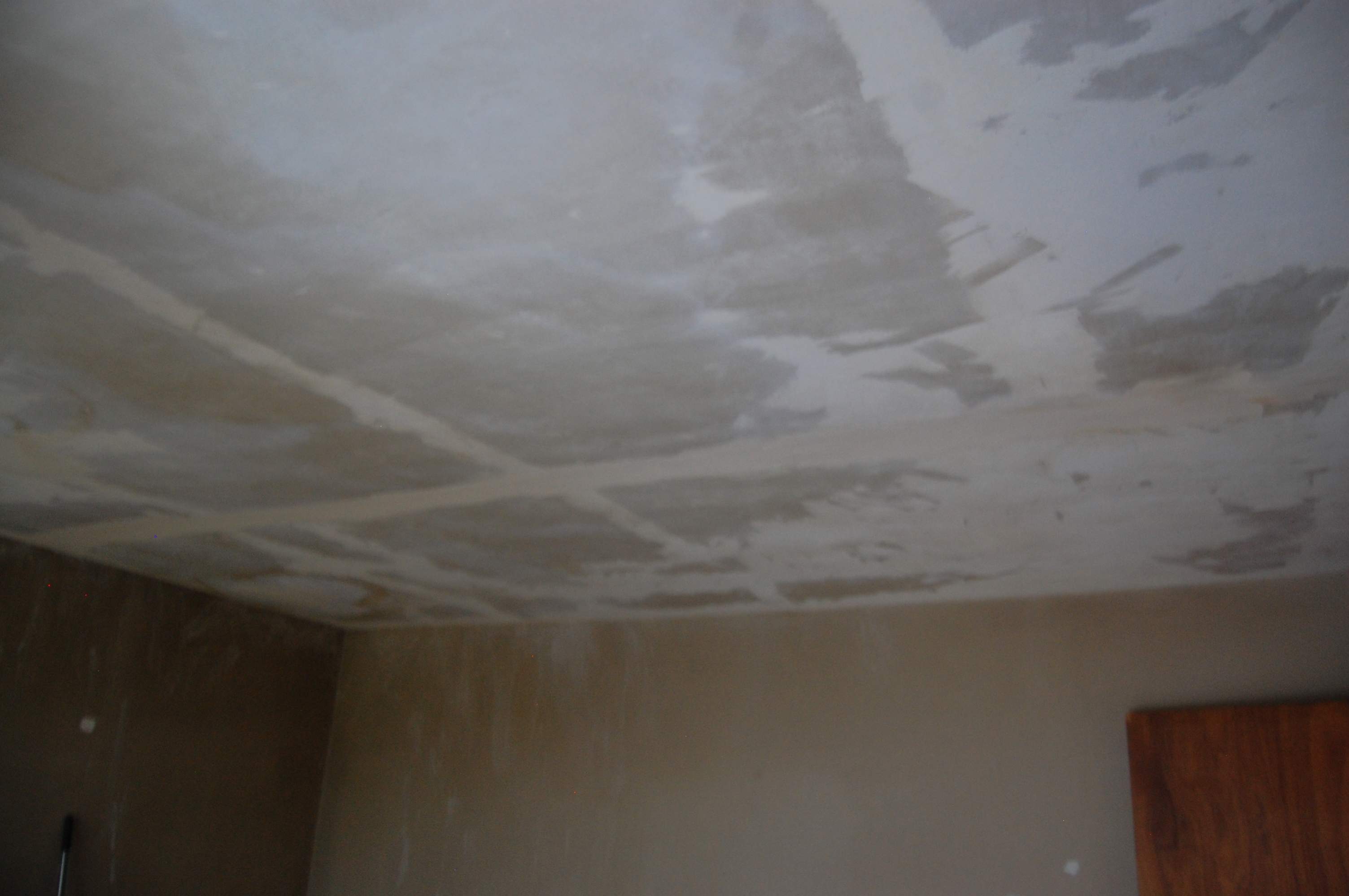

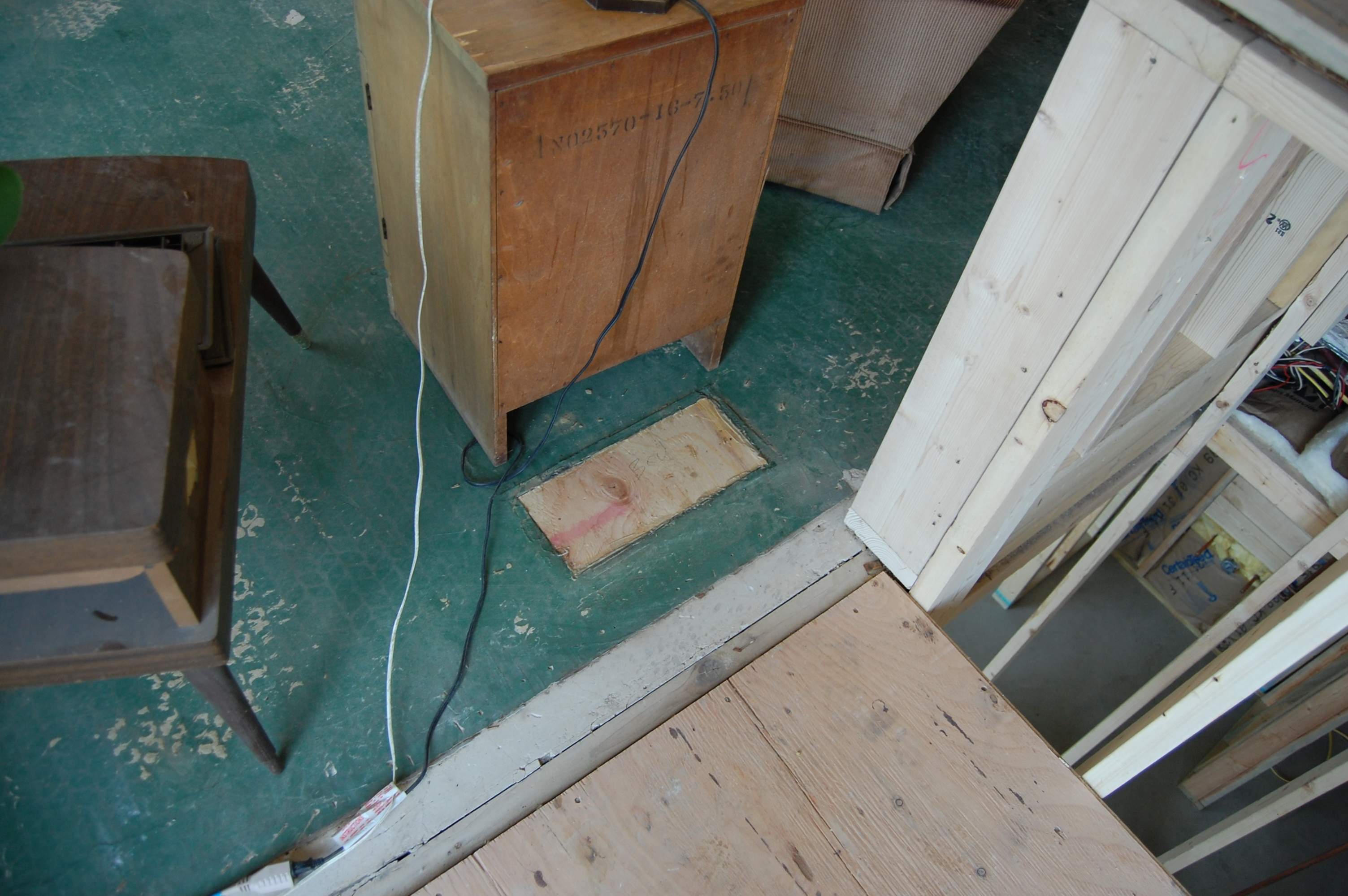

The first shot shows the guest bedroom ceiling. Both that ceiling and the den/office had to be skim coated fully as you can see there were the remains of the Thermolux heating cables. This was one of the newer technologies built in the original house. As the house was completely electric, there was an electric furnace/heat exchanger, electric floor radiators (about 4" x 12" - you can see them covered with plywood with construction adhesive).. and then the heated wiring that went into the ceiling. In order of expense at the time, it was the electric radiant heat (supplemental) you could see the electric panel smoke when they were turned on... followed by the electric ceiling heat..followed by the furnace. I recall we never used the floor heat, and the Thermolux ceiling heat burned out within 5 years of their build. The worst was my bedroom (now guest bedroom) and the office. You literally could see the burn marks in the ceiling, scary. It was stapled on top of drywall and then thin coated in place. I recall my older cousins and dad spending a weekend to redo those rooms, but stopped at putting up the new cabling - he never got it finished. Rather my mom surprised him and put in a new air conditioner and furnace that took care of that need... In other words she did not want to redo that experiment. The two brothers that did the finish work, went over those rooms completely with a drywall flat box - what great invention. They came back for four visits to build up the material and sanding in between. Outside of the exterior plaster work, I would say these guys took the most pride in their work, and it showed in the final result.

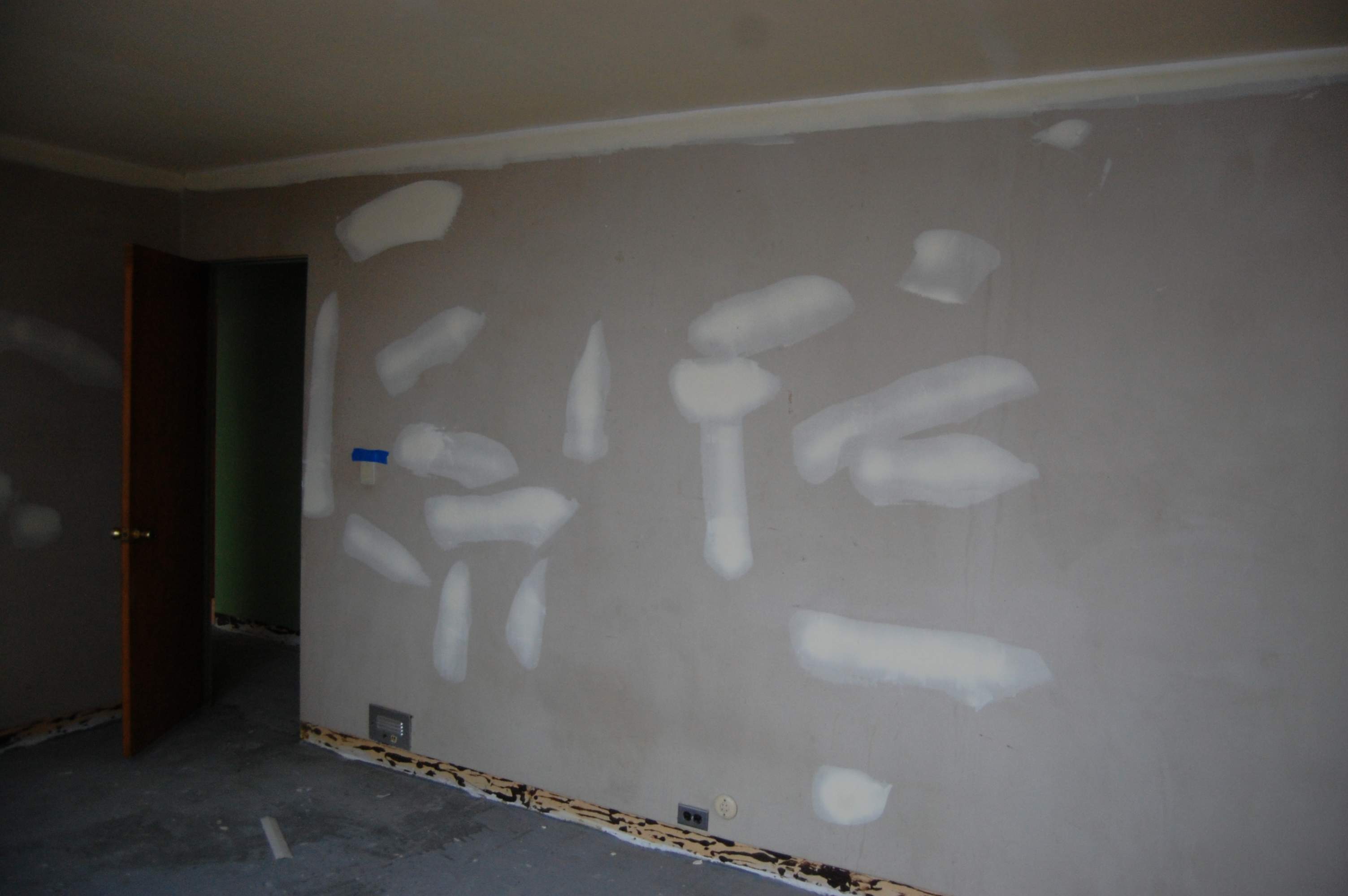

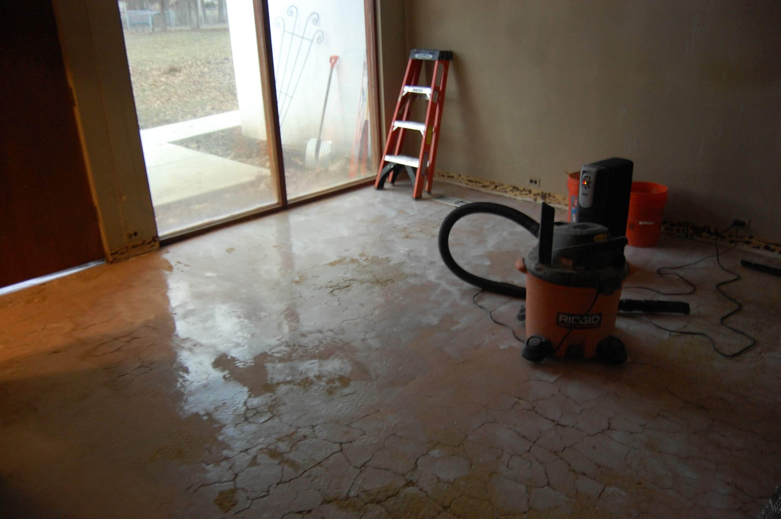

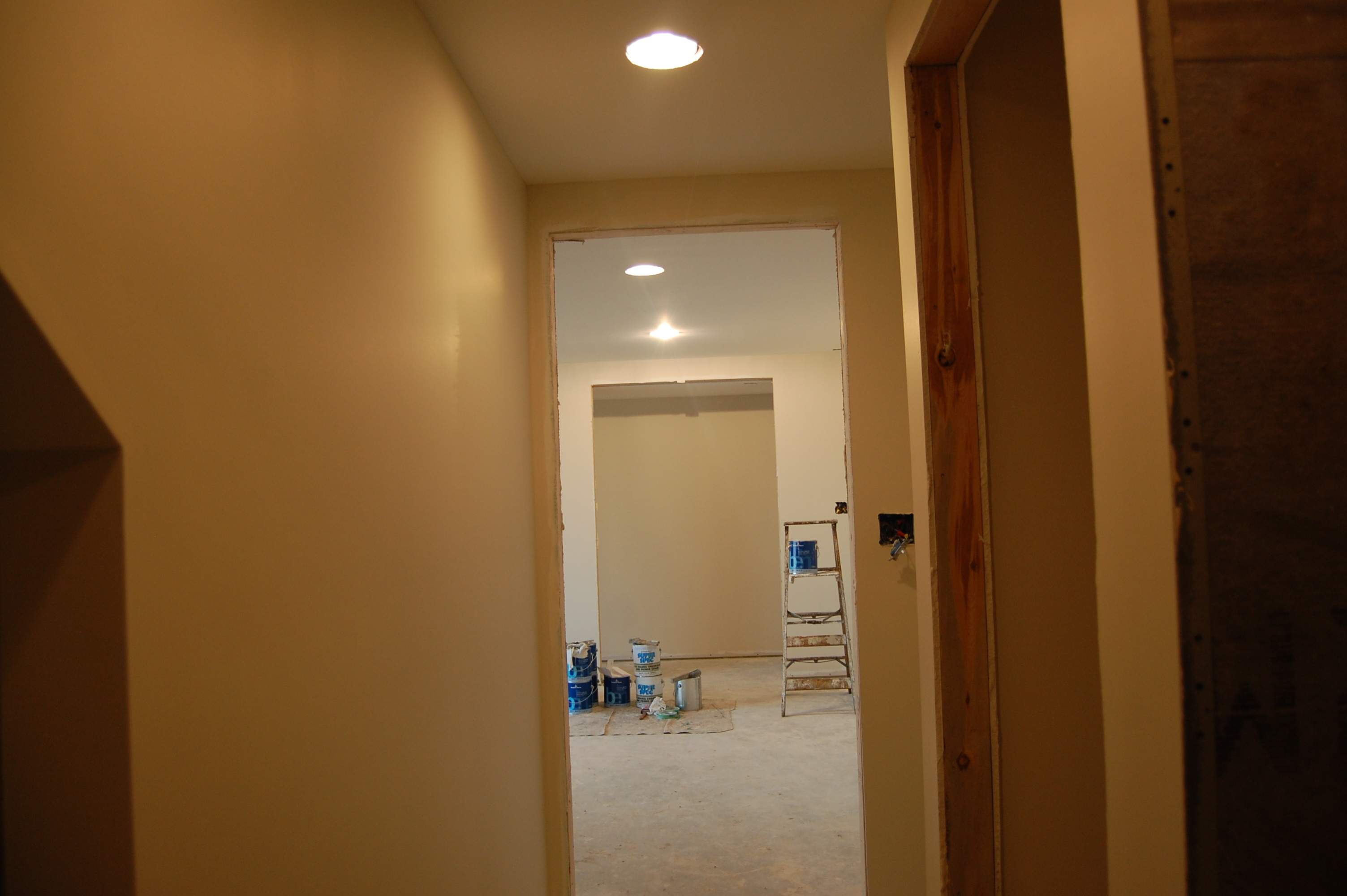

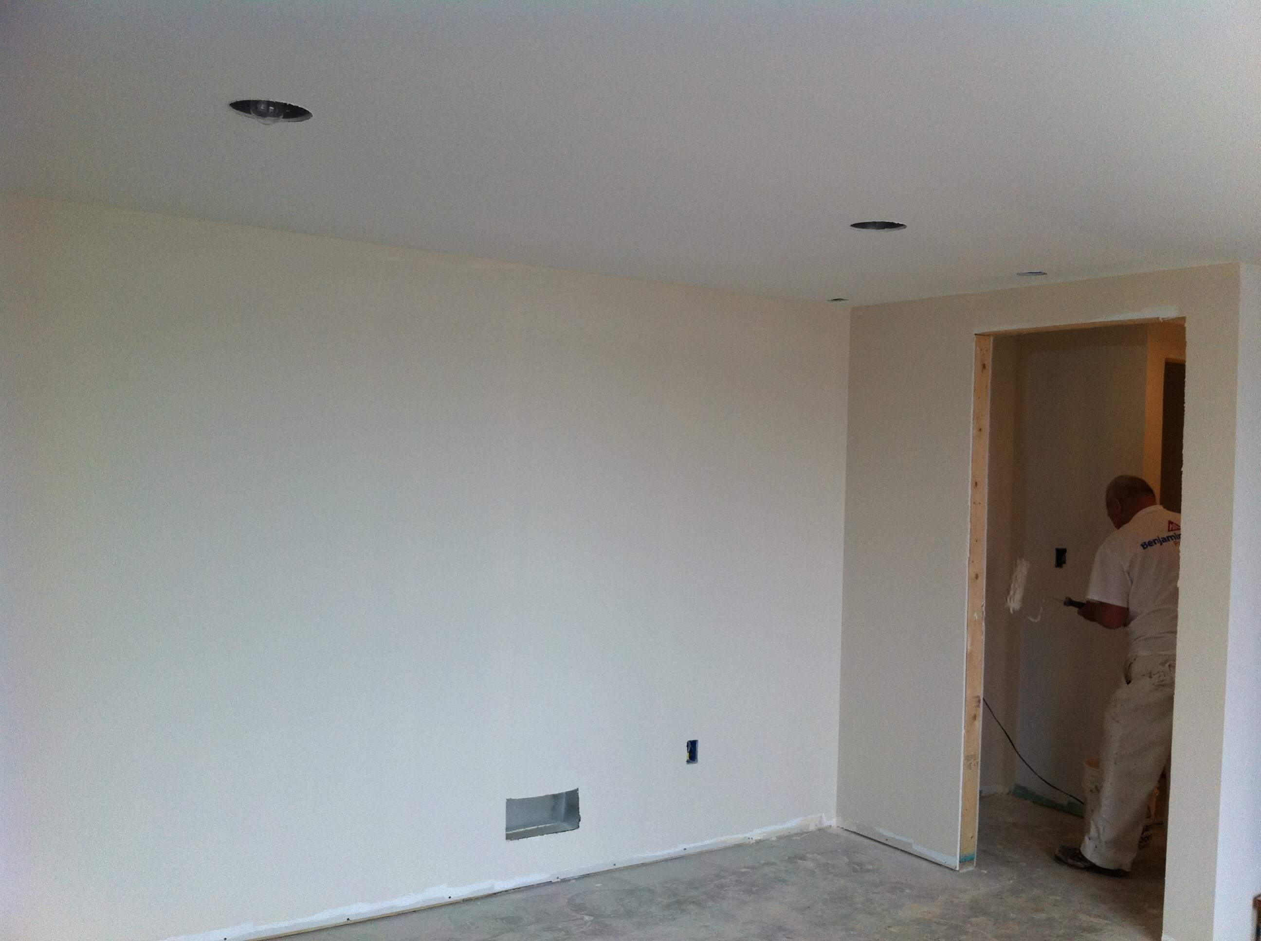

Next up came the painting, we had a family friend, Freddie Kakac do our painting, he came in at 1/2 the original bid and is a retired duffer that works more now than when he was working full-time... He had a million fishing stories and loved the fact that we had geese, merganzers, and wood ducks migrating through. Turns out he builds wood duck houses for fun, and we'll be getting about ten to start with. He's got about 200 wood duck families at his place...

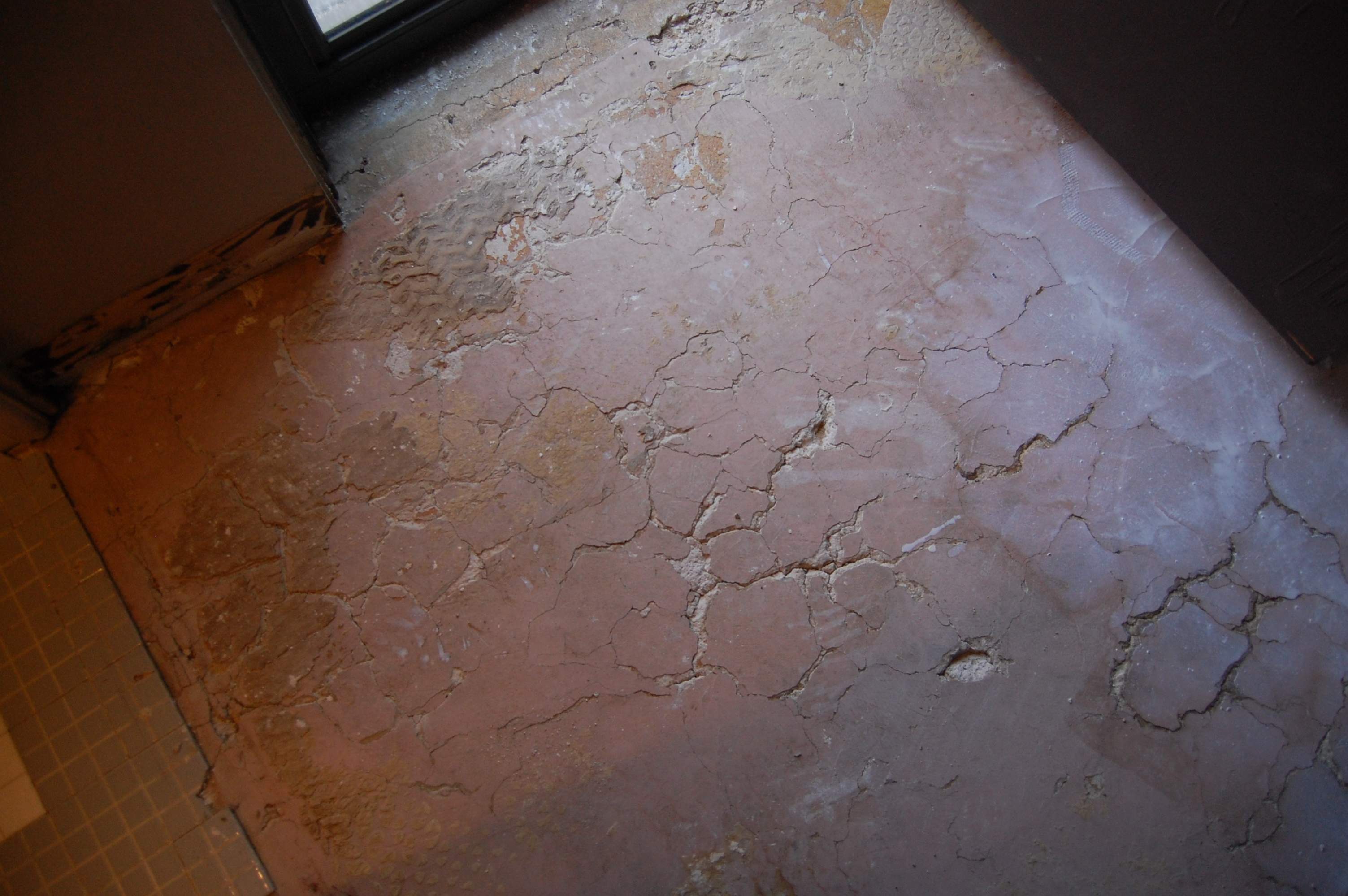

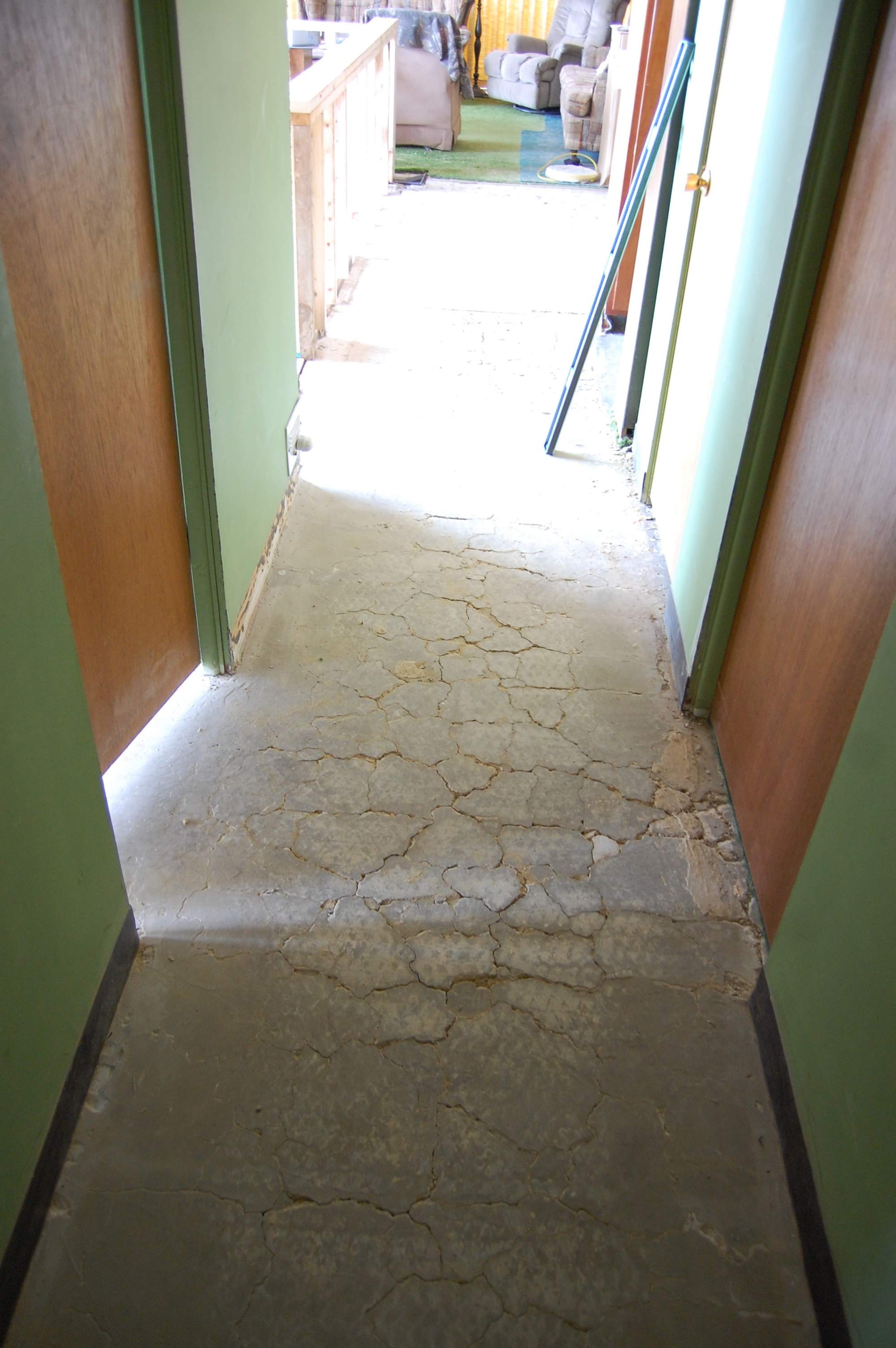

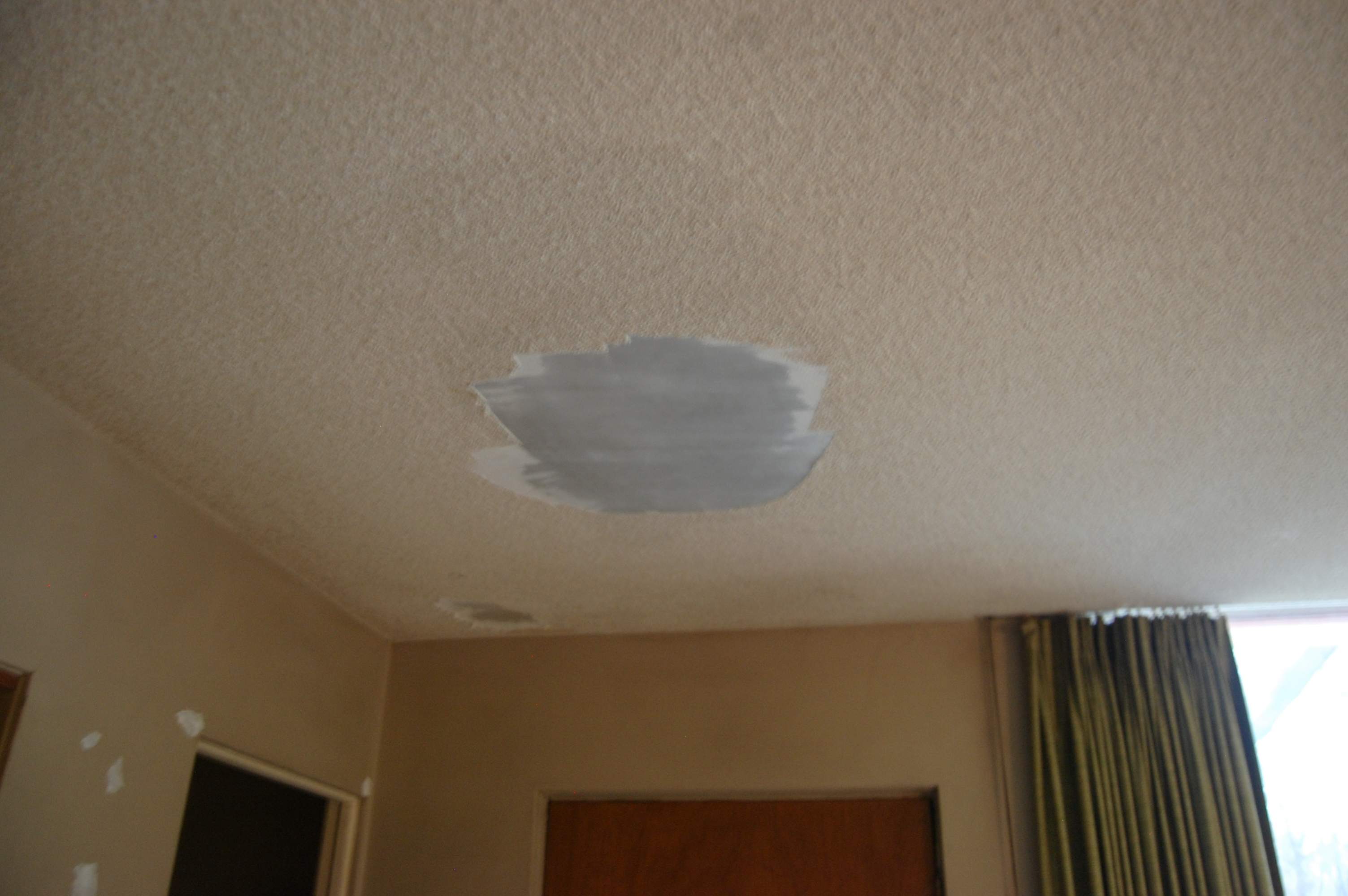

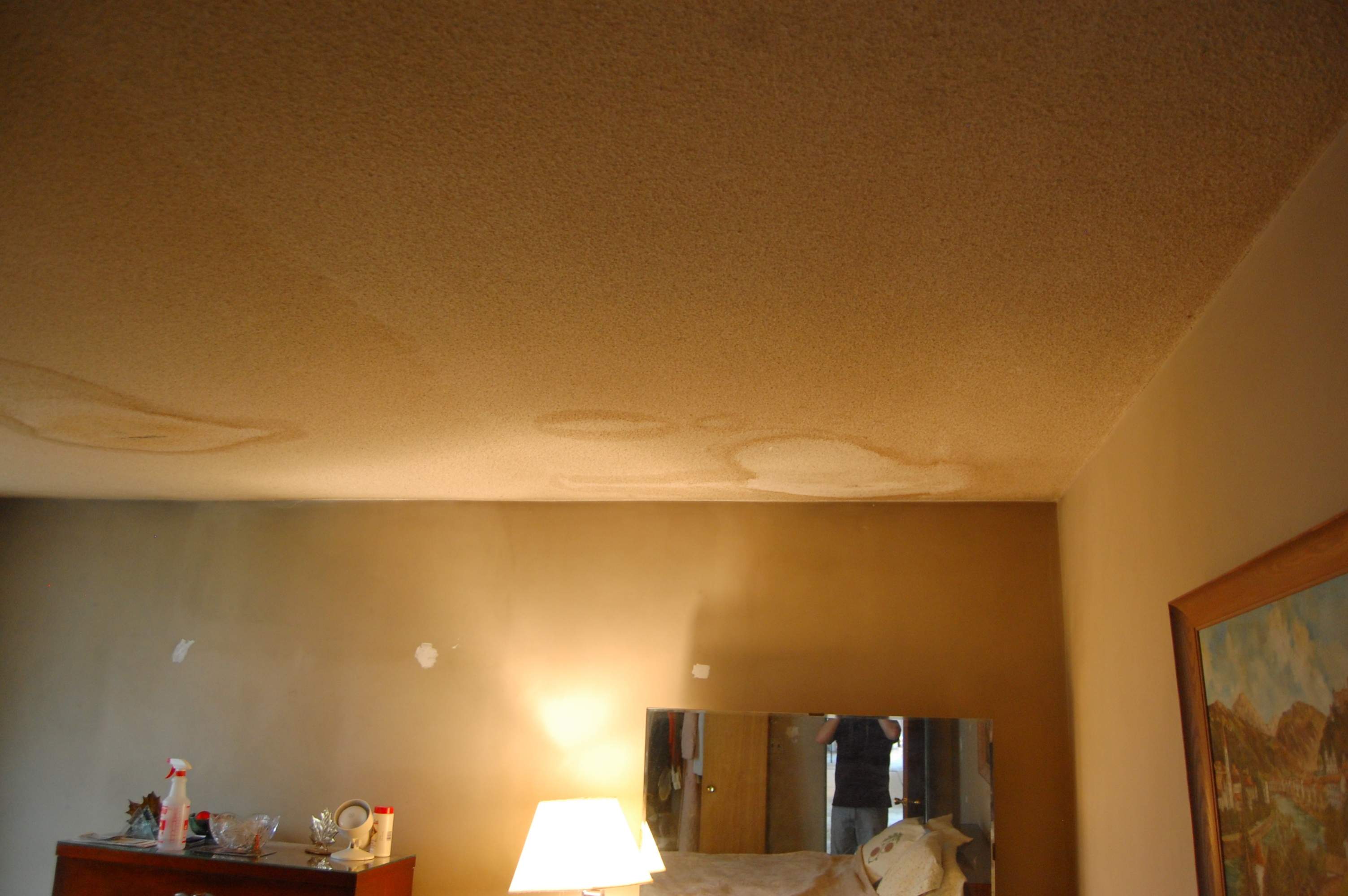

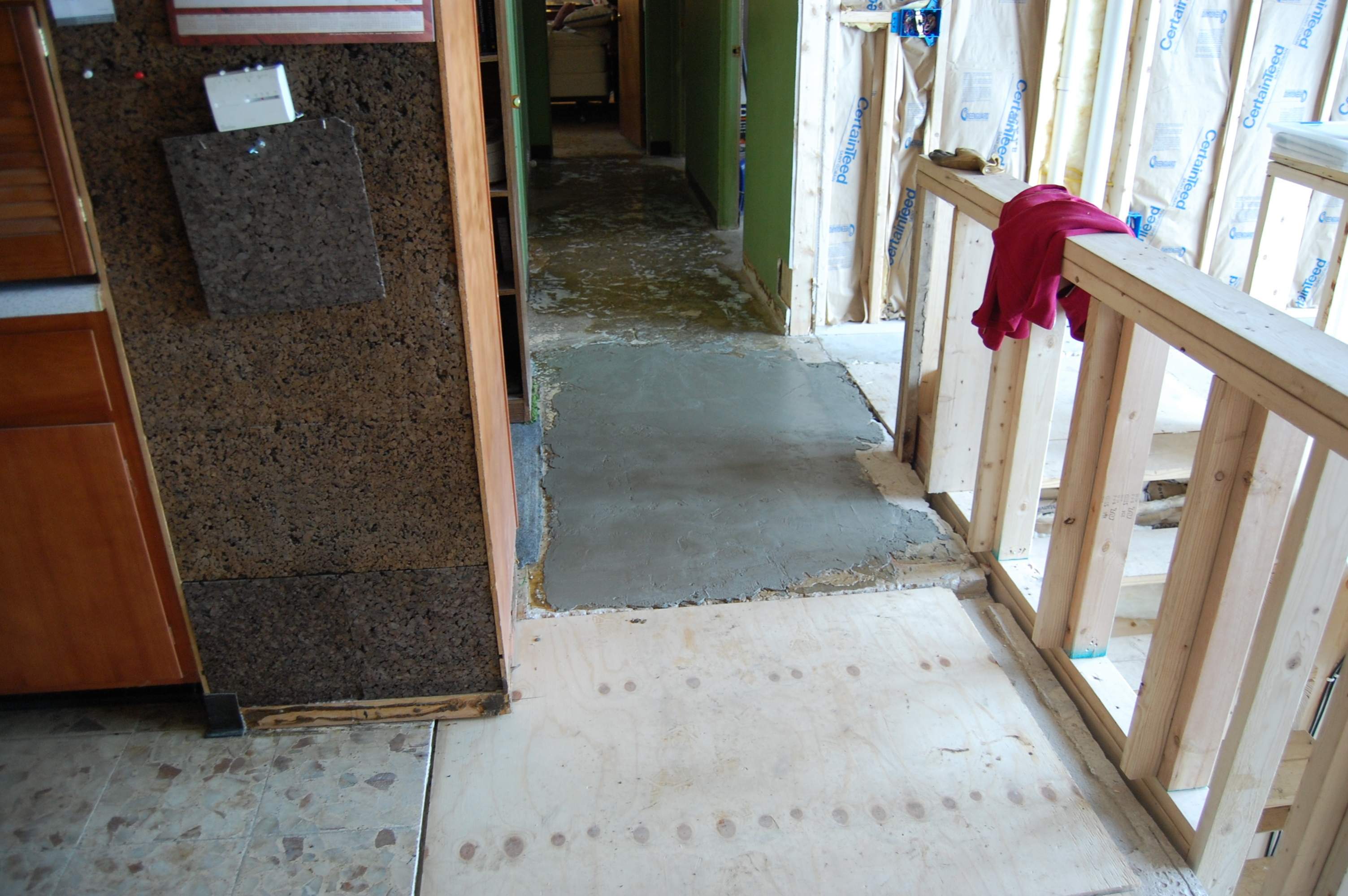

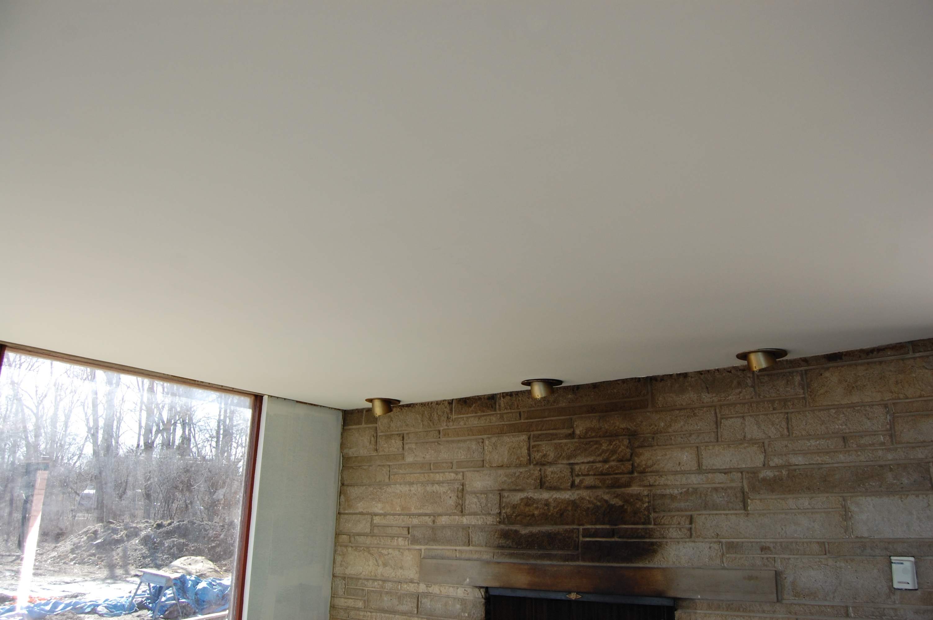

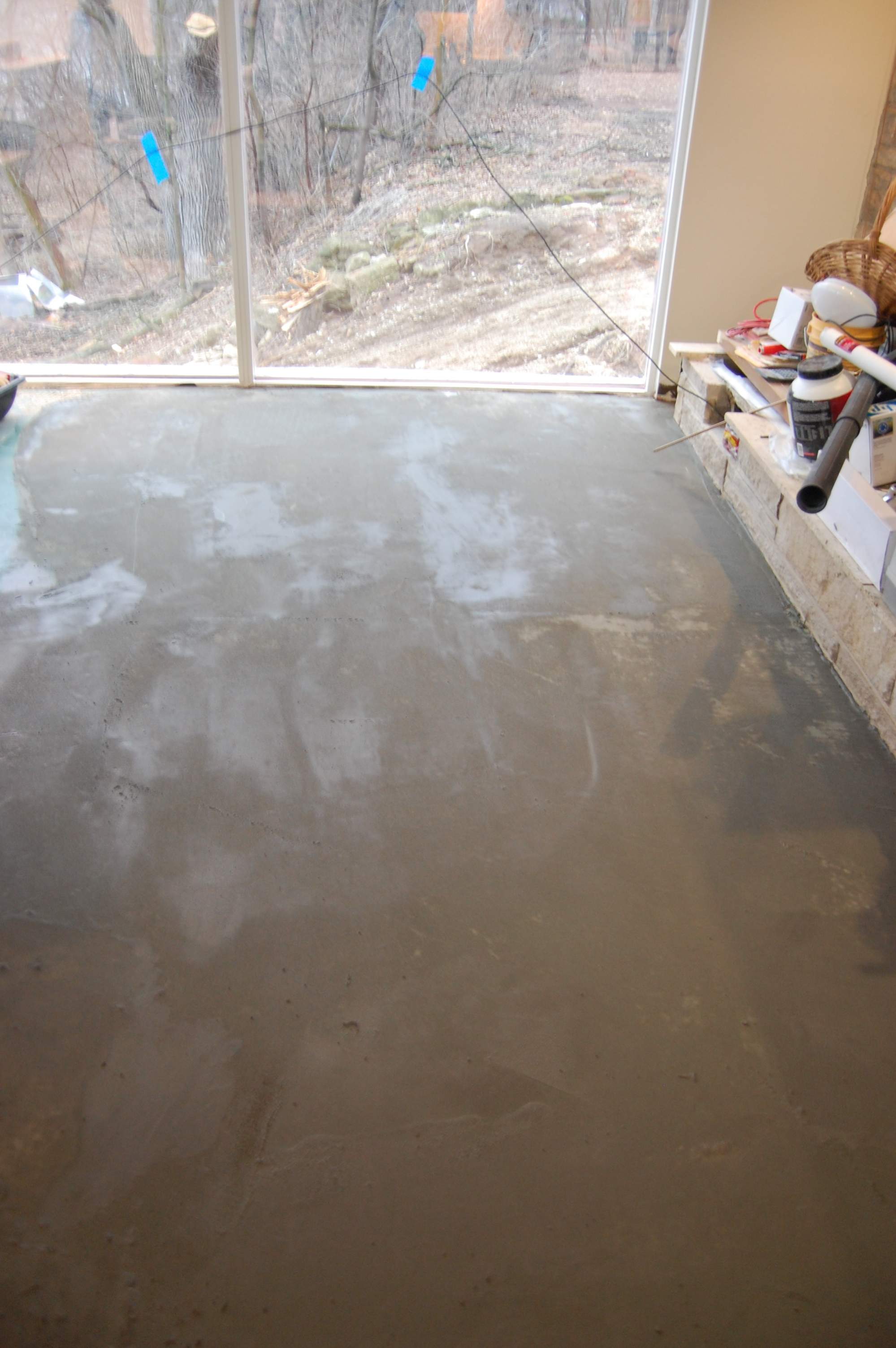

As Freddie began to paint we soon realized we were going to have to paint the entire upstairs to freshen up the upstairs. It would have been horrible to have the new addition, yet keep mom's bedroom and area dingy and dark... Unfortunately this meant I had to fix her ceiling as it was water stained from the roof failure sever years earlier. To make matters worse it had a popcorn ceiling.. So, took a hose on fine mist, doused the entire ceiling and took a 6" drywall knife and scraped it all down. This went much faster than I anticipated, and the thin coat my dad and grandfather put up originally was smooth and hard as glass. All I had to do was build up the crease that sagged due to the water weight on the joint. I took the same approach as the pros and built it up over 4 days and sanded in between, it did not turn out as good as theirs, but after the primer and two coats of paint it looks rather good. She also had failed concrete flooring so i just finished putting down the self leveling concrete to allow it to set before Freddie hit it with primer and paint.
