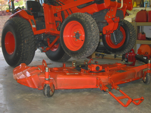

Took me little of no time to remove the deck. Usually less than 3 minutes.

   / Mid-mount mower deck removel #23
That sure is one way to do it!:D

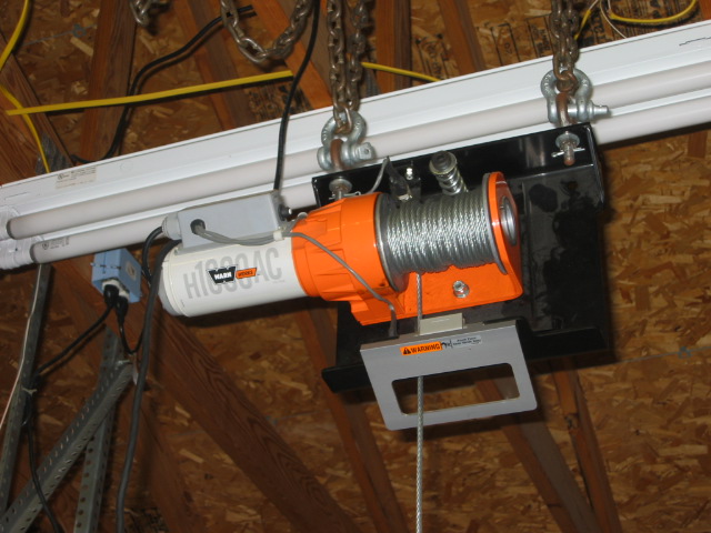

I have a B7800 with a 60" MMM and it takes me all of 3 minutes to take it off and perhaps 4 minutes to put it back on. I don't use a hoist or FEL. It really is easy. I use a ceiling mounted winch to lift the MMM mower for maintenance - that is handy - I'd hate to have to flip it over by hand or use the FEL.

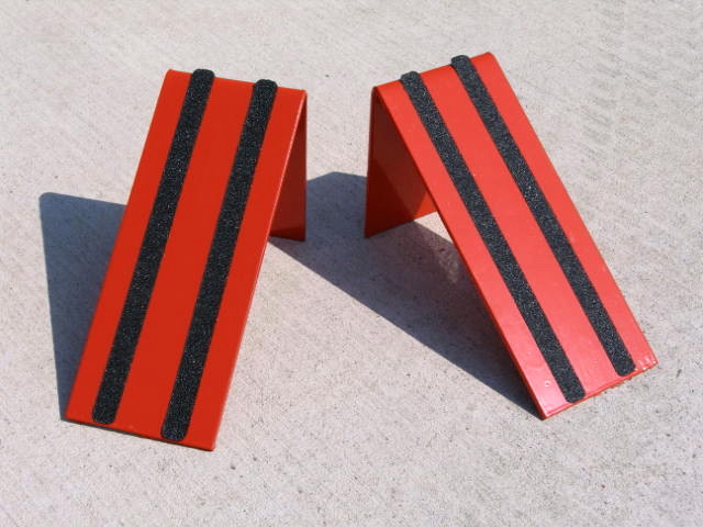

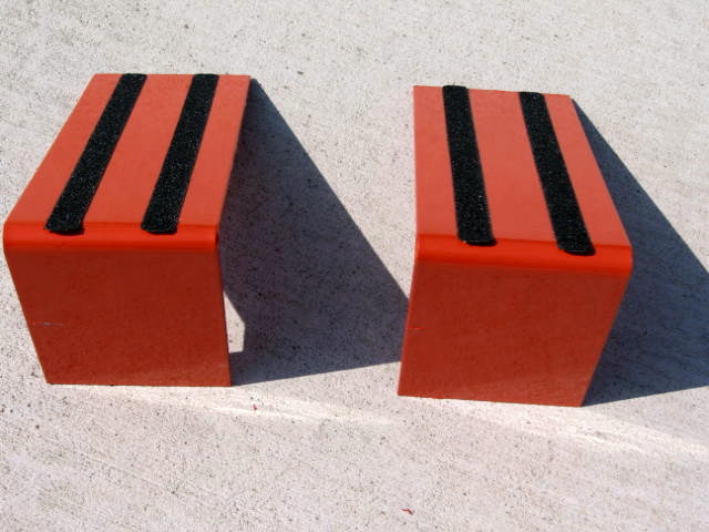

Solved my problem of removing & installing deck. I had these ramps made up similar to the new B-series drive over ramps. They work great and save a lot time and swear words.
