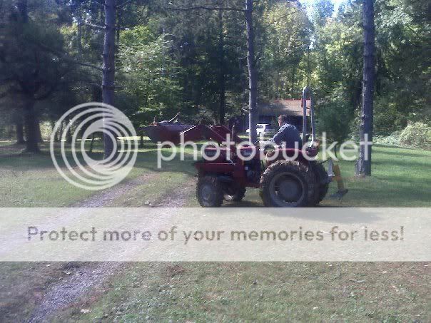

I bought a middlebuster for my 30 hp tractor. If I use a long toplink the blade is parallel to the ground and doesn't dig. If I shorten the top link the blade digs but pulls back so far that the top link gets pushed forward and the middlebuster pulls back so only the point touches the ground. I know this is not a great description but if someone else has had this problem maybe they will understand what I am talking about. It seems like the shaft on the middlebuster is too short. Any suggestions? As far as I can tell my 3 pt hitch is not adjustable. (Massey Ferguson 220-4).

Thanks for the input. Compared to the pics, my top link is attached much higher on my tractor. It is on the lower connection point but it is still too high. I guess that is why I say the shaft on the middlebuster is too short, blame the attachment. My tractor is probably too tall for the class 1 middlebuster. My rear tires are over 4' tall.
The idea of a chain to the drawbar is a good one. I'll have to give that a try since my anchor point is too high. As far a pics, the best I have is one taken by a friend with his cell phone. Not great quality but it shows how I have it mounted.
/ Middle buster flipping over!

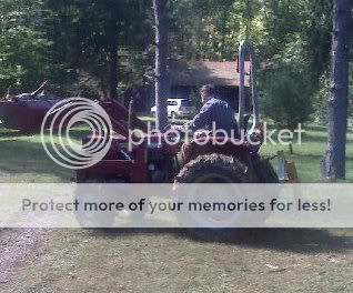

You can sort of tell from the pic but when the middlebuster is lowered the top link angles downward.
/ Middle buster flipping over! #8
The picture is a bit distant, as you say, but still, it does look as if the implement is a shorty. Unless your 3 pt lower arms can descend to a very low position, ie, just a few inches from the ground, I'd say you'd have difficulty going very deep with that particular plow. Nice plow, but as you say, might be too short, not long enough in the shank for your tractor. The good news is that these plows are inexpensive and you'd have no problem selling yours.
I've seen these plows at TSC in differing shaft lengths. Mine is approximately 36" tall, holding it standing, on cement. You'd likely want one 6" taller.
/ Middle buster flipping over! #9
Are you sure you have the blade attached correctly? It looks like the bottom of your blade is level while the middle buster is leaning forward. The blade should be angled down (point down) when the main beam of the middle buster is plumb or even leaning back somewhat.

I tried making the pic a little bigger:
Second that. Check that the bolts are still tight between the blade and the frame. Looks like the lower bolt may have sheared or loosened, allowing the blade to tip up some.
-Jim
/ Middle buster flipping over! #13
Looks to me like they might have put a middlebuster plow blade on a subsoiler frame.
If you look at a subsoiler and a middlebuster side by side the mounting surface for the blade is more parallel to the ground on the subsoiler.
Could be wrong...just my thoughts.
/ Middle buster flipping over! #14
That blade is way too parallel. I also think you have sheared a bolt or the mount is wrong. Maybe subsoiler like someone else stated.

Thanks guys. I checked and the bolts were tight. I took it to TSC and it was mounted right (they said). I think it might have just been too short for my tractor. I swapped it for a subsoiler.
/ Middle buster flipping over! #19
I'll second or third that being a subsoiler shank with a middlebuster plow bolted to it. Also, if your TSC is anything like mine, I wouldn't put too much stock in what they say.
