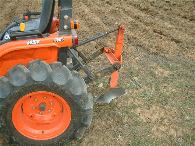

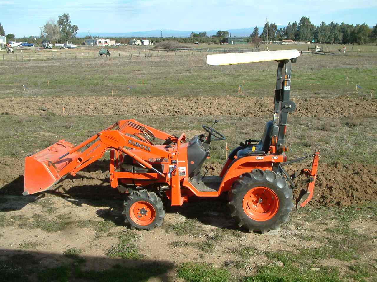

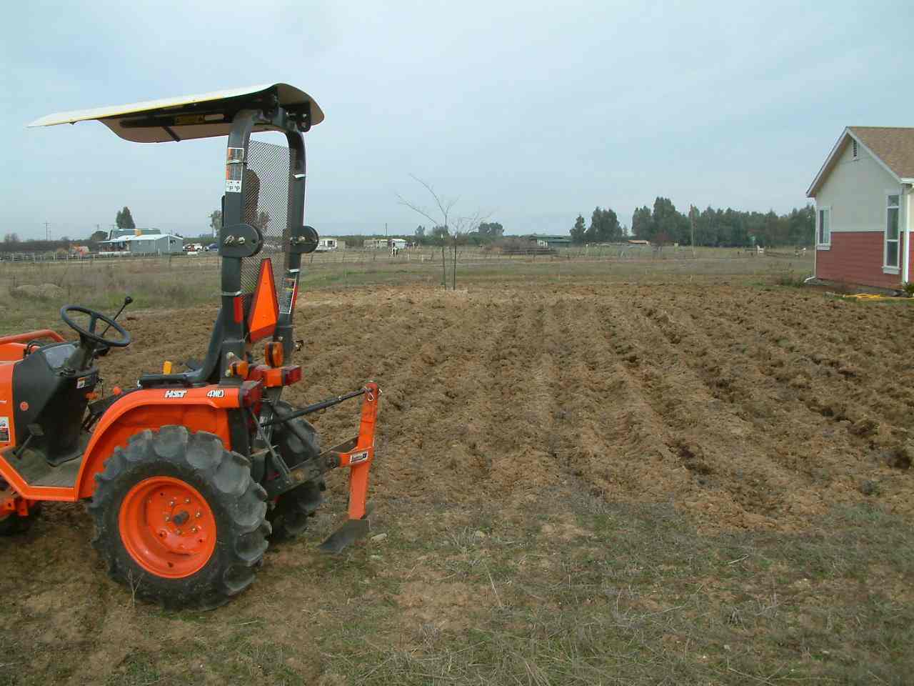

The photos show the shovel upside down. Shortening the top link too far will angle the shovel perpendicular. The shovel should be at the right angle when the support bar is perpendicular (90 degrees) to level. At that angle it will pull the shovel down. If the top link is too short it just creates more drag but the blade won't pull itself down. A little weight or even watering the soil might help if it is too dry.
Good Luck
Bart

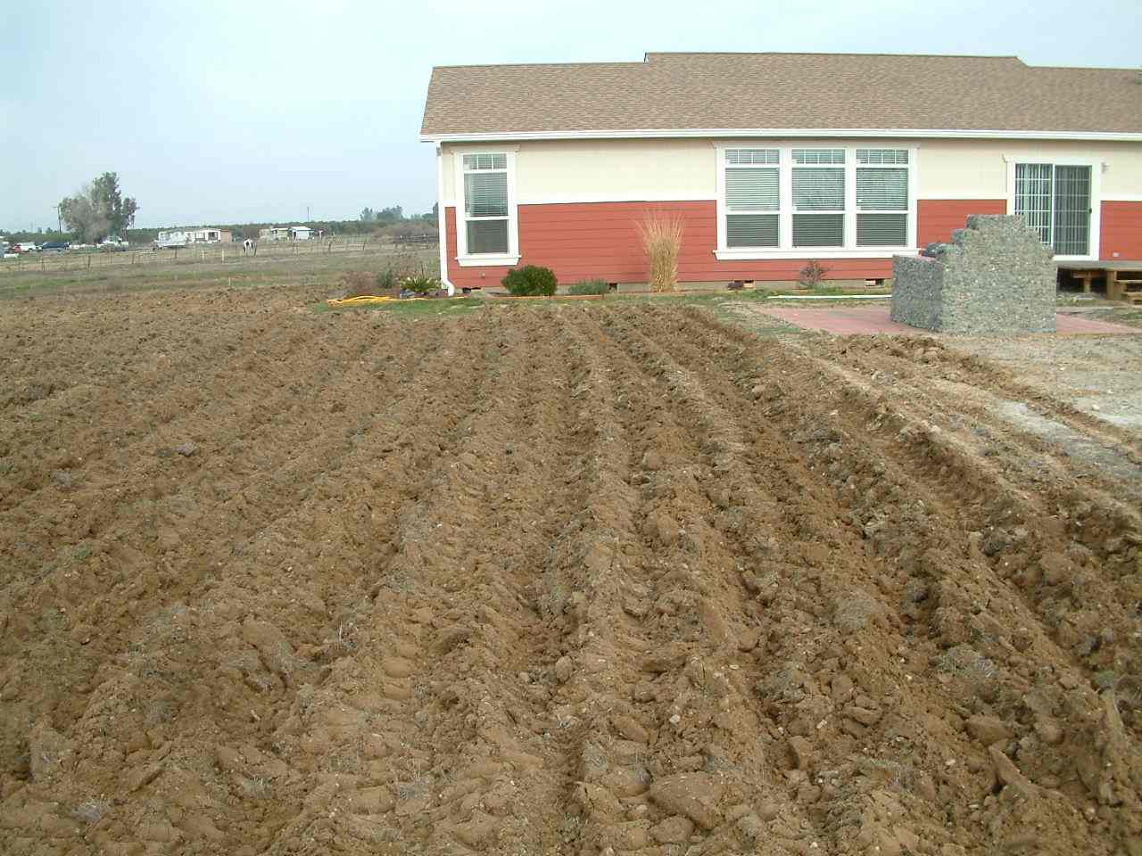

My advice is plow deep and get for sure under them and start well back from the start of the row.
On mine I had the top of the plow about even with the ground and I went about as fast as I can walk.
I did a test run at my buddy's place on bare dirt outside his garden so I could get the depth right after that I knew where it was on mine.
And btw you will cut a few up its unavoidable we keep them aside and eat them first.

C'mon, you guys. It is now upside down. also, the point doesn't seemto extend below the body. Turn the blade around, angle it w/the point slightly below the wings and use downpressure to get it started. If your ground is hard, you may want to use the chisel point. I believe you can buy it separately. My Cat. 0 came with both types. The blade you have is also called a "potato plow", which indicates to me you need softer ground.
I have barely used mine, I have it on a Cat. 1 (Yanmar) so had to bush the pins. It is still pretty sturdy, though.
