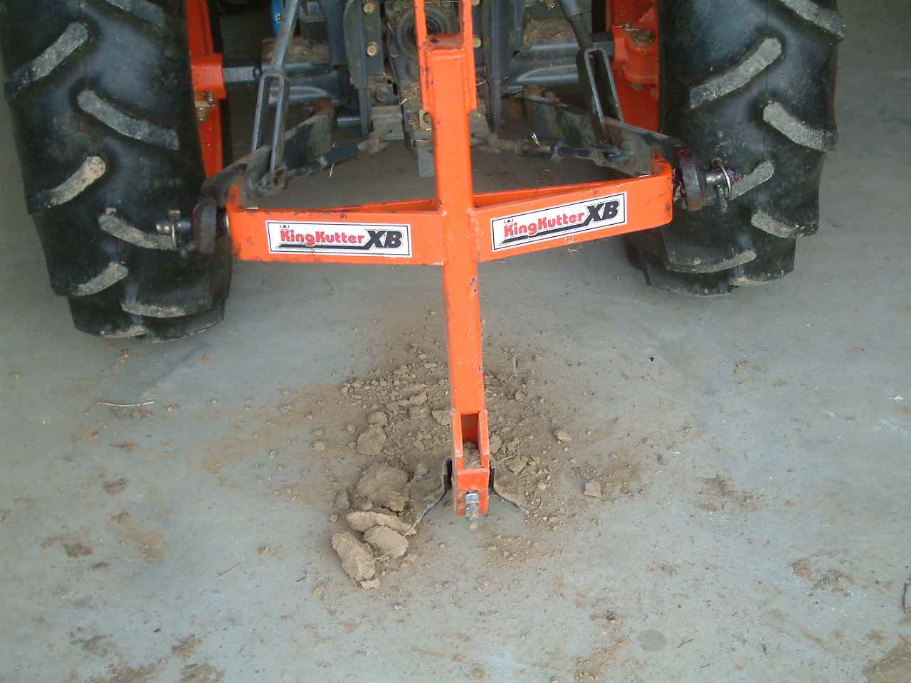

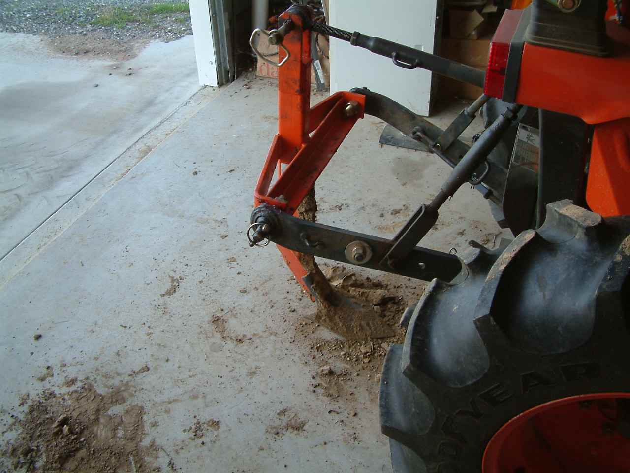

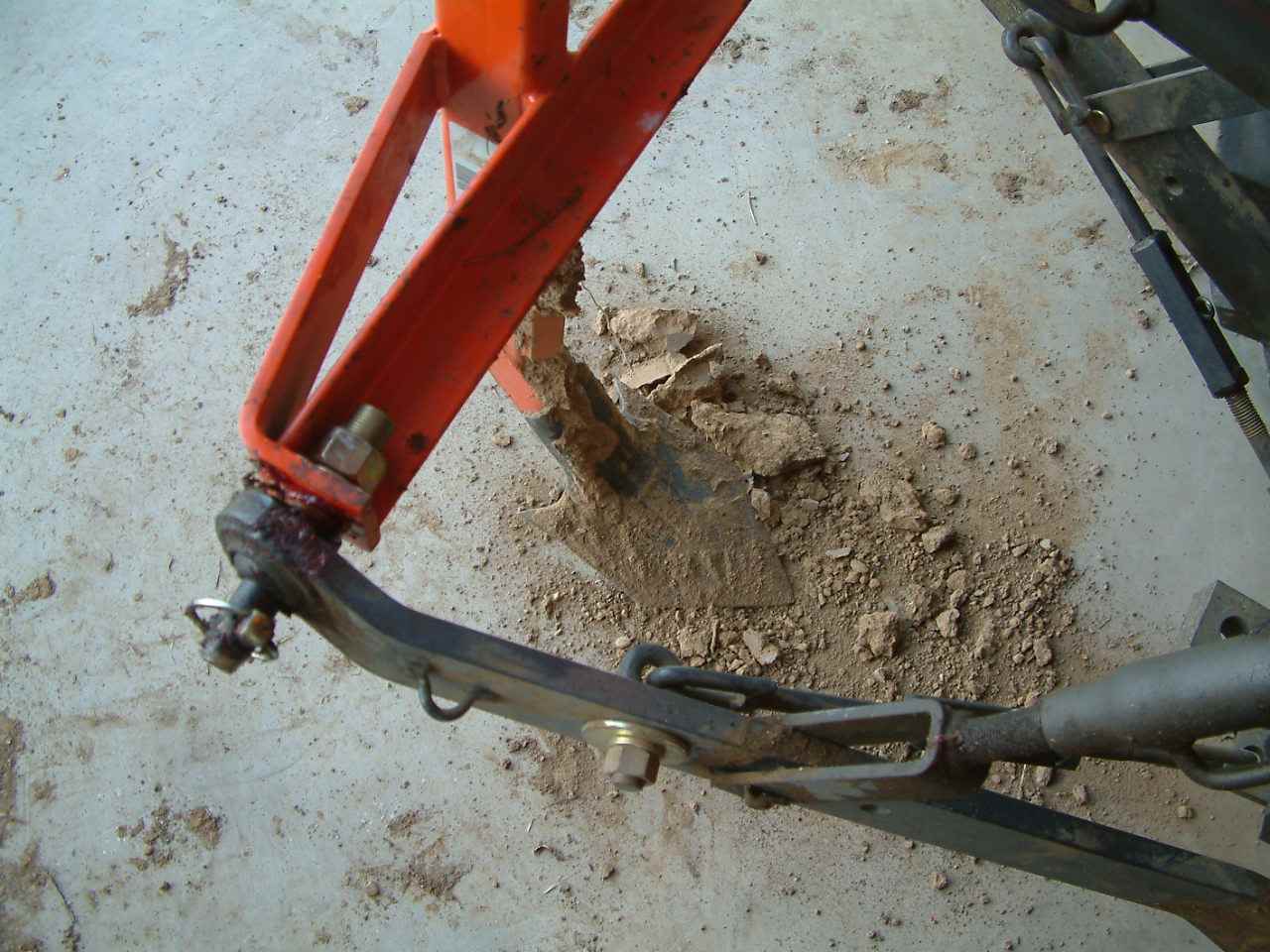

That JD2440 has enough hp to bury a MB 12 inches and pull a trench. I used my little 2005 Kubota B7510HST (21 hp engine, 17 hp pto, 4WD, hydrostatic tranny) and a King Kutter MB from Tractor Supply to plow the areas around my new house for landscaping to about 8" depth in fairly soft soil.
Just be sure to get a stout MB--that little KK MB I used would probably get bent quickly trying to dig to 12 inches. You may have to get out your welder and reinforce your MB with some steel bar.
