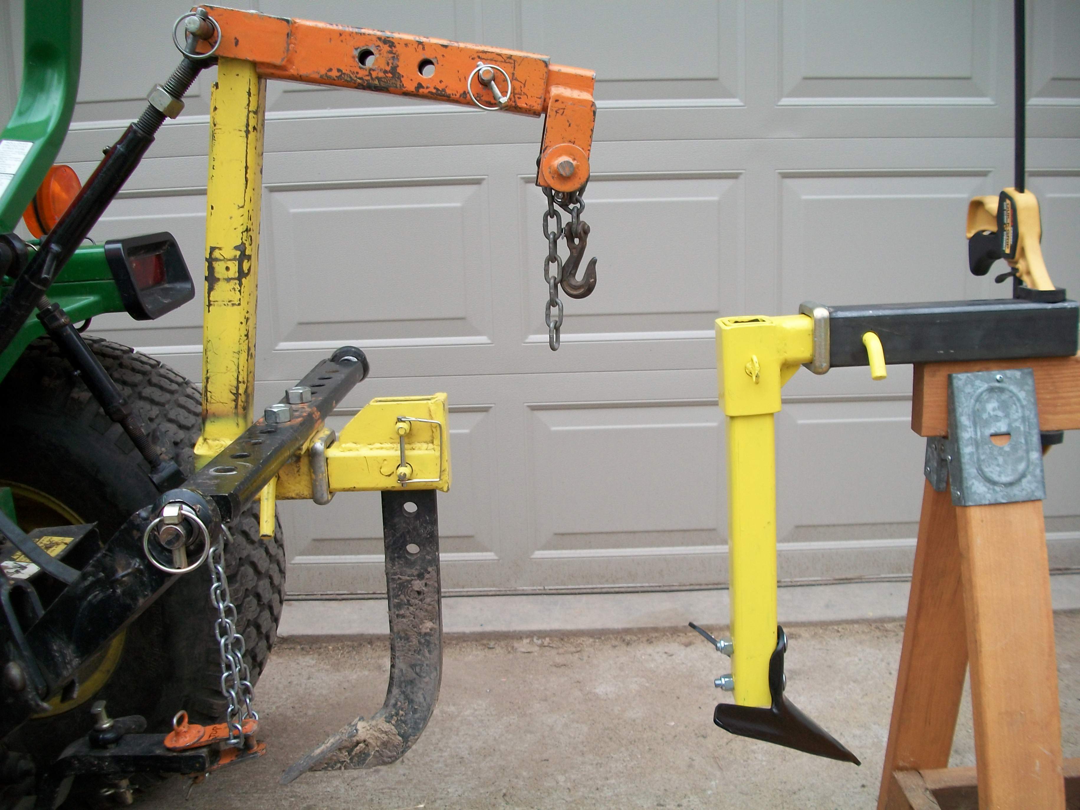

I have had acceptable luck with these two home made tools.
First using the sub soil tool then the other after that.
Posting a picture may be the hardest part of the job.
Good luck

Good work on those. I should have made something, I have enough going on right now without engineering some equipment. I tend to over-build and over-think everything, and by the time I'm done I end up with a heavy tool that took all day to build but you probably couldn't break if you had to. I built a carry-all thing last winter, it works great except the tractor is half loaded just hooking to the empty box. I use it on the big tractor now. I'd hate to see it if I'd actually designed it for the big one.

We call that one on the left a "ripper tooth" in my neck of the woods...err prairie. ;)

I would definately run the subsoiler point several times loosening the soil over a 12" width before sinking the middle buster down.
