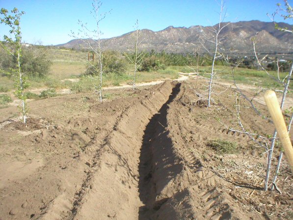

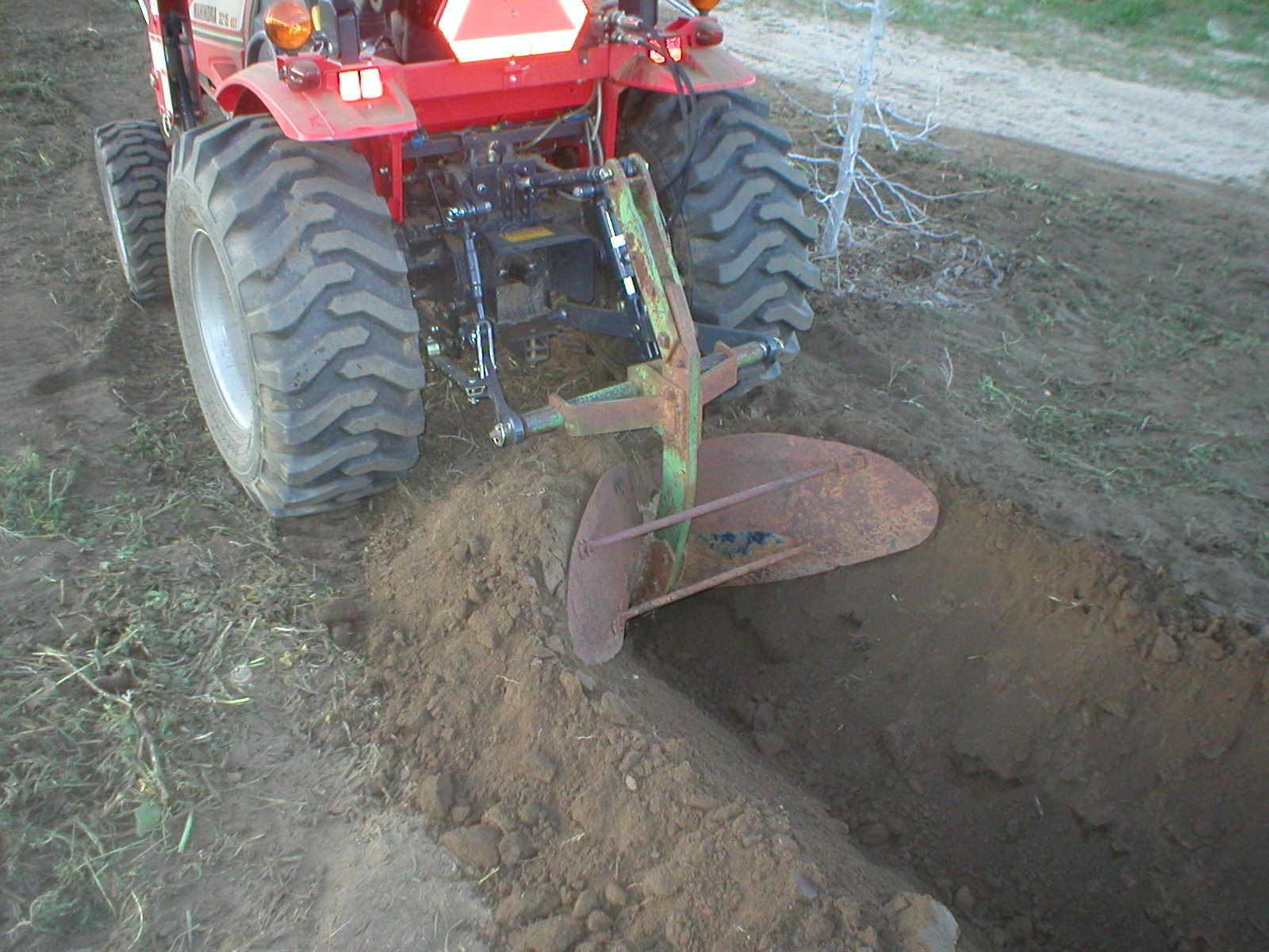

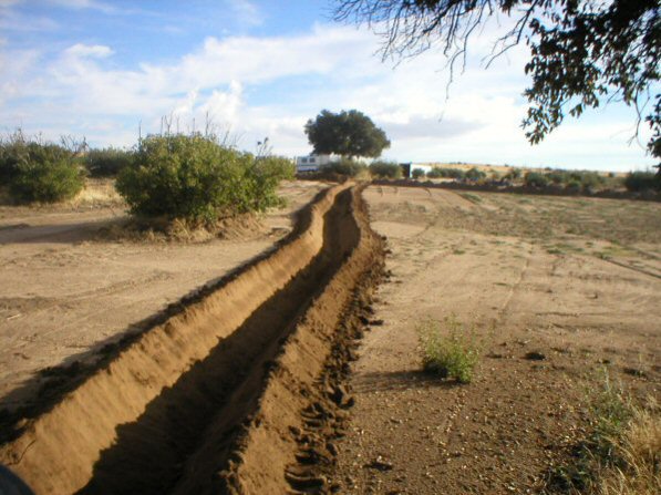

Just to show some of you what can be done IF the soil is right. One pass 10" wide x 18"-20" deep. :thumbsup: The middle picture is about 300 feet in length and took less than 5 minutes. :cool: When it takes longer to install the PVC pipe than it does to dig and backfill the trench, something IS WORKING RIGHT. :cool2:
