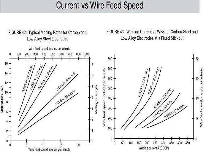

Do wire feed MIG welders increase amperage by having more 'connection' as the wire speed increases? I just ordered one, and I'm trying to get the picture of how they 'know' to increase the amperage..:confused2:

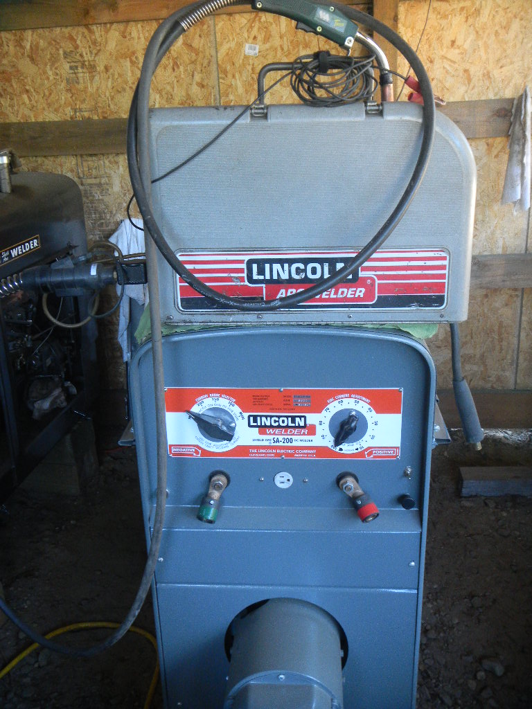

OK, now that you have a handle on wire speed / amps, and volts, next you'll want to learn how to set a wire feeder up on an old school engine drive like in my avatar. :D
Yeah, right now I'm thinking I should have just bought a wire feeder and hooked it up to my tombstone.. Oh well, I love new toys anyway..:)
/ MIG amperage #10
I don't know anything about tombstones, but you have to be real careful with a lot of CC power sources, sometimes they put out too many OCV for some wire feeds to operate properly. Some of Lincoln's old wire feeds would only accept 49-OCV, the minimum result would be no wire feed until you struck and arc.

from another site: Welding machines are usually classified as constant current (CC) or constant voltage (CV); a constant current machine varies its output voltage to maintain a steady current while a constant voltage machine will fluctuate its output current to maintain a set voltage. Shielded metal arc welding will use a constant current source and gas metal arc welding and flux-cored arc welding typically use constant voltage sources but constant current is also possible with a voltage sensing wire feeder.
The nature of the CV machine is required by gas metal arc welding and flux-cored arc welding because the welder is not able to control the arc length manually. If a welder attempted to use a CV machine to weld with shielded metal arc welding the small fluctuations in the arc distance would cause wide fluctuations in the machine's output. With a CC machine the welder can count on a fixed number of amps reaching the material to be welded regardless of the arc distance but too much distance will cause poor welding.

I found this.

Mig process is typically a Constant voltage process. The taps (detents) are preset voltage levels. Some welders have a lot more taps, with ranges to provide more selections. Other welders such as inverters allow you to change the Voltage infinitely. Once set, the voltage is held constant while welding (theoretically).
Wire speed and amps are directly linked. Increasing wire speed automatically delivers more amps. Some mig welders have an scale for amps...Others for wire speed, but they do the same thing. The faster the wire feeds, the higher the amps go.

Perhaps this will help. Admittedly I'm shooting out my butt on this, but it follows basic electrical theory...sort of... I know I'm going to get flayed for this, but I'll try to make some sort of layman sense out of it. No I'm not an EE, but I stayed at a Holiday Inn Express last night :)
1. It's a CV source, so it tries to maintain the voltage at the setting.
2. Every time you short the wire to the work as it feeds out, the voltage wants to drop as there is less resistance when it shorts than when it is holding an arc across a gap.
3. Since it tries to keep the voltage constant, it will boost the power to keep V constant.
4. Since V is held constant, A must increase and the wire melts back a bit.
5. The faster the wire moves, the more often this must happen, thus the higher amp draw on average.
Anyone agree with me? Maybe I got that wrong, but on a Fri night, it sounds good:D
That doesn't work with this combination! Turn the wire speed up with this setup, and the wire will bang into the puddle! ;):D
