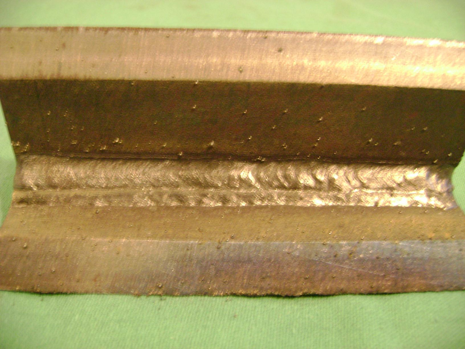

I have literally run tons of Hobart's 21-B. It is amazing how much ductility that wire has. When it comes to gas less flux core it is my first choice! Second choice would be Lincoln's NR-212.
